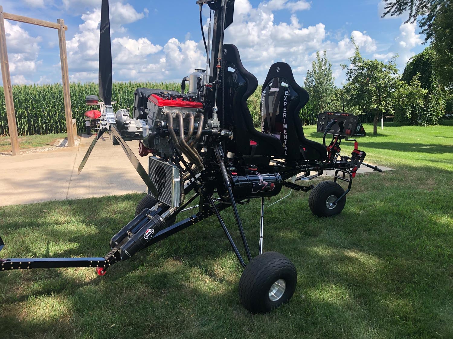

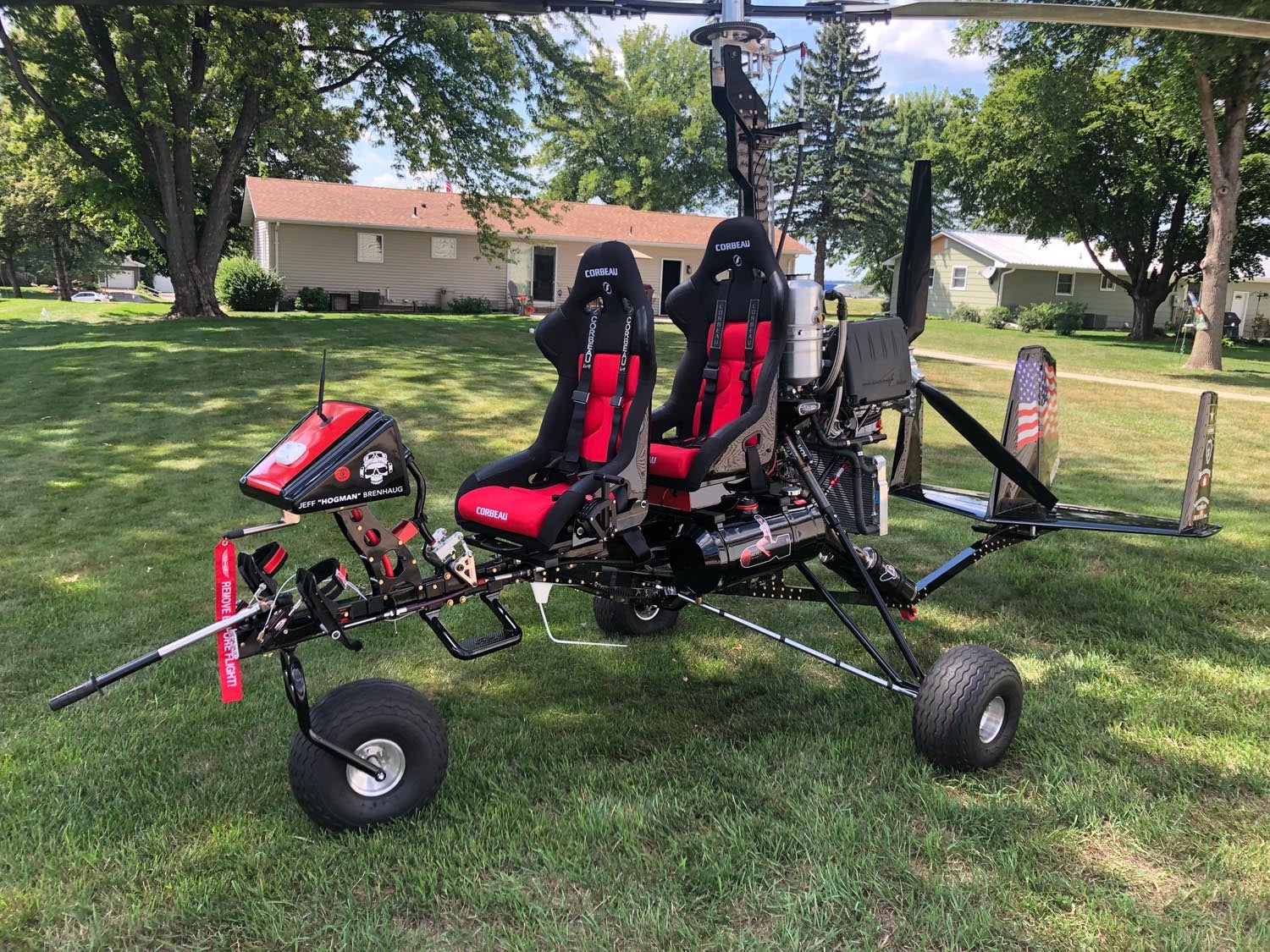

Irene the Gyro 03“Irene the Gyro” was a design I put together while sitting on fire standby in Greece during an unusually wet season so I had time on my hands: I fly firefighting helicopters for a living.
Irene the Gyro 01
DAR Steven Wagner and Jeff Brenhaug.

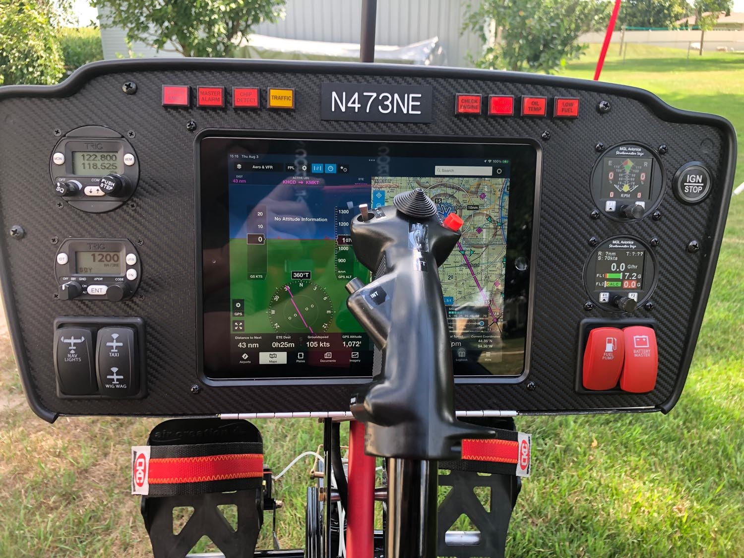

It is a completely self-designed 2-place, single front seat controls using traditional dimensional rules for gyroplanes. The engine is a Yamaha RX-1 with 142hp utilizing a Jenkins adapter to the Rotax E-box spinning a Powerfin prop. Tango Gyro supplied the tail surfaces, the rotor hub was sourced from Gyro-Tech of Poland with carbon composite blades from Rotor-Tech also from Poland. It has full instrumentation including ADS-B in/out and lighting for night VFR. My partner during this whole adventure is Jim “Thumper” Lauer and between us we have storied careers in the US Army.
