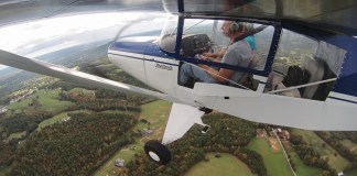

Next on the list is to spend some time looking at the airplane itself. At KITPLANES® we have a blanket policy to wait until all of the Phase I flight-testing has been completed before we conduct a flight test. For starters, that’s the best legal angle because, technically, the airplane isn’t supposed to carry passengers until Phase I is complete. You are also not being compensated as a test pilot, so it pays to politely ask the status of the aircraft’s test flying and absolutely determine how many hours it has flown.
Before you fly, there are important questions worth asking: How does the demo aircraft differ from the final kit? What factors might influence the difference in performance between the demo plane and stated performance? Typically, kit companies derive their brochure numbers from the factory demo airplane, so the airplane you fly should be able to duplicate these performance figures. If it can’t, you need to know why. Either something has changed—it’s common for small companies to try different cowlings, landing-gear configurations, propellers and even whole engines on one airframe—or the numbers are suspect.
In addition, it’s critically important to have at least a basic plan. This could be as simple as taking off, climbing to altitude in the general direction of the local “practice area,” performing a few basic maneuvers, doing speed checks, and then descending back to the airport for landings. Indeed, this outline generally describes most of our review flights. (It explains our enthusiasm for actually getting to go places in test aircraft!) Remember, though, that the job here is not to learn what the airplane is like to live with but to verify a few performance points, make a top-line evaluation of handling qualities, and see if the airplane is comfortable to sit in and fly.
