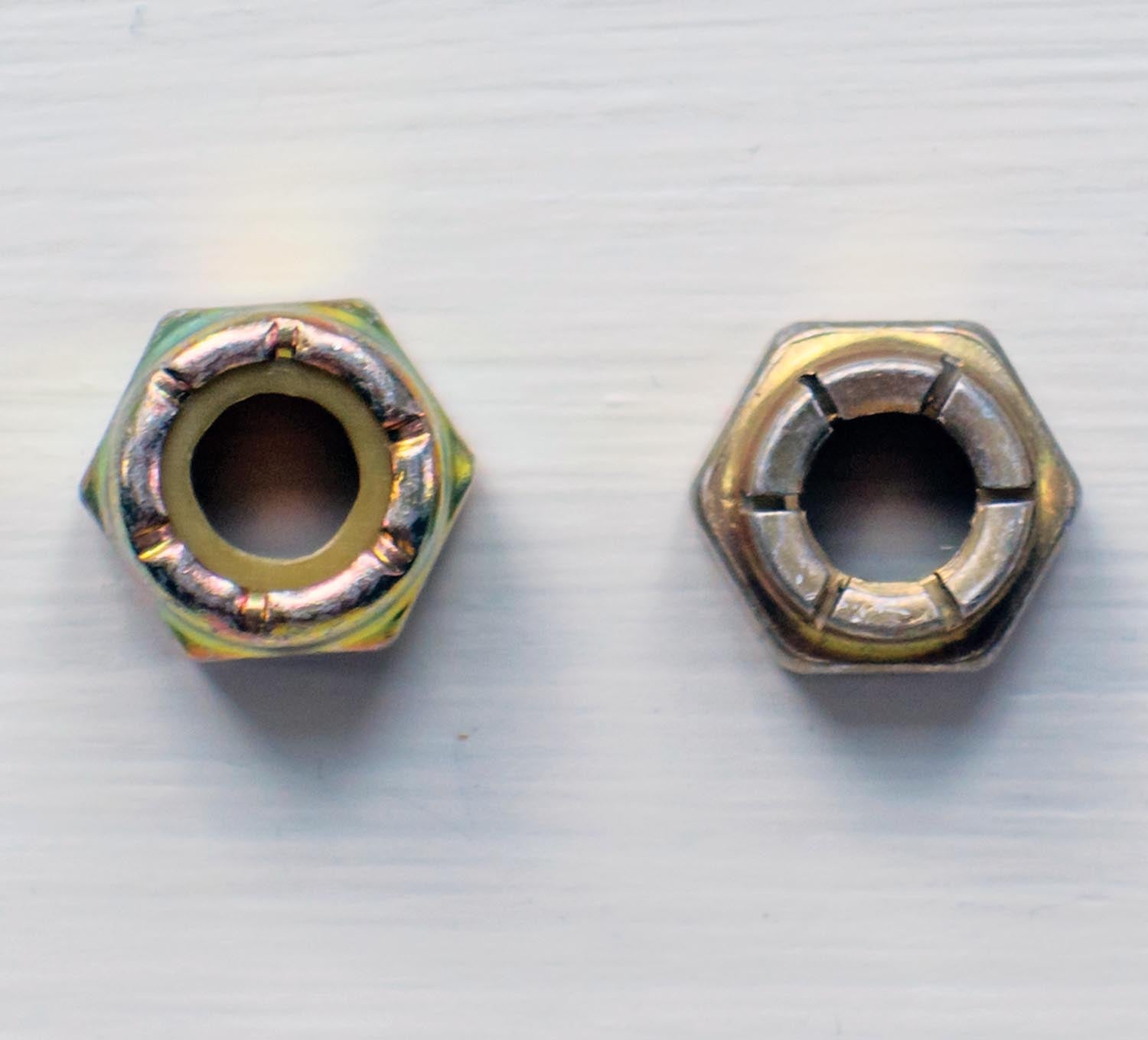

Self-Locking Nuts
I’m going to say very little about the actual nuts. The two most common self-locking nuts are elastic stop nuts and all-metal stop nuts. The elastic stop nut is the primary style used in many airframes. The all-metal stop nut is most commonly found where temperatures exceed 250° F. Both styles share the characteristic of having a high-friction grip on the fastener. However, they lose some of their grip each time they are used. It is generally accepted that a lock nut can be reused once. If you work on an airplane someone else built, you won’t know if the nuts you remove have already been reused. Always reach for a new one. When putting something together temporarily, use a used nut for the initial assembly and replace it with new for the final assembly. There’s no point in compromising a new nut for a temporary need.

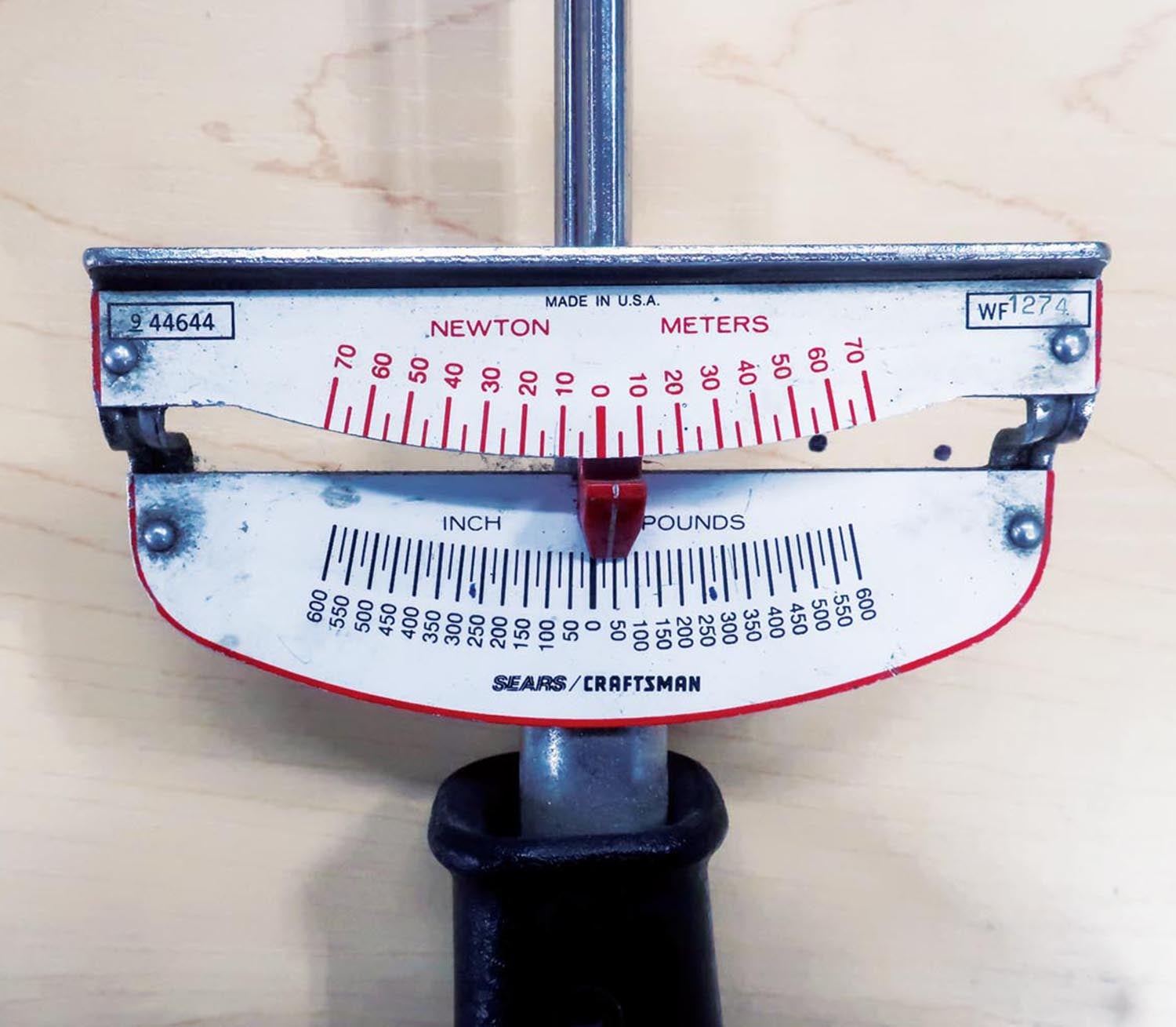

Beam Torque wrench scale BT FORES
This one reads nearly 40 inch-pounds sitting on the bench. Clearly it needs calibration.
If you use a torque wrench, there is more to it than waiting for the break-away “click” or watching the pointer on a beam-type torque wrench. To begin, torque wrenches must be calibrated at least once a year and after they stand in for a hammer. There is no point in torquing to a very specific value if you aren’t actually achieving that value. You must also make sure the proper value is set. Torque tables reference a bolt’s diameter, not the size of the socket used to tighten the nut. Don’t confuse inch-pounds with foot-pounds. There are different values for fine- and coarse-thread fasteners. Unless the torque wrench is acting directly on the socket—say you’re using a crow-foot adapter or a handle extension—the torque value setting goes out the window and algebra must be deployed to compensate for the change in the tool’s effective length. The torque wrench must be pulled or pushed smoothly until the final torque value is reached; jerking the tool can over-torque the bolt. The threads of the bolt and nut must be clean and dry. Lubricants, sealants or locking agents will reduce friction, resulting in an improper final torque value. Finally, and worthy of its own paragraph, there is the impact friction drag plays on torquing self-locking nuts.
Two types of Lock nuts BT FORES
Elastic stop nuts use a nylon insert to add friction (left); all-metal stop nuts utilize an altered thread design that firmly grips the threads of a bolt (right).
Unlike common nuts, which can be spun onto a threaded fastener by hand, self-locking nuts have a high degree of friction drag when their locking mechanism contacts the threads of the bolt. That drag must be measured and added to a bolt’s specified torque value. For example, if a bolt has a torque value of 50 inch-pounds and the nut has 10 inch-pounds of friction drag, the final torque value must be 60 inch-pounds. The first 10 inch-pounds of effort are serving only to turn the nut on the bolt. If friction drag isn’t added to the final torque value, every bolt will be under-torqued. One last wrinkle: A used self-locking nut will have less drag than a new one. So there’s that.

  2. Your zero at 40 in-lbs torque wrench can be adjusted to read correctly. Place the socket boss in vice protected by aluminum angles on each jaw so it is held rigidly. Toing the needle by hand a couple times to see where it lands and if it is consistent, as a baseline. Then ‘over bend’ the needle arm gently, considering spring back, until it consistently lands on zero; The primary arm cross section is actually what bends in torque, while the needle arm remains ‘fixed’ to the fastener.
