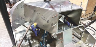

Subsequent testing revealed the cooling system to be inadequate. I bought Paul Lamar’s book, How to Cool Your Wankel, and studied it carefully. Essentially, my radiator had to double in size, and sure enough, the engine temperatures stabilized. What a delight to watch the temperatures rise with increasing power, then cool again as the power is reduced. I fixed several leaks, adjusted ignition circuits, fuel flows, and generally tinkered until satisfied that the whole thing looked workable. In the end, I’ve spent enough to buy an O-200 anyway, but I’ve had a lot more fun and learned a great deal more than simply bolting on another engine.
Of course, the engine won’t fit under the old cowling, so I have to make a new one—but that’s the subject of another article.
