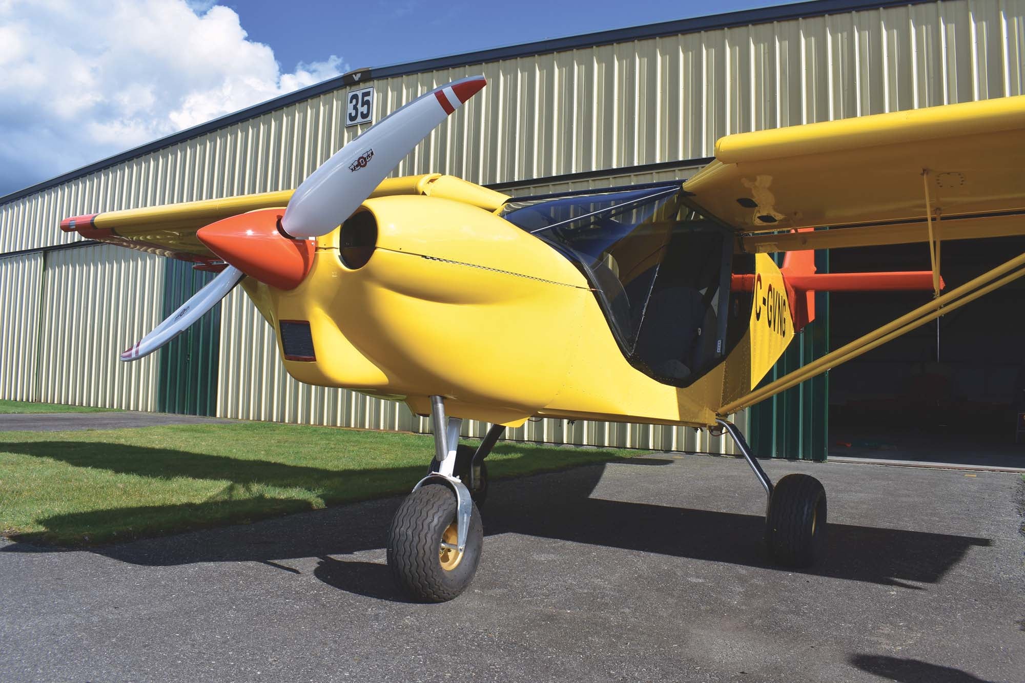

Cover ShotLangley Regional Airport (CYNJ), located in the lower mainland of British Columbia, is no stranger to homebuilt aircraft. Over the years these have ranged from wood to fabric to composite and metal. This is the story of one all-metal project and its first-time builder. A career in law enforcement did little to prepare Greg Booker for the demands of aircraft construction except for the ability to stay with a project until complete.
