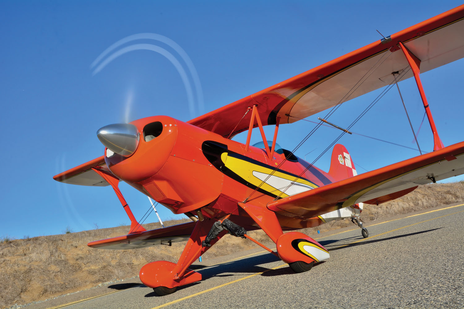

All said, what is a reasonable rule for warming up? Not to cop out, but it depends. I routinely operate an O-200 Continental and a hopped-up IO-540. The little Continental is stone stock with an anemic 7.0:1 compression ratio, and during the summer it gets no more warm-up than however long it takes to drag it to the runway, which is about four minutes given the usual run-up. We typically keep the mixture full rich (sometimes we lean it on the ground, not that it seems to make any difference), the rpm stays a bit above idle and just four quarts of 20W-50 in this engine is plenty as it blows any extra out the breather. In winter an extra minute or two apparently does the trick. Generally speaking this engine, which has been around the patch more than a few times—what O-200 hasn’t by now—has the usual slobbery demeanor about the intake system and the also typical lead-fouled, somewhat oily spark plugs at annual time. That’s not to say it isn’t well cared for or the carburetor is not in correct tune, which it is, but rather that it’s an old-school, low-performance, low-stressed engine with pretty ample mass considering its so-so power output.
The 10:1 compression 540-EXP gets a whole nother level of preflight care. Our Southern California base means “cold” weather is possibly in the high 30s during the night and it’s always at least in the low 40s during early-morning engine starts. Even with just 10 quarts of 20W-50 in the sump I’ve found that manually pulling the engine through six blades helps the high-speed starter get the first blade through that first, tough compression stroke when the weather is that cool. It wants full-rich mixture for the first 90 seconds or so, then I begin leaning by ear to achieve the smoothest possible 1000-rpm idle. The elevated rpm provides splash oiling to the cam, lifters and cylinder walls while the leaning reduces lead deposits and general goo accumulation as the EGTs aren’t high enough to scavenge the lead.
Like the O-200, the 540 is taxied to a run-up area some distance from the runway at our unusual, hilltop runway for a CIGAR minus the R check, still with a 1000-rpm idle and increased leaning as the engine warms up. A six-channel engine monitor allows watching the CHTs climb but it’s mainly the oil temperature that gets the eagle eye. Once the needle comes off the 100° F lower peg I’ll taxi to the runway, go full rich on the mixture and give it a 1700-rpm run-up. Then it’s leaned again until takeoff. Believe me, you won’t get very far on takeoff with the mixture leaned.
In winter it can take as much as 12 minutes of ground operation to get the engine ready for takeoff. That’s a long time, especially when half of that is just making noise and you’re sitting outside behind that big fan in an open cockpit. In spring and fall the wait is more like 7 minutes and in summer it’s nice that she’s ready to go just as soon as I can reasonably get to the runway. But consider that unlike the O-200, which goes to what, 7 gph at takeoff and is seemingly designed to live at 80% power because there isn’t much of that, the 540 wraps the analog fuel-flow needle off the scale at takeoff (the dyno put it at 29 gph) as it churns out over 300 hp. There’s a whole lot of heat coming on strong at takeoff and the engine only has 400 pounds of mass to absorb it. In short, it’s strong enough to hurt itself and needs to run in a narrower temperature range to keep the clearances and lubrication in their happy spots. That’s why it can boil those 10 quarts of oil just a few minutes after takeoff if you don’t either pull off some power or pay attention to air through the cowling.
The 540 is a big ’ol loose airplane engine so it shows just a little blue stain slobber in the inlet tract during inspections, but the spark plugs come out clean with rarely a lead clinker to pick out thanks to the lean running (it runs full rich only at takeoff). Unlike the O-200, which is apparently incapable of feeling pain unless asked to climb above 5000 feet, the 540 takes some attention in flight, mainly getting it to 18 gph at high-power cruise or under 12 gph running lean of peak at mumbling power outputs lest it sneak a fuel siphon into your wallet.
