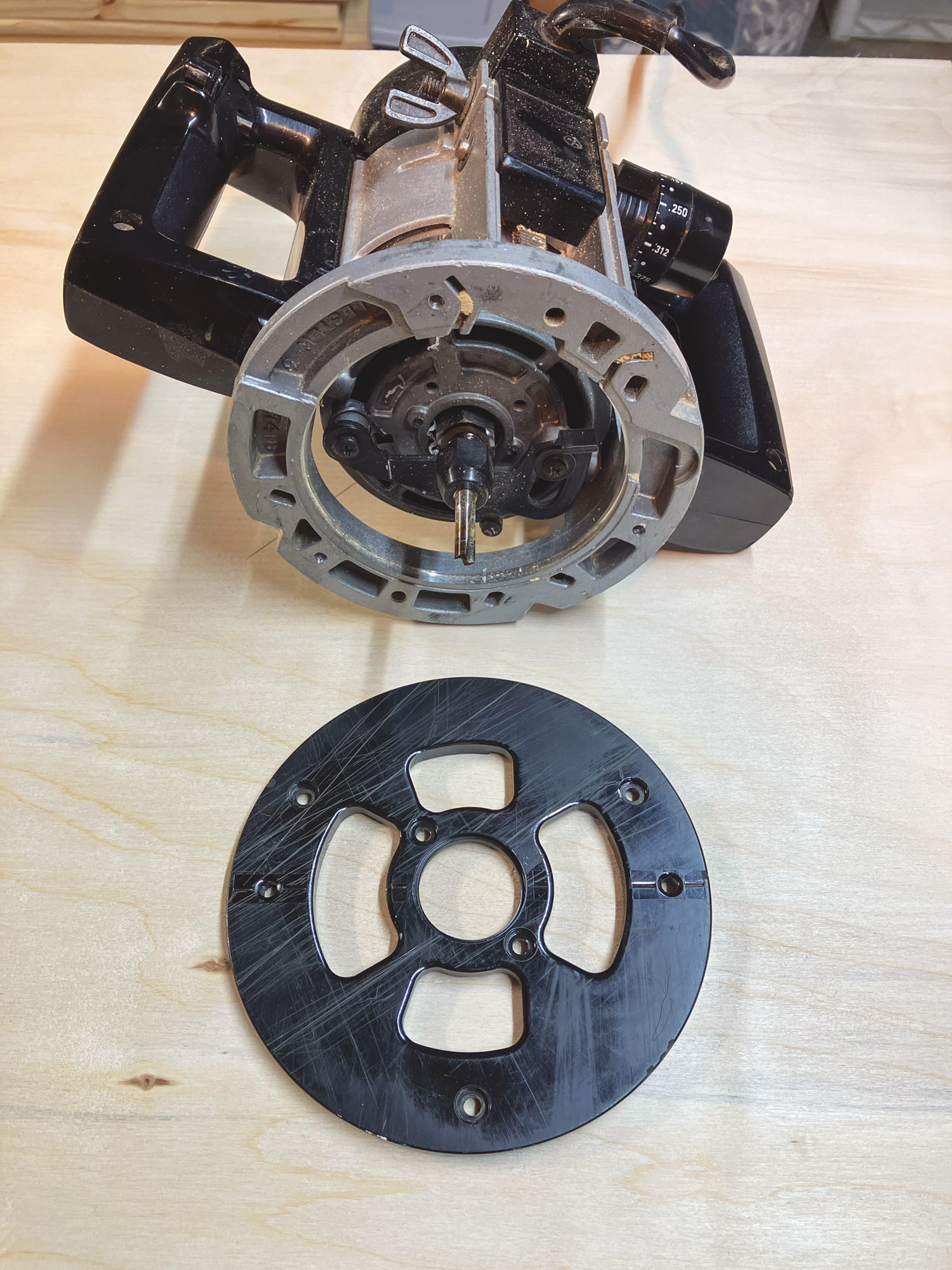

Remove the router’s baseplate and use it as a template to transfer the mounting screw and router bit holes to the (approximate) center of the board.

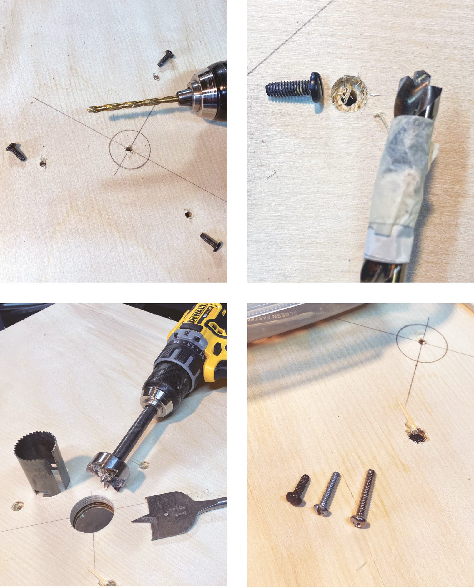

The holes for the router mounting screws should be somewhat larger than the screws (top left). That provides wiggle room when attaching the router but won’t compromise it staying in place once fastened. The screw holes need to be countersunk (top right). I used a countersinking bit I had, but a larger, standard drill bit will work as well. Tape on the bit helps you regulate the cutting depth of the countersink. Drill the router bit hole to approximately the same diameter as the one in the base plate (above left). Any number of hole saw types work; the spade bit, however, would be my last choice. Longer screws are needed to attach the router to the table (above right). I found what I needed in my 40-year collection of stray hardware.

  2. Remove the bottom plate of the router.
  3. Center(ish) the router plate over the X.
  4. Transfer the position of the screw holes onto the board and trace the hole for the router bit.
  5. Drill the router bit hole to approximately the same size as the hole in the router base.
  6. Drill the screw holes slightly larger in diameter than the screws they will accommodate.
  7. Countersink the screw holes to accommodate the screw heads.
  8. Sand the board smooth where the wood has likely chipped and splintered while being drilled.

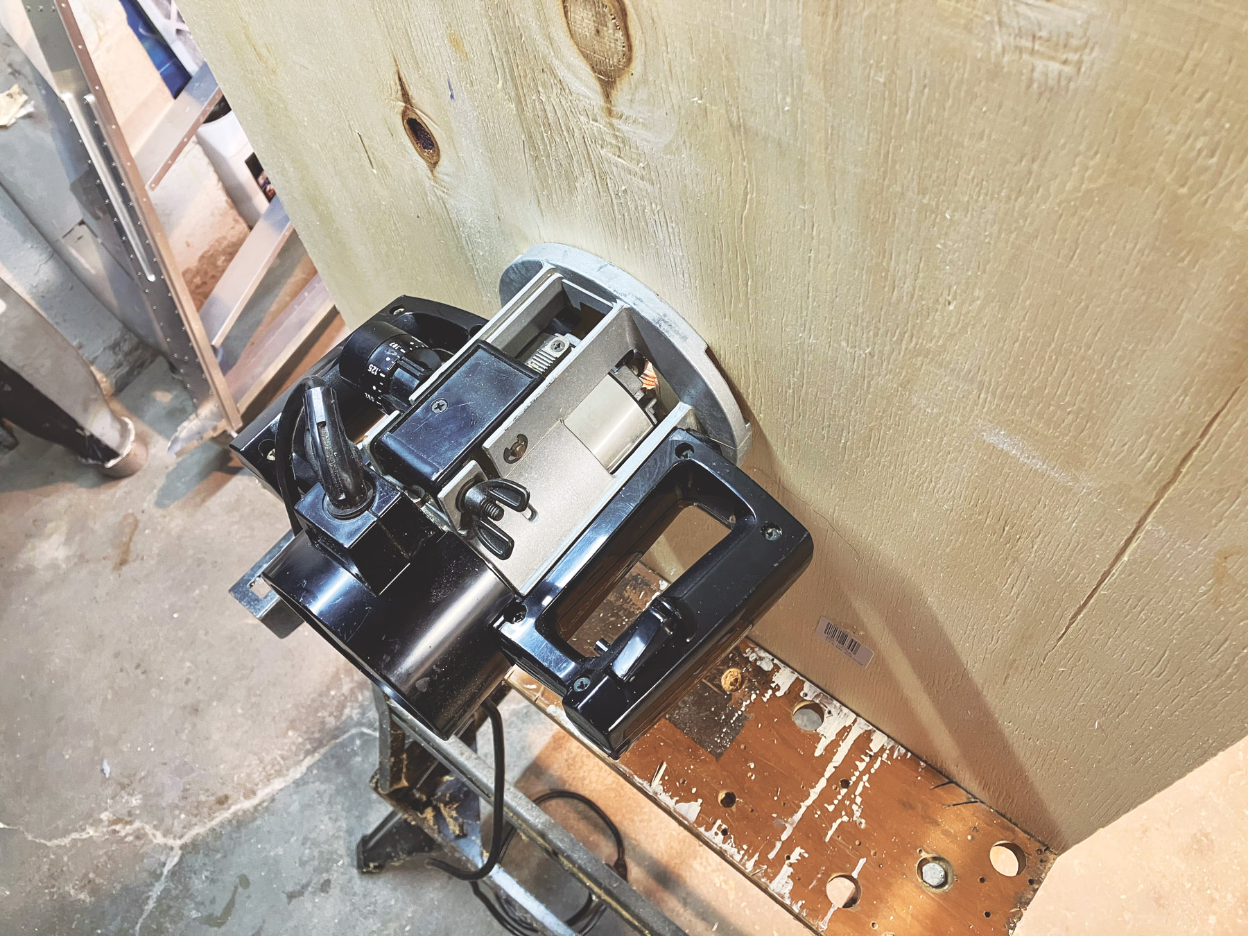

With the board clamped vertically in my Workmate, I attached the router to the board. The luxury of a second person to hold the weight of the router would speed this step.
Attaching the Router
To attach the router to the tabletop you’ll need screws longer than those that held the baseplate to the router. If you have a catch-all bin of spare hardware, pan it for usable screws. Otherwise, take an original screw to a hardware store to find longer replacements with the same thread. It’s times like this I like hardware stores that sell onesies and twosies. I’d rather buy a few screws in various lengths than 100 screws of the same length.
Attaching the router is the hardest part of the project simply because you must line up three tiny screws and get them started without stripping the holes in the router. I do that by getting each screw started before tightening any of them.

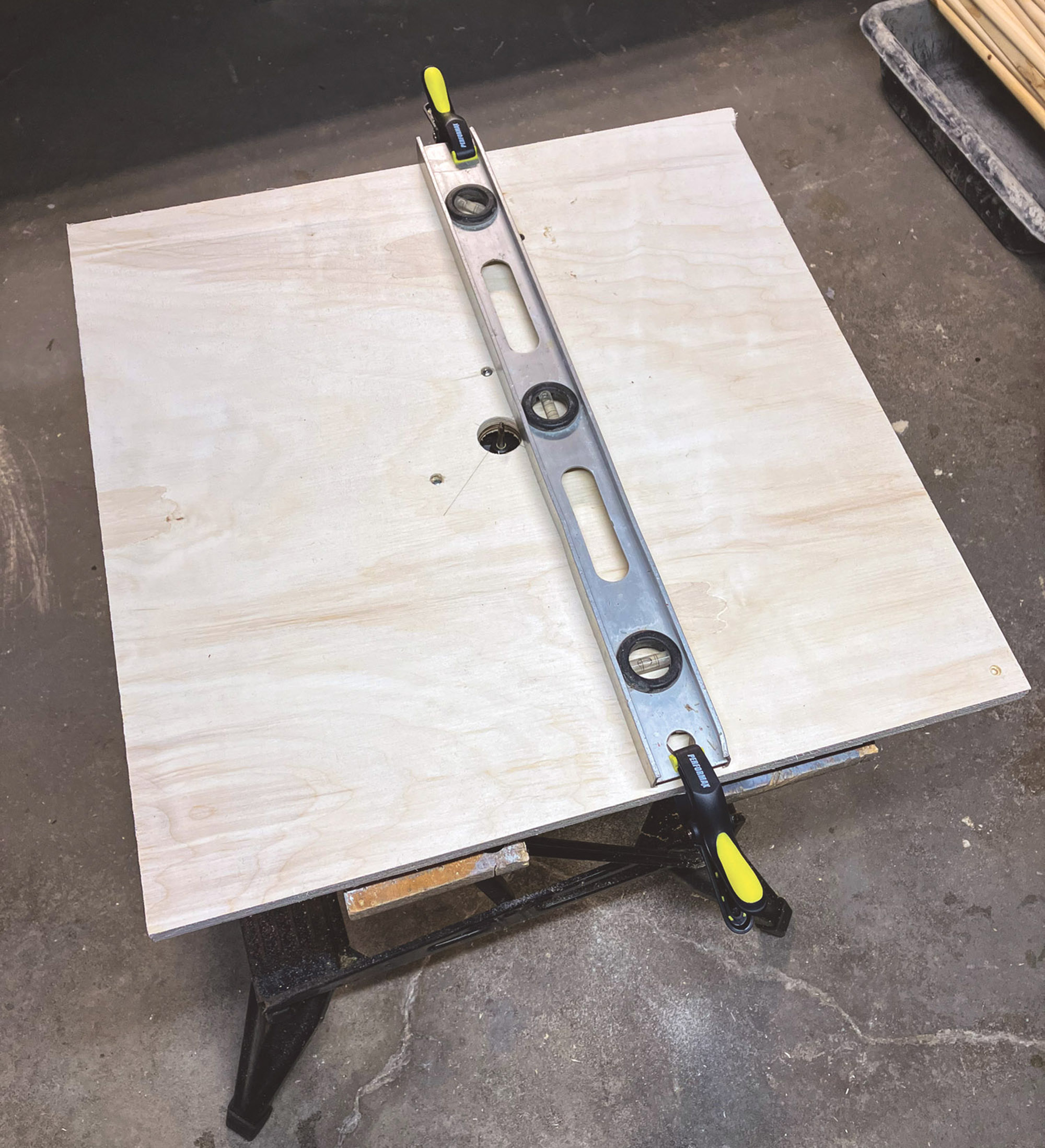

The completed router table with a carpenter’s level for a fence (right). I had small C-clamps in mind to hold the fence, but I found spring clamps with incredible holding power, which makes setting the fence a breeze.
Putting It To Use
As I’ve mentioned, I support my router table with a Workmate. One could also secure the board between a pair of sawhorses with drywall or deck screws. If you have a solid-wood workbench you can screw the router table to the benchtop, but keep the mass of the router against the edge of the tabletop to prevent gravity from claiming the day. The last bit you’ll need is a fence to guide the material. I use a level, as they are straight and tall, but not too tall. Two clamps hold it securely in place. Positioning the fence for each cut is a breeze: Set the fence in relation to the router bit without concern for squaring the fence to the edges of the board.
