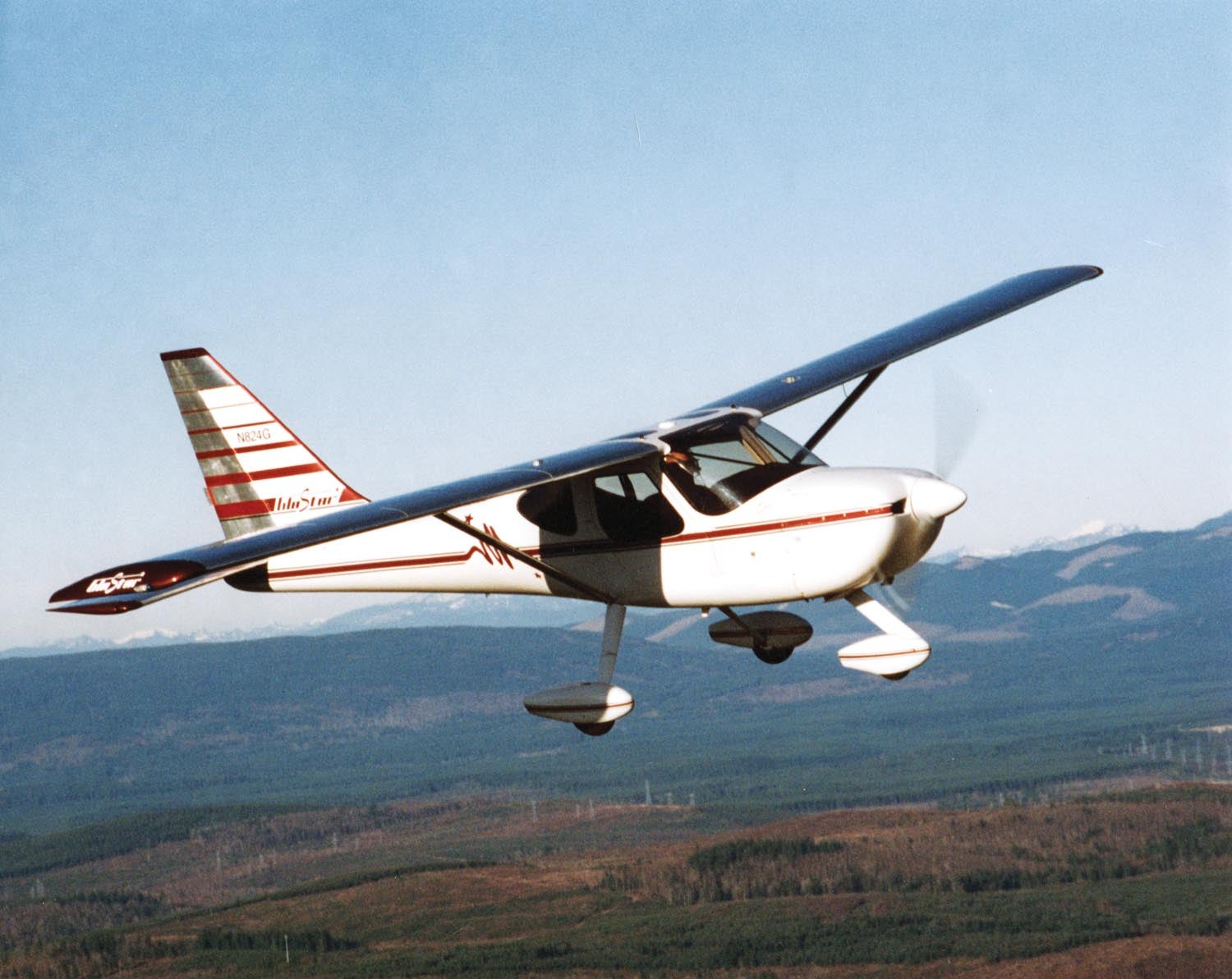

Glastar air to air
The GlaStar Sportsman line saw about 60 accidents from 1998 through 2017, of which only seven were fatal.

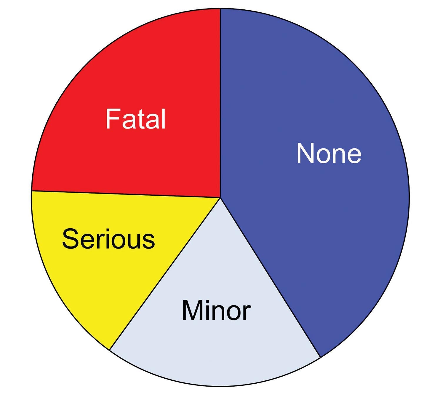

Injury severity for E/A-B accidents 1998-2017.
But accidents resulting in death are nearly impossible to hide. They receive the highest attention from investigating agencies. This is good, as they are the cases where the builder or pilot made the worst kind of mistakes. By learning what is more likely to kill us, we have a better chance of avoiding a serious accident ourselves.
Injury Severity
We can find the fatal accidents through the “Injury Severity” entry in the NTSB records. Searchers using their web page can select only “Fatal” and “Non-Fatal,” but the downloadable database actually has four injury categories: Fatal, Serious, Minor, and None.
“Fatal” is unambiguous. But to be considered as related to a given accident, the NTSB requires that the death occur within 30 days. Injuries are rated as “Serious” if they require hospitalization for more than 48 hours, involve broken bones (other than simple fractures of fingers, toes, or nose), severe bleeding, and/or 2nd or 3rd degree burns over more than 5% of the body surface.
The NTSB doesn’t define “Minor” Injuries, but one can assume that it’s a level less than “Serious” but still not “None.”
For the analysis to come, we’ll combine the “None” and “Minor” categories.

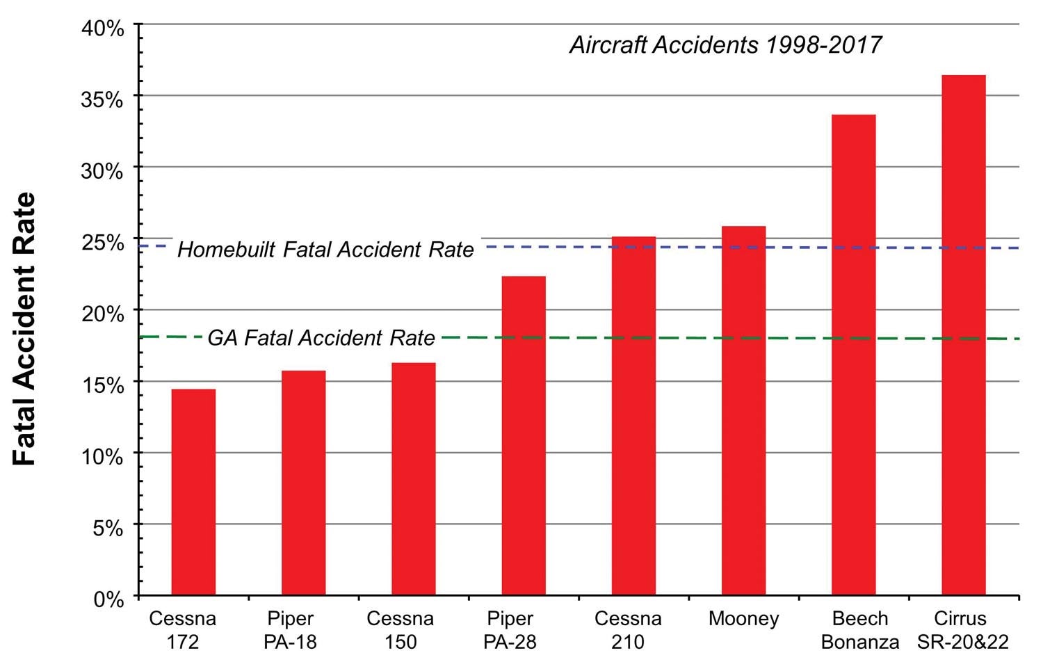

As mentioned earlier, about a quarter of homebuilt accidents result in fatalities. Figure 3 plots the “Fatal Accident Rate” (the percentage of accidents that produce fatalities) per year from 1998 through 2017. Overall, for that 20-year period, the average is 24.3%.
The overall GA rate is about 18%, so homebuilts are a bit worse. Figure 4 compares the E/A-B fatal accident rate against that of several types of common production GA aircraft.fatal factors slide4
What drives whether an accident results in a fatality?

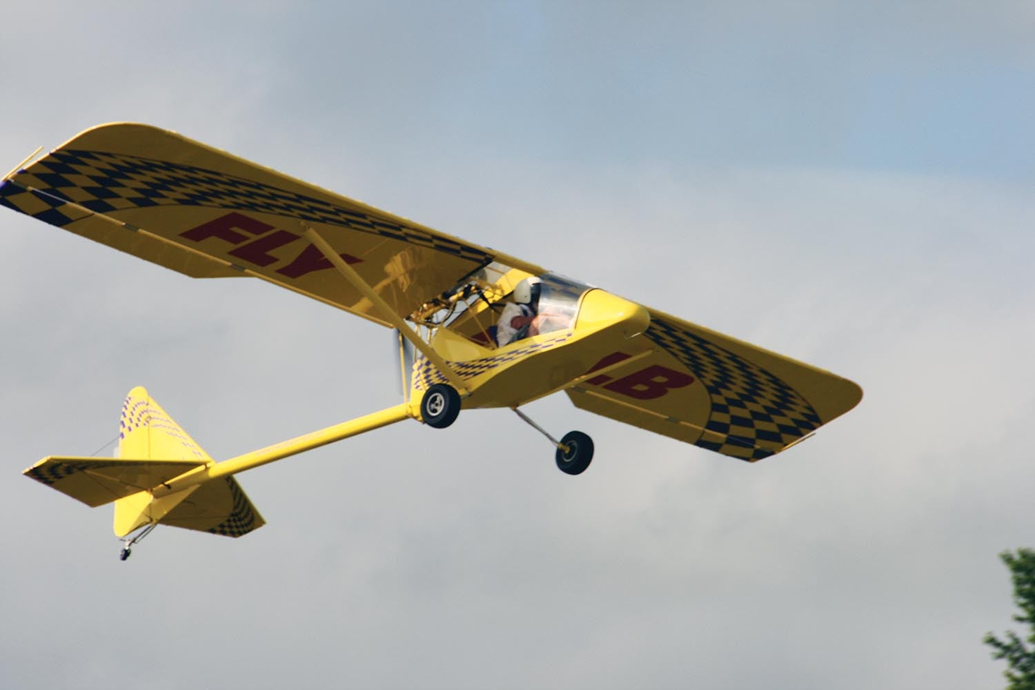

Speaking of protection, the figure shows three “ultralight type pushers” at the low end of the speed range with an elevated fatality rate. Sure, they fly slow. But the occupants sit forward of the main structure of the aircraft and aren’t well protected by it. Their fatal accident rate probably reflects less protection that results from this configuration.
Ultralight-style aircraft provide the occupants a tremendous flight experience, but the degree of protection in an accident is often less.
