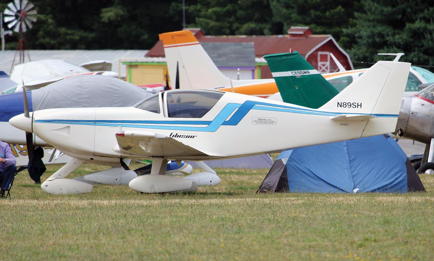

We can avoid this by looking only at the more-common homebuilt types; a larger fleet tends to even out the variation in accidents. Figure 1 shows the MLA accident rate for homebuilts with 60 or more accidents from 1998 through 2017. Above the 4.6% overall fleet average is a hodgepodge of homebuilt types: Pitts Specials, Kitfoxes, Glasairs, and a couple of RV models.

While the Glasair, too, had a (slight) majority of aerobatic accidents (five out of nine accidents), the other three planes on the list (Van’s RV-6 and -4, and the Kitfox) had less than half. Only two of the 12 RV-6 accidents and one of the 14 Kitfox cases involved low-altitude aerobatics.
