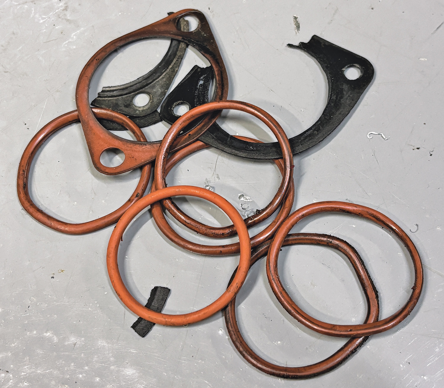

So, the next step was to put on my thinking cap and ponder what would cause high CHTs. Since it wasn’t the ignition timing, there was a high probability it could be lean-running cylinders. My next thought was to check the intake gaskets and O-rings. This one had a cold-air induction intake system, so there were O-rings at the bottom of the intake tubes versus the hoses that are usually installed. Sure enough, they looked horrible and I could see some blue stains from the fuel around a couple of them.
o rings and gaskets
The O-rings and gaskets that were removed. The gaskets were very hard and brittle, and the O-rings showed the telltale blue stain of fuel leaks. Two of the O-rings were kinked, so they were most likely not installed properly to begin with.
Interestingly, the customer stated that the panel upgrade took about 10 months, during which time the aircraft was not flown. Bingo—the seals had all dried out. Boy, they had really dried out. It took quite a bit of scraping and wire brushing to get the gaskets off the cylinder heads, and on top of that, a couple of the O-rings looked like they had not been installed correctly.
