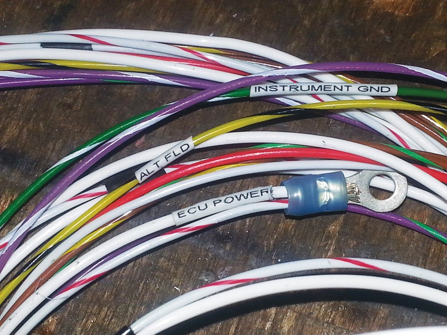

  1. There are several brands of labelmakers that will print on heat shrink tubing. I use a Dymo Rhino, but Brother P-Touch is also very popular.
    Very handy! And needed for aircraft wiring . . .
  2. Another great label maker for electrical work is the Epson LW-PX700. Its capable of printing on 1/8 in heat shrink tubing that shrinks completely on 22 AWG Tefzel wire. You can also plug it into your computer and print multiple labels in one batch from a spread sheet or text file. It has a great feature where it puts a “half cut” between multiple labels on heat shrink tubing, so you can print a string of 20 or 30 (or more) and then tear them apart (with your fingers) as you build your harness. I found this to be very handy. It also prints all the regular vinyl labels as well. Its priced around $120.
