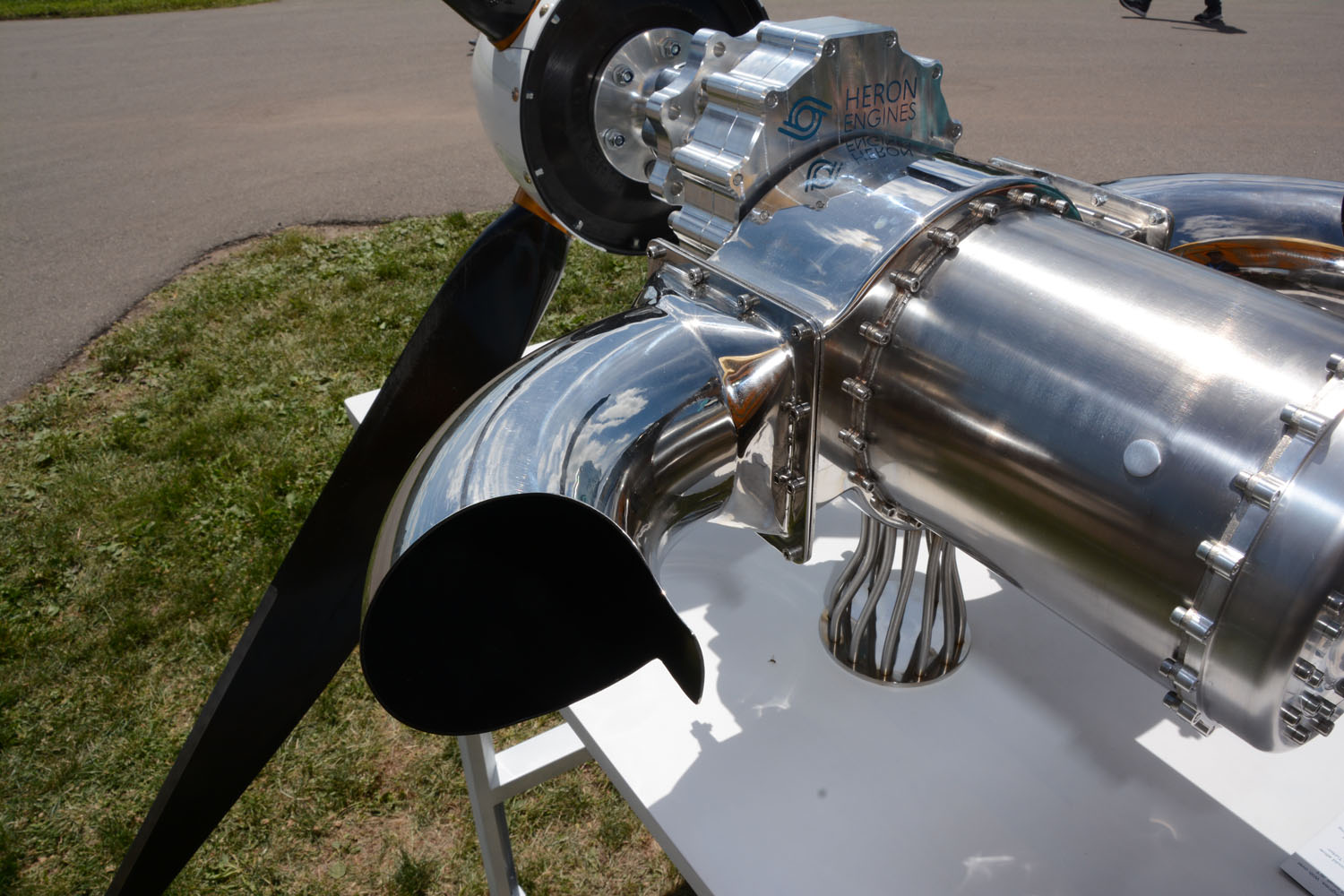

A free turbine, the Heron aspirates through this rear opening and exhausts out the large duct just behind the gearbox—which is covered with a flat plate on this display engine.
Weighing only 82 lb with gearbox, the GVA-130 is rated at 130 hp, carries a service ceiling of 28,000 ft, should go 3000 hours between $7,000 overhauls and burns just about anything you pour in it, although JET-A is obviously preferred. Quoted fuel burn is 10.5 gph. Heron is currently working through certification and final detail testing, so the numbers might change slightly but you get the idea.
Heron 3
Fitted with showy polished exhaust stacks its clear a PT-6 Jr. look would result on any airframe. French prop maker DUC is Heron’s propeller supplier; only electric props are supported but prop and turbine response are both reported as rapid in the necessary rpm ranges so a hydraulic prop should not be missed.
