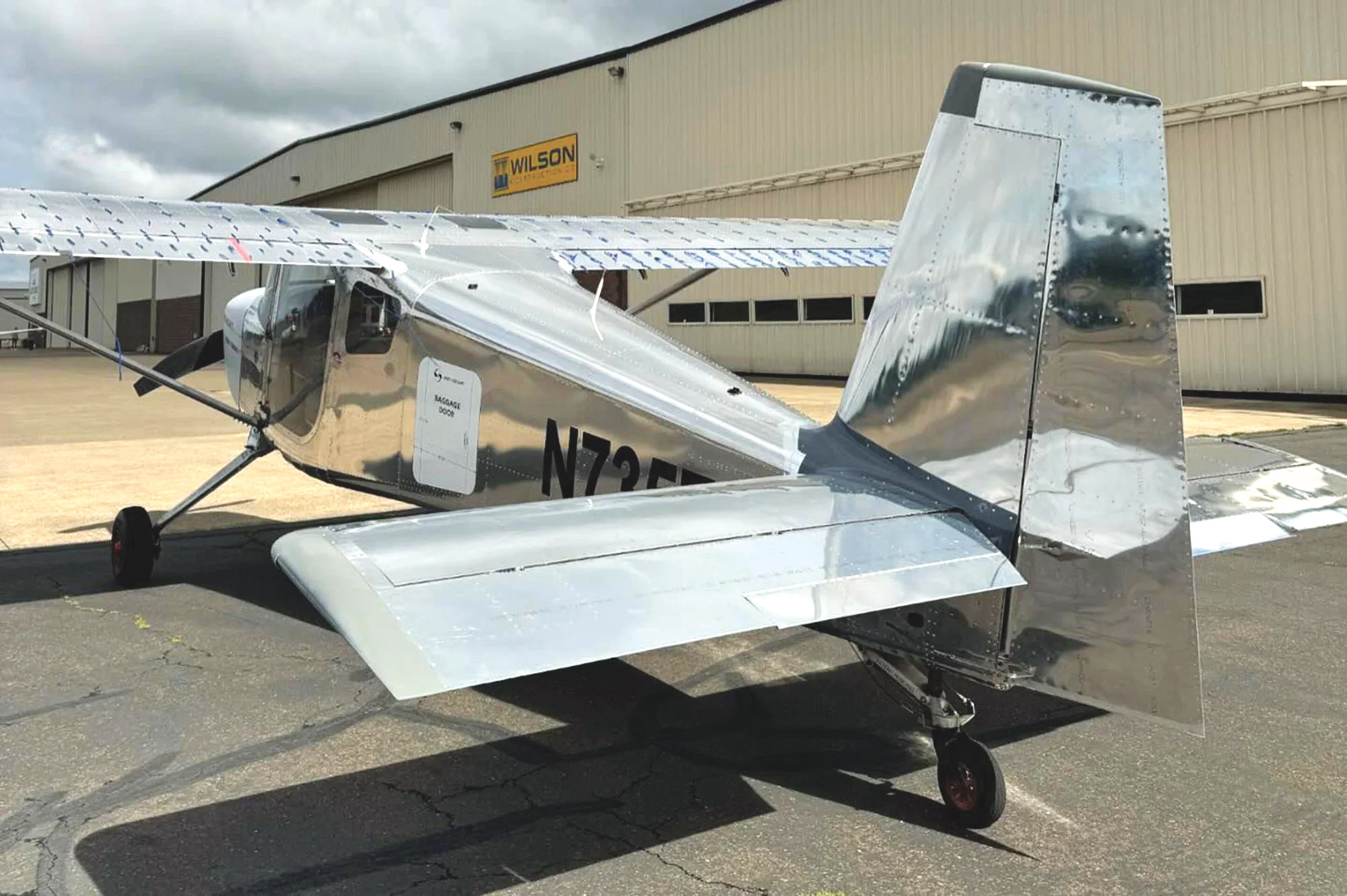

RV 15 tail
Van’s has continued to iterate the RV-15, which now has an RV-10-based horizontal stabilizer and elevator in place of the stabilator. More changes are on the horizon.
But it has not been an easy road for the development team, negotiating Van’s bankruptcy troubles as well as seeking both an understanding of and a remedy for the laser-cut parts issue. The company has made big progress on both fronts—the grinding of the gears down in Aurora is no longer audible from my perch less than 10 miles to the northwest.
So here’s the RV-15 update as I know it. Late in 2024, the team made significant progress by abandoning the stabilator tail and grafting on a slightly widened conventional horizontal stabilizer and elevator from the RV-10. At the outset, the stabilator seemed a reasonable avenue to explore considering that Van’s had success with the RV-12 and that such a vaunted STOL airplane as the Helio Courier used a stabilator. Certainly the 64-year history of the Piper Cherokee suggests it’s not merely a design outlier.
Rather than continue to tweak a design aspect that Van’s pilots just couldn’t get happy with, they went back to their roots with a conventional tail. This is important. It’s better to admit that your first solution isn’t going to cut it and move on to a better solution than dig your heels in or compromise the final design for ego.
Design engineers also made changes to the roll-control system, moved the flap lever from the ceiling to the floor and shortened the wingspan by about 2 feet, leaving 161 square feet of constant-chord wing. No functional changes have been made to the landing gear.
The plan near the end of 2024 was to iterate a bit more by trying a slightly longer tailcone and an elevator with a bit more chord. There are also supposedly changes coming for the rudder to fine-tune control effort and responsiveness. Van’s design staff feels the handling is getting really close, which would let them lock down some key components and begin tooling up for production. They hope to have learned enough by the end of the year to really benefit the next iteration.
That iteration will be an entirely new airplane. As has long been planned, the fuselage will be significantly different, with the engine moving down and forward, the wing aft and the windshield becoming more steeply raked. Testing on the first example with a longer tailcone will help determine if the second prototype will have more distance between the wing and the tail as well. Van’s will also change the doors and for sure have fuel in the wings.
