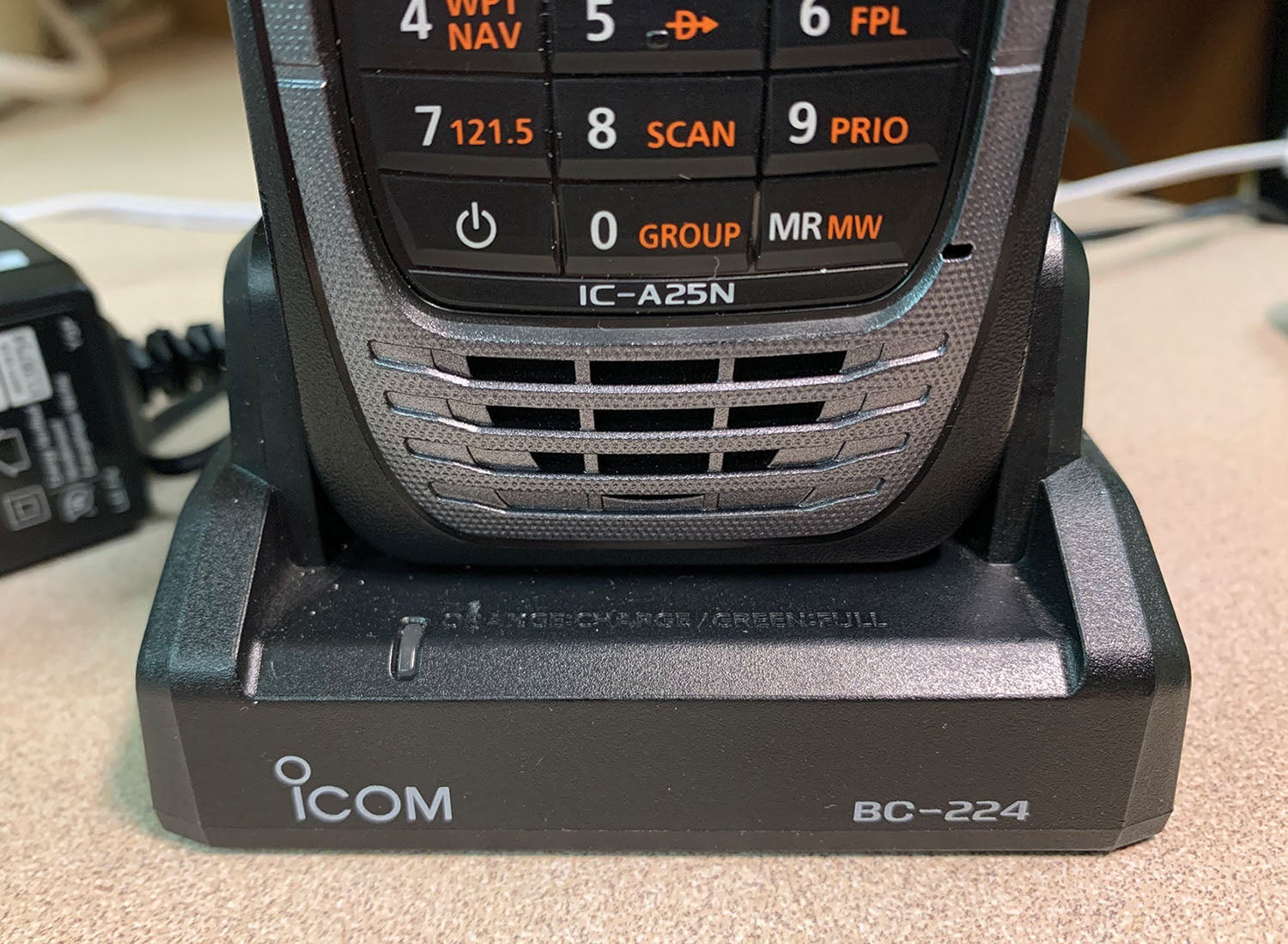

Icom A25N desk charger
We think a USB power input would make the radio better for backup.

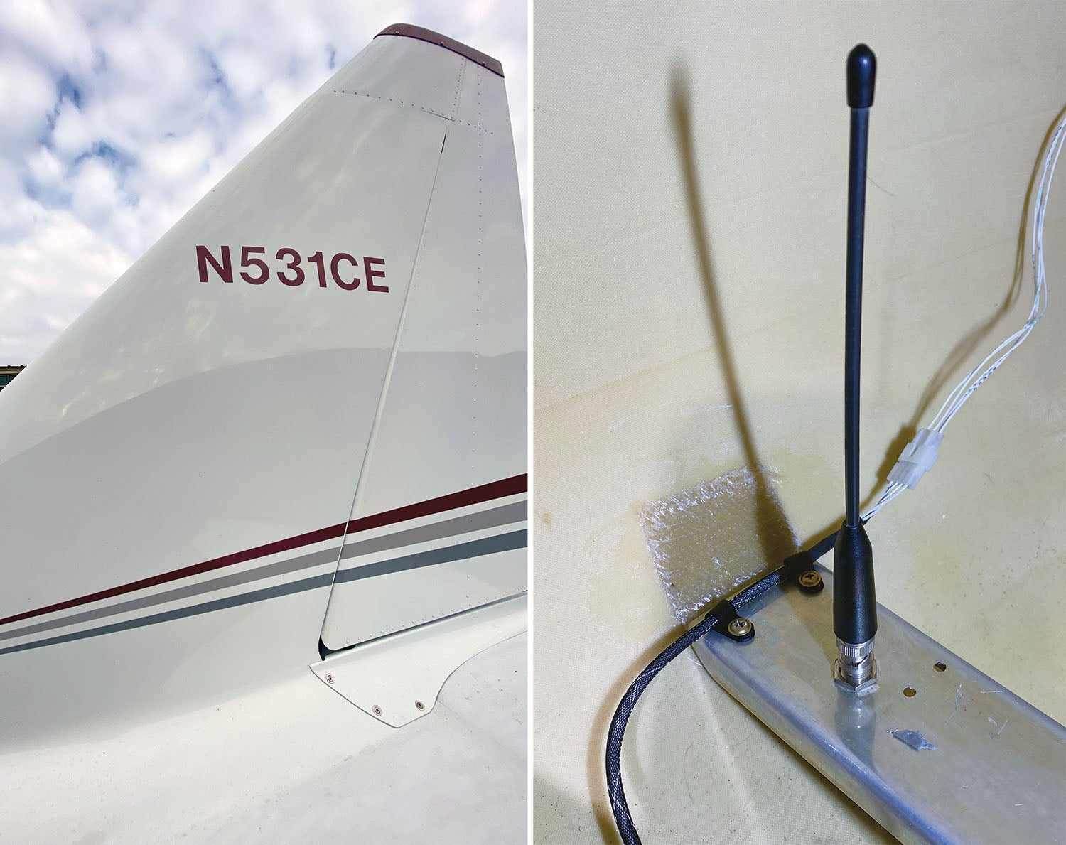

In the real world, the PJ2 is a decent performer, but like most portables it won’t talk the distance (it has a 5-watt transmitter) without an external antenna. Its receiver sensitivity is quite good, able to pull in a signal almost as well as some panel radios. Connect the radio to an external antler and it should perform quite well.
