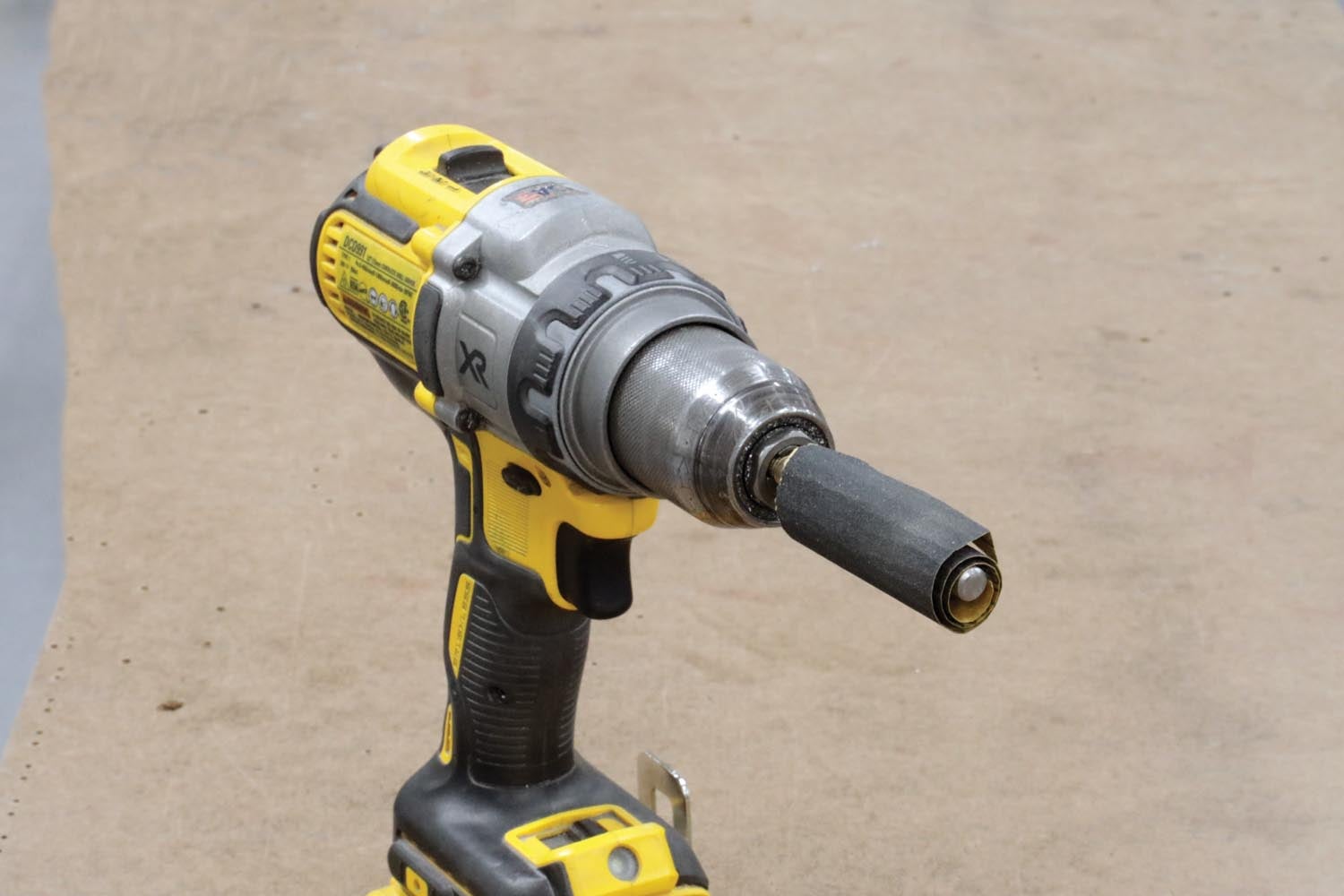

Sandpaper on a Shaft
Sanding small inside radii is done with a homemade flapper wheel. Cut off the head of a long bolt, duct-tape the end of a 4- to 5-inch length of emery cloth to the unthreaded end, wrap it around the shaft and chuck it in a drill. The extra emery cloth acts as cushion between the part and the shaft, and the worn portion of the emery cloth can be torn off as needed to expose a fresh, unused surface. Various diameter bolts and emery-cloth grits can be employed as needed.

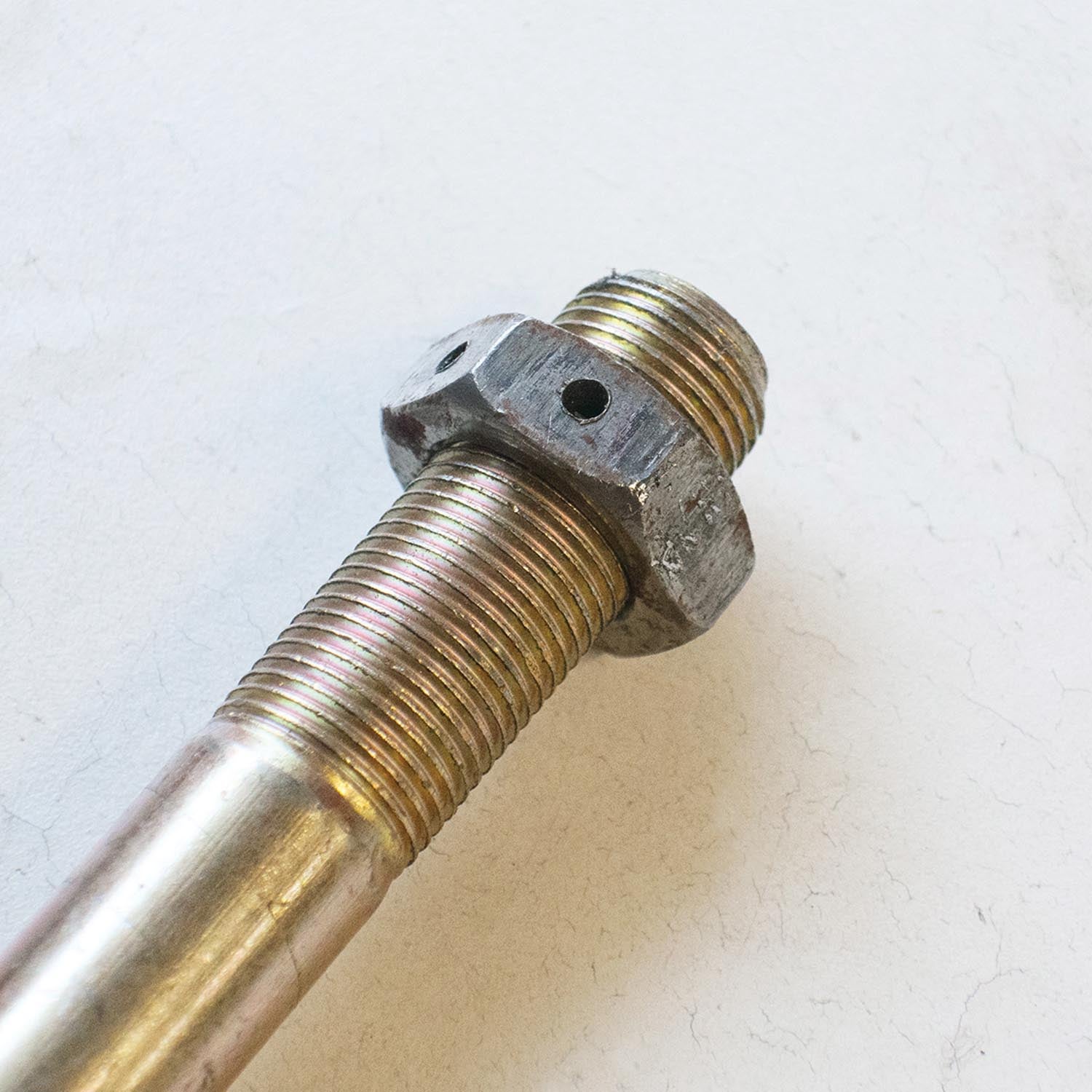

Cotter Pin Hole Drill Guide
When a threaded part or fastener needs a cotter pin but it does not have the necessary hole, this tool is the answer. Rather than attempt to start and drill a hole in the threads with an unguided drill bit (impossible, even on a drill press), drill a guide hole through the flat of a nut and let that hole guide the drill bit for a perfectly positioned cotter pin hole.

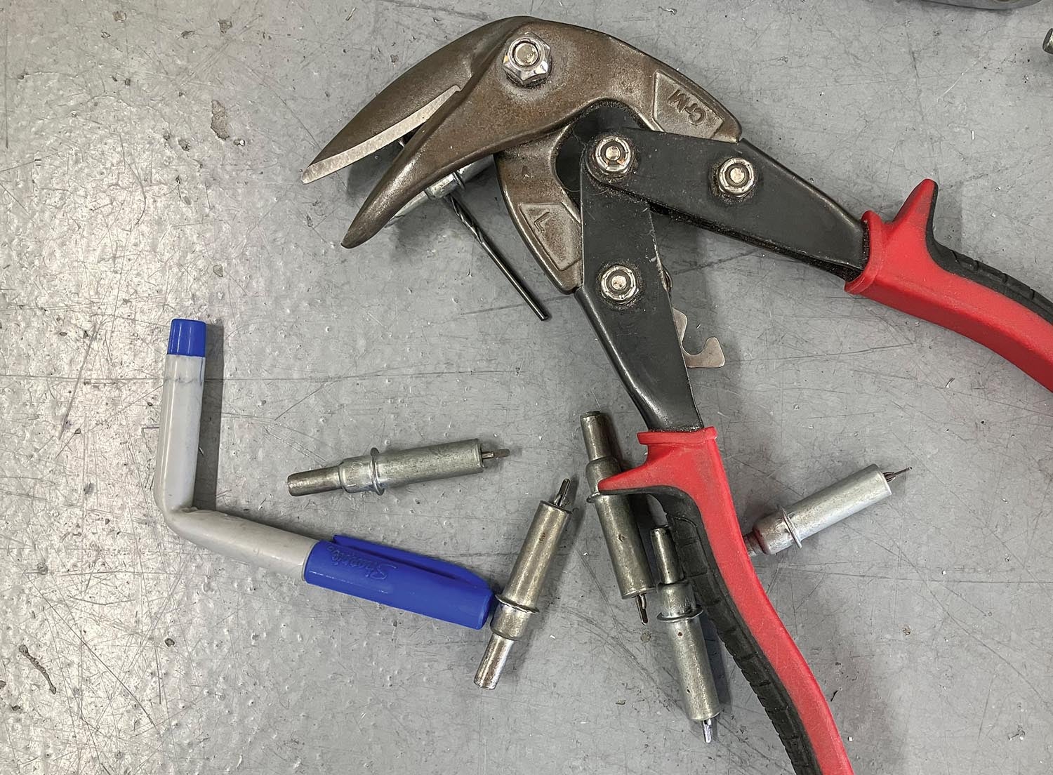

Tools Bent Sharpie FORES
I noticed this Sharpie bent to nearly 90° in the Sonex production facility—brilliant. If the marker doesn’t fit in the cramped area you need to mark, bend it!
