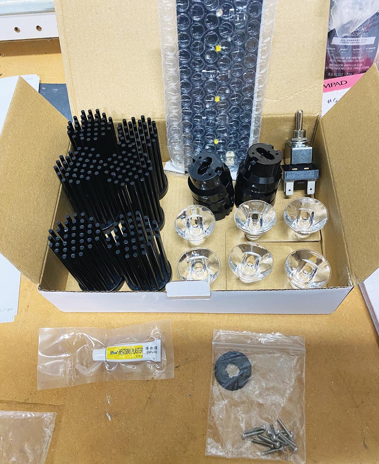

Two Flyleds kits. The switch with the attached wigwag module (upper right corner) is sold separately.
The Triple Spotlight arrives as a “some assembly required” kit from Flyleds, no more difficult to assemble than snapping a few Lego blocks together. The base for the spotlights is a 6×2.4-inch aluminum board with a printed circuit and three Cree LEDs on the front side. The back side is flat and unfinished—perfect for helping transfer heat produced by the LEDs to a mounting bracket. It has two mounting holes, and their location is my only gripe because they are too close to the “porcupine” heat sinks on the back when assembled and don’t leave room for a nut plate. The assembly kit includes a small tube of heat-sink compound that you spread thinly on the heat sinks and then sandwich the board between them and the three lens holders. Wait 10 minutes for the compound to set, snap the lenses into position and you’re done. Really simple and having you do part of the work keeps the lights affordable. The light kit is $139 per side.

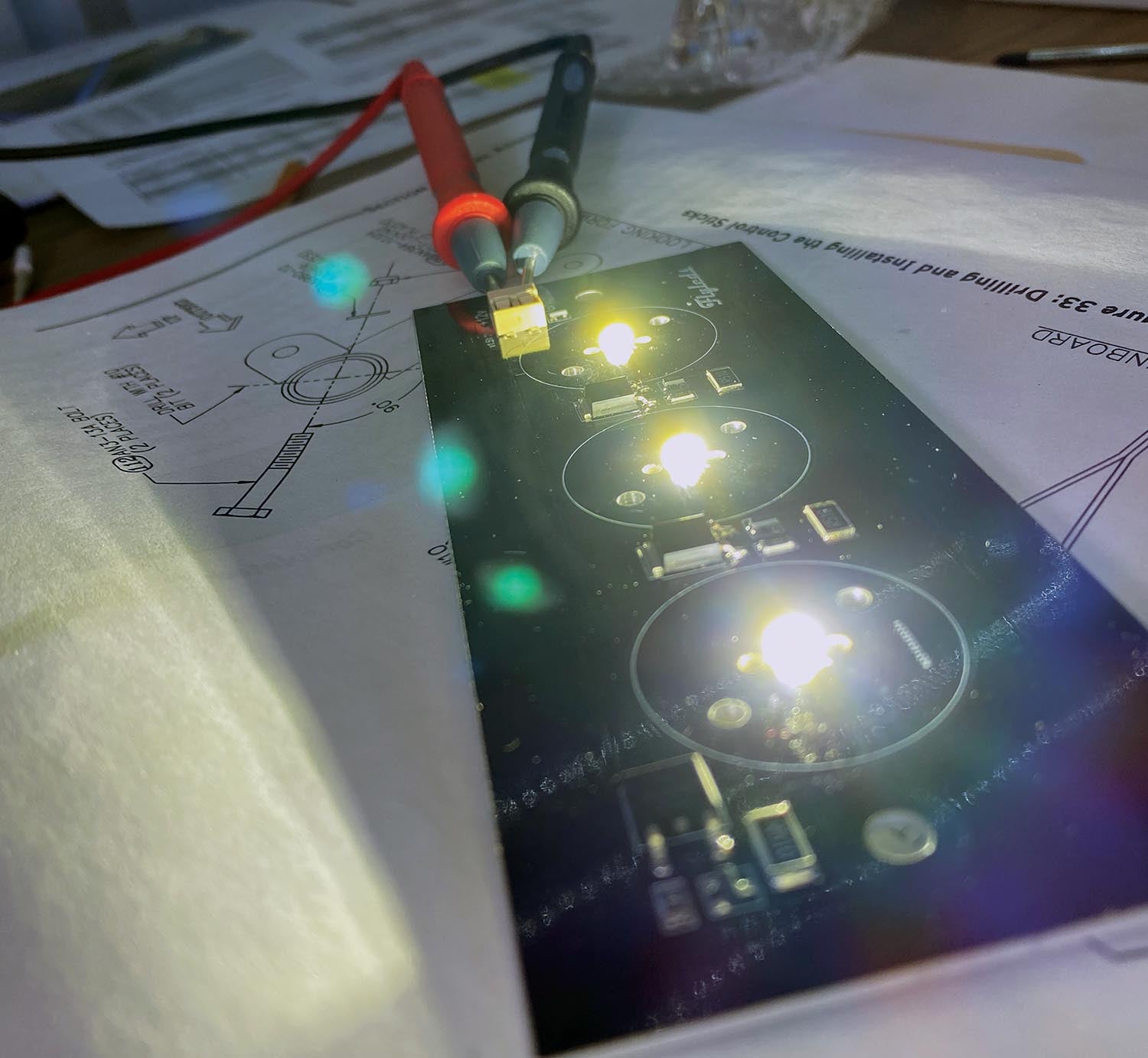

Front and back sides of the Flyleds Triple Spotlight board. The three LEDs draw 3 amps and produce 3600 lumens of light.
flyleds glastar img 5658 testing prior to assembly
Testing the LEDs prior to assembly.

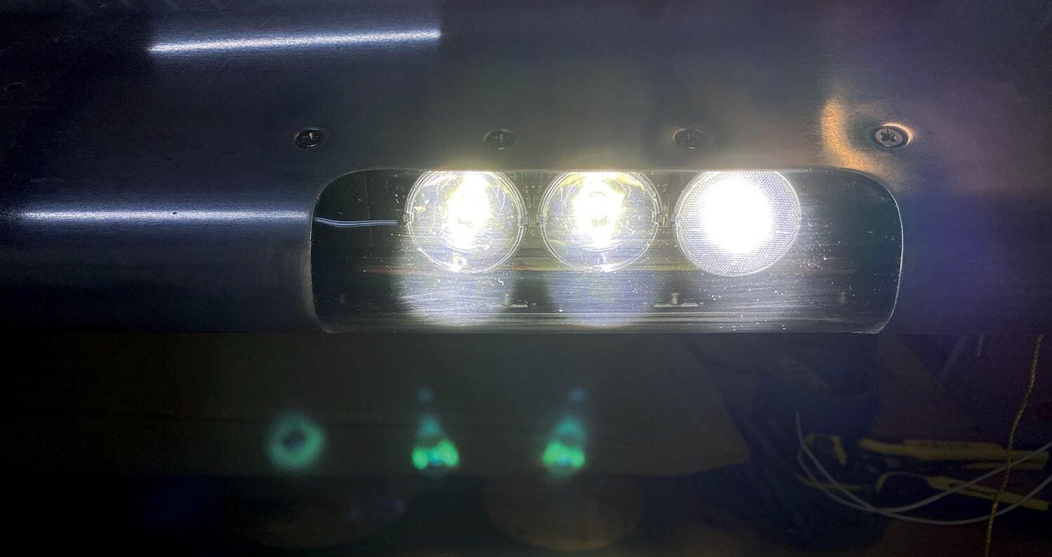

flyleds glastar img 5741 test 1a
After the cut, with the light board loosely in place, check to see if the aperture is the right size. It was. Success!

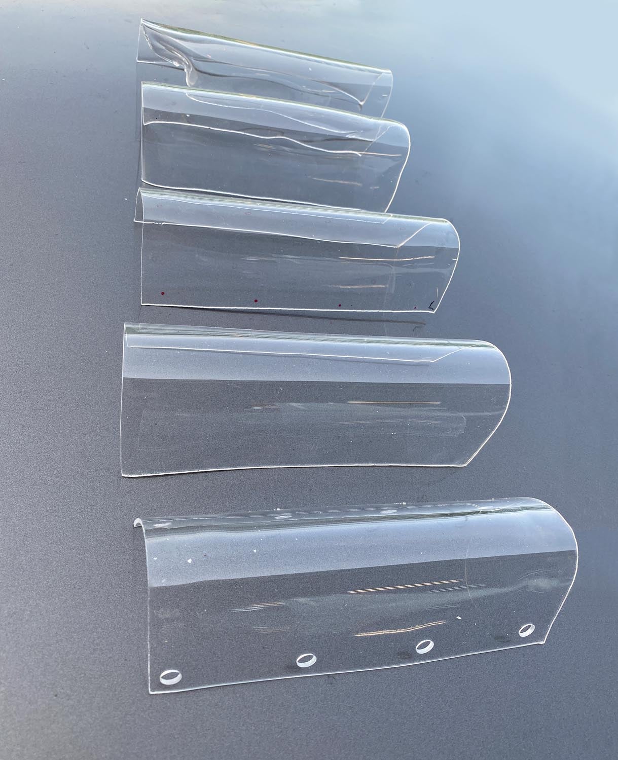

Attempt One
flyleds glastar img 5763 drape mold in front of heater
Early attempt with the drape mold—the idea was that the acrylic would soften up in place and simply drape down to the shape of the mold
I held a small piece of 1/16-inch thick acrylic in front of a propane heater and within seconds it became soft and malleable. Great, I thought, this will be a piece of cake! Only to find out that when I scaled up the dimensions to the size needed, I could not heat the 5×8-inch piece evenly just by holding it in front of the heater. When one side got warm enough to start bending, the other was still stiff. When I turned it around, the soft side hardened. I tried placing the sheet over a steel pipe in front of the heater, but that proved unmanageable as well. I needed a mold.
Attempt Two
No compound curves are necessary for the lens, so I traced the wing’s leading-edge profile onto paper and then transferred it to two pieces of plywood. That gave me the base for the slump mold into which I screwed a 0.020-inch aluminum sheet, slightly larger than my lens. My naïve expectation was that I would blow some hot air over the acrylic, and it would simply fall into the mold. Fall it did, but one side heated up faster than the other, so one corner dropped in first. I tried fixing this by moving things around but again I could not get the part to heat up evenly. One side was soft while the other was stiff. I needed a better method.
flyleds glastar img 5754 attempt 1 in slump mold
Uneven forming was typical in early testing.
flyleds glastar img 5755 attempt 1
The slump mold did not prove successful because the material cooled unevenly and created ripples and distortions before it could take a set.

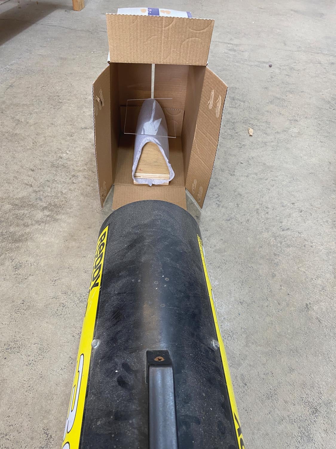

Attempt Three
Drape molding! That’s how they do it on YouTube. I made a mold that was an exact copy of the leading-edge shape and repeated the heating steps from the previous experiment. Right away I could see that with this method I had better control over the part’s placement on the mold, but my heating was still deficient. I placed the mold and the flat piece of acrylic in front of the heater and when the material got soft, I helped it form over the mold. The problem again was uneven heating—the side closer to the heater would soften too much while the opposite side remained too cold to form. The hot side also started sticking to the aluminum part of the mold, distorting the optical quality. This wasn’t going to work—I needed a better heating solution.
Attempt Four
In one of the YouTube videos I watched, the protagonist built a heating oven on top of an old propane grill for a rally car’s windshield. I didn’t need anything that big, but a grill sounded like a good idea, so I snatched Marc Cook’s propane camping grill with an explanation that the acrylic can only enhance the flavor of his future steaks. He didn’t fall for it, but I offered him a couple of Twix bars and he surrendered the grill, err, forming oven. I was in business!
From the third attempt, I learned that there should be something soft between the mold and the acrylic piece so it wouldn’t stick, so I stretched an old cotton T-shirt over the mold. The first attempt at heating the acrylic on the grill was much better than the previous methods. I had a piece of cardboard on the grate and another piece of the cotton T-shirt over that and the acrylic on top. With the burners on the lowest setting the cardboard diffused the heat well and allowed the acrylic to heat up evenly. I was doing this by eye and watching the edges of the acrylic start to curl up for a cue that it was pliable. That was OK-ish but not good enough.
flyleds glastar img 5805 heating on the grill
Layers of materials needed to evenly and gently heat the acrylic. Add your own gas grill or, better yet, borrow one you don’t intend to ever eat from.
The experiment worked, though. I moved the acrylic from the grill to the mold and just set it on top, not really knowing how it would behave. It slumped over partway, but I could see that it would have to be forced into position if it’s going to take the shape of the mold, so I placed it back in my fancy oven for a second attempt. Meanwhile, the cardboard diffuser started to char—it was only going to be good for one lens. The acrylic was now hot enough and I again placed it over the mold, but this time I pushed down on the four corners with my gloved fingers. I was getting somewhere with this approach! The lens took the shape of the mold, but my fingers distorted it to an unacceptable degree.
Attempt Five
flyleds glastar img 5768 close but not a perfect match to wing profile
Getting the shape right took several attempts. The lens is close to the wing skin, but not perfect yet.
This is the one in which I conquer the acrylic sheet but fail on the shape. To avoid charring the cardboard, I stacked a sheet of aluminum foil on the grill, then the grill’s drip pan, and the cardboard wrapped in cotton. I laid the acrylic on top of that. I abandoned my unscientific guessing of the right moment to remove the acrylic from the grill and was now measuring the temperature with an infrared thermometer and looking for about 300° F. The heat-diffusing stack-up and the use of a thermometer proved successful. The acrylic warmed evenly and when it reached 300°, I put it on the form, but this time I helped it conform to the shape by draping another piece of the cotton T-shirt over the hot acrylic, pulling it down and holding it for about 30 seconds. Success! Or so I thought.
The lens looked great and I promptly took it to the wing and pushed it against the inside of the leading-edge skin. It didn’t fit well. My idea of forming it to the general shape on the form and then letting it take its final shape in the wing didn’t pan out because the lens cooled quickly and by the time I had it inside the wing, it refused to change shape. It would have to come off the mold and be the correct shape without any further forming.
flyleds glastar img 5757 drape mold 1a
This drape mold evolved from a bare aluminum sheet the same size as the leading edge (left) to a cotton-covered one slightly smaller than the wing profile (right).
flyleds glastar img 5807 getting better e1680314956107
Here the lens is getting better and sitting tighter against the wing skin.
Attempt Six

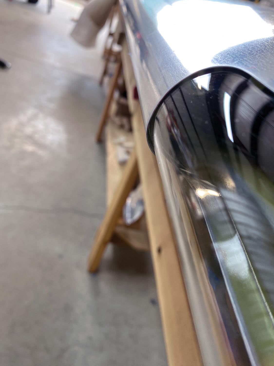

Accounting for the thickness of the acrylic, I remade the drape mold 1/16-inch smaller so that unlike in the fifth attempt, where the shape conformed to the outside of the leading edge, it would fit inside instead. I had perfected the method and the proof was the next lens that came out of the mold—it fit great! I made six pieces so that when they eventually get scratched, I’ll have ready spares.
flyleds glastar img 5842 good fit
Final lens in place without gaps.
Final Fit
flyleds glastar img 5823 progressively getting better
Some of the discarded lenses. Fortunately the acrylic is inexpensive and available locally, so I didn’t mind making mistakes.
