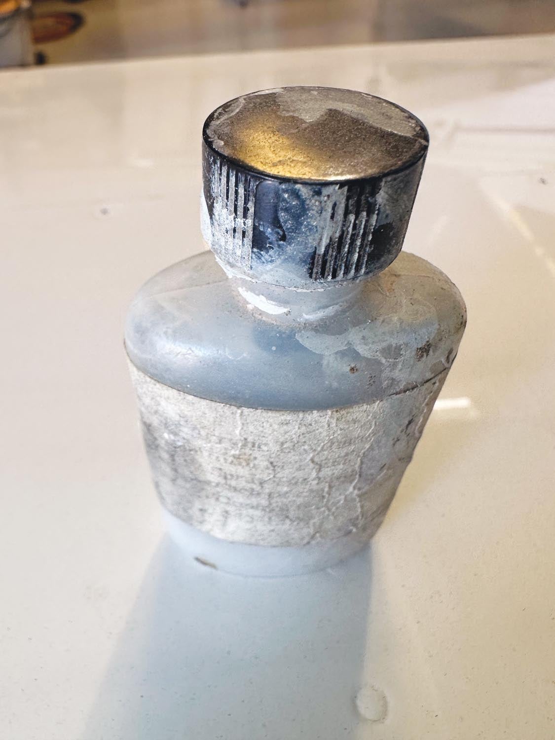

Fast forward a few years of enjoying my creation and one day I decided to do some touch-up interior paint work. I was using the little bottle of gray paint that Van’s sells for touching up its factory powder-coated parts. In a moment of utter moronity, the bottle ended up atop my glareshield while I was bumbling about in the footwell when disaster happened. Somehow gremlins managed to tip the bottle over and spill its sticky contents onto my glareshield cover. To make matters worse, I didn’t notice it had happened until the gooey mess was well disseminated across the surface, seeping where contour and gravity had carried it.
glareshield 06
The malevolent paint bottle that prompted the redo in the first place.
I tried to mop it up with rags but it had seeped down where there is little access due to the sharp angle in places between the glareshield and the windscreen. I knew that solvent would eat into the mat and just make a bigger mess. I cleaned it up as best I could but it was still an ugly dove-gray hickey on my pride and joy.
For several weeks after the mishap, I struggled to figure out the best way to deal with it. I knew that ripping out the original covering layers and replacing them with something new with the windshield in place would be a daunting task. Sometime later I got the idea that the easiest solution would be to cover the ugly top with a thin coat of rubberized paint. When dry, it looked and felt quite nice and it hid the paint spill perfectly. For a brief period, I was confident that my heartache was over. If only…
