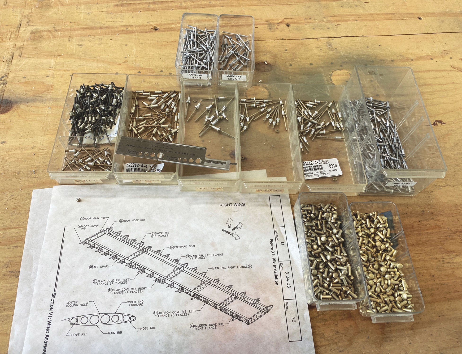

rivets organized IMG 5In visiting projects as a tech counselor and a DAR I’ve often thought telling the story will help others avoid the predicament. While every project is different, and there is nothing better than experience, having a few handy tips can save time and effort. Many of the questions I get are as psychological as they are technical. That’s one of the reasons I begin a TC visit with planning and self-knowledge, because no one wants to think about that, and it’s the one big thing that can delay project completion.

    In building my airplane, I keep everything in marked boxes. I’d inventory each box one at a time, then mark All sides of the box with a sharpie so I could identify that box easily later. With the inventory sheet and marked boxes, it’s super easy to find the exact parts I need per the plans when I need them. When I bought avionics and such, I found another box to keep all of those items in until ready to install. I created a binder for copies of ALL documentation such as inventory sheets, special build instructions, manuals and documents for avionics and other items. I also created a mechanical reference binder that has things like a rivet ref sheet I created, AN bolt hardware ref sheet I created, copies of ALL the material data sheets for ALL of the hardware in my airplane (including cotter pins, piano hinges, washers, rivets, etc.), Sheet metal gauge tables I created from the original material standards, drill ref table I created, thread tables (thread specs, tap drill hole sizes, reamer holes, clearance hole sizes, etc.), and much more. I also create shtmtl bending references, and more. But that keeps all my documentation organized and in one place.
    I also keep all of my tools organized in low cost Stanley toolboxes. Files and deburring, air tools, rivet tools, wiring tools, marking tools, punch tools, etc. All the rivets and hardware are organized in trays on a Harbor Freight organizer. Etc.
