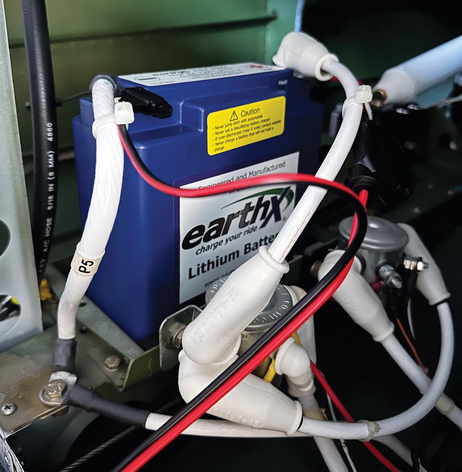

Test fitting the EarthX and connections in the standard Van’s battery tray prior to final installation. The footprint is essentially the same as the original Odyssey 680.

Installation of the battery is quite simple. By design, the battery is non-spillable and can be installed in any position or orientation. Its light weight makes mounting decisions even easier. There are various mounts and boxes available from EarthX and other vendors for horizontal, vertical, firewall and so on. Some builder forums have links to software offerings for those interested in 3D printing their own box. In my particular case, I found the footprint of the battery to be practically identical to my previous Odyssey 680 batteries and the standard Van’s mounting tray to be sufficient with the same spacer blocks I had previously used.

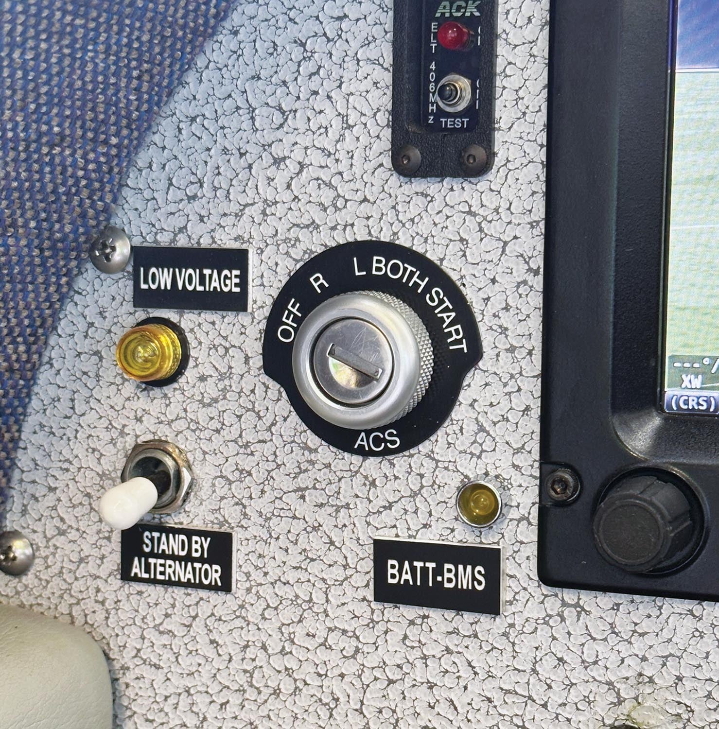

The BMS alerts can be wired to either an independent light or programmed as a widget into most EFISes.
Where the installation process gets slightly more complicated involves accommodating the BMS indicator light. In the Van’s RV-10, the standard location for ship’s battery is in the empennage just aft of the cargo compartment bulkhead. The good news is that when I built and wired the airplane, I ran an extra five leads from the aft area to the instrument panel area. Therefore, I had an available lead already run and ready to go. The bad news is that after installing things like a 406 ELT with GPS, a yaw damper system and some lighting upgrades, the BMS install consumed my last available lead. Fortunately I also ran a fish string when I built for the next upgrade I haven’t thought of yet. Note to builders—run plenty of well-marked extra wires.
Now back to the BMS indicator. The cockpit indicator can be either a widget programmable into most EFISes or a separate (amber) light installed in an appropriate place so as to be readily noticeable. I vacillated on this decision until I ultimately decided to install a separate physical light and ordered the $29 LED assembly option from EarthX, though any similar light rated for the appropriate voltage would work. My reasoning was that with the way my twin 7-inch Dynon SkyView displays are configured, I don’t really have any available screen real estate for an additional widget, especially for one that hopefully will never be used. Also, I have a far corner of my panel where I already had an indicator light for my B&C standby alternator and decided that the BMS indicator would be easy to install and would look “at home” there.
The actual wiring of the warning light is easy enough. The lead from the BMS pigtail takes the circuit to ground when activated. Power for the light can piggyback off of any positive terminal downstream of the master switch. The light only illuminates if there is a problem and, depending upon the anomaly, will illuminate steady or flash either fast or slow.

The EarthX comes with an integrated battery management system (BMS). The system alerts four different anomalies as indicated on the included reference card.
My only quibble with the design is that there is no way to test the system for functionality. After over 35 years of airline flying, that seems odd to me. In airliners, practically every warning system gets tested daily if not every flight. As confirmed with EarthX tech support, as close as one can come to a system test is to unplug the BMS lead at its pigtail at the battery and then touch the terminal end to battery ground. If the positive side has power, the light will illuminate. That will test the light circuit but not the BMS itself.

    I have some reservations on using a lithium battery with a ‘battery management system’, which can disconnect the battery from the buss under overload, low voltage, and other conditions, resulting in total electrical loss.
    I noticed in the picture of the battery and connetions, that the started contactor is ‘hot’ all the time, since it bypasses the master contactor, directly wired to the battery !!….not a recommended connection.
    Also the starter contactor should be mounted ‘upside down’, so that a strong downward jolt will not close the started contactor armature, and activate the started. There is a weak spring that opens the armature connection.
