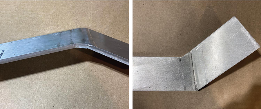

Nicks and scratches on parts (the frightening term for them is “stress risers”), particularly on the edge of a part, are breeding grounds for cracks. They are like the perforations on toilet paper. They enable stress to crack the part. Needless to say, bending a material induces considerable stress. Therefore, imperfections on the part, particularly near the bend, must be removed prior to bending. This is often called deburring, a fancy word for filing and sanding.
As a rule of thumb, any scratch or nick that can be felt with a fingernail must be removed. My personal standard is to remove anything I can see. (For that I was admonished, “You’re not building jewelry!” And I had to agree. I didn’t know a single piece of jewelry in which I could stuff my biology and pull up to 6 G’s.) I remove the worst marks on a part’s edge with files and sandpaper before finishing with a Scotch-Brite wheel or a generic version of a 3M Combi-S wheel, chucked in a hand drill. Deburring is worth every moment it takes to do a good job.

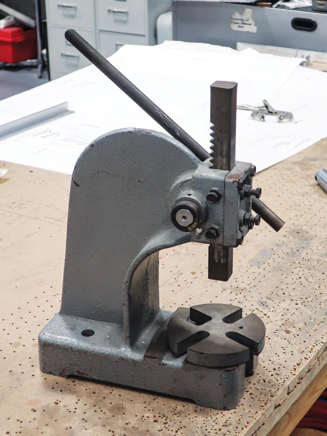

A 1-ton, benchtop arbor press can handle 3/16-inch-thick 6061-T6 if the bend isn’t too wide or too deep.
There’s no way around the need for a press. The best press is one you can borrow the use of. Barring that, a 1-ton benchtop arbor press can be purchased for under $100 and will generally handle 6061-T6 up to 3/16-inch thick. Success hinges on how much pressure you can exert and the length and angle of the bend. A wide or deep bend may prevent your success. I’ve bent 3/16-inch-thick 6061-T6 parts up to 2-1/2 inches wide and up to 35° with a 1-ton arbor press. Arbor presses come in various sizes, but get pricey as their capacity grows. If you need anything over 1 ton, and have an empty 20×20-inch spot on your shop floor, your money is best spent on a hydraulic H-frame press. They are powered by a bottle jack and can be purchased for under $200. Still, borrowed time on someone else’s press is the most cost-effective route for a builder with only a few parts to bend.

It’s critical to remove nicks and scratches from a part before it is bent (above). Here you can see the difference between a part that has been deburred and one that hasn’t.

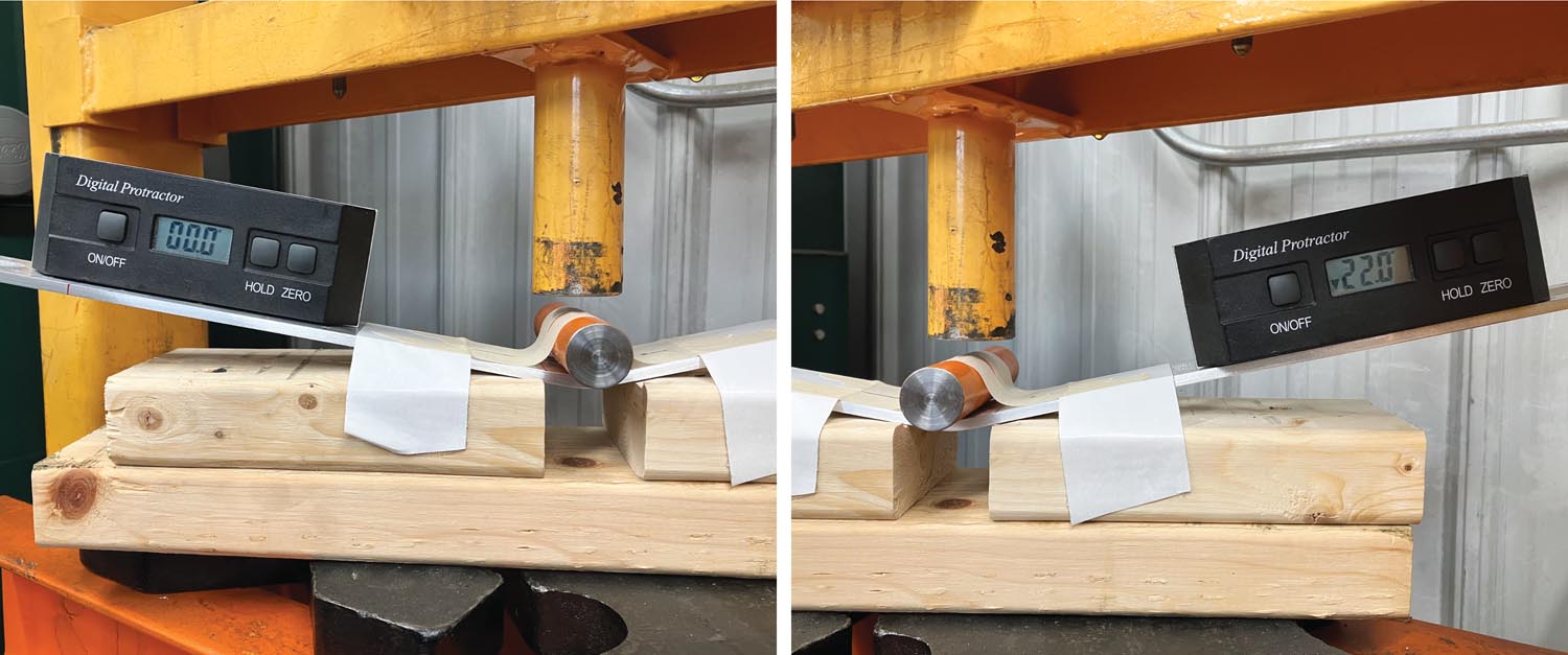

All that’s left is to apply pressure to form the part to the correct angle. I’ve used any number of methods to measure the bend, but I’ve settled on using a digital level. It gives real-time feedback as I make a bend, which reduces the risk of overbending the part, and shows me quickly if I’ve compensated for the material’s springback. (More on springback in a moment.) What’s more, neither the part nor the fixture is disturbed throughout the process, reducing the risk of distorting the part. As the press’s pressure is increased, the level provides a real-time indication of half the bend angle, because it’s only measuring one side of the bend. However, we can assume that both sides of the part are forming equally, therefore a 30° bend will indicate 15° on the level. A 17° bend will indicate 8.5°. I think you see the pattern.
Bending Flat Parts 21
To compensate for springback, this part had to be pressed to 13.5° (left) to achieve the required 10° angle.
However, if you bend the part only to the target angle (for instance, 10° indicated for a 20° bend), a thing called springback will cause the part to relax to a lesser angle. Springback varies by material, material thickness, the length of the bend, the angle of the bend, the bend radius and, I’m sure, more. All you need to know is none of that matters because this is where using a digital level shines. When you reduce the pressure on the part, the level will show how much the part relaxed, or sprung back. If your goal is a 20° bend (10° indicated on the level) and the level indicates 8° after the pressure is removed, there is 4° of total springback. It’s safe to bring the pressure back up until the level indicates 12° and then release the pressure to see what the new angle is. If it indicates the target angle, you’ve nailed it. If not, continue to creep up on the bend until you reach the target angle. If you overshoot a few degrees (using this method it should be a few degrees at most, unless you grew impatient), contact the kit manufacturer for the proper remedy. Their response may indicate the part is good as is, can be safely unbent to the correct angle or must be scrapped.
Let me convert that mass of words into ordered steps:
  1. Place a digital level, aligned perpendicular to the bend, on one side of the part. Tape it in place if you think it may not stay.
  2. Zero the level’s readout.
  3. Slowly apply pressure until the level indicates half of the desired total bend or slightly more. The tape will break, but the pressure of the press will keep everything in place. Also, the wood base will get somewhat crushed, but that doesn’t impact the part or the procedure. The fixture is almost always good for more than one part.
  4. Slowly reduce the pressure so the ram retracts but remains in contact with the radius tool. The ram will keep everything in place in case more bending is required.
  5. Observe the reading on the level.
    • a. If it is half the desired bend, you’re done.
    • b. If it is less than half the bend, re-apply pressure to compensate for the material’s springback.
    • c. If it is more than half the desired bend you’ve gone too far. Contact the kit manufacturer for guidance on correcting the issue.
