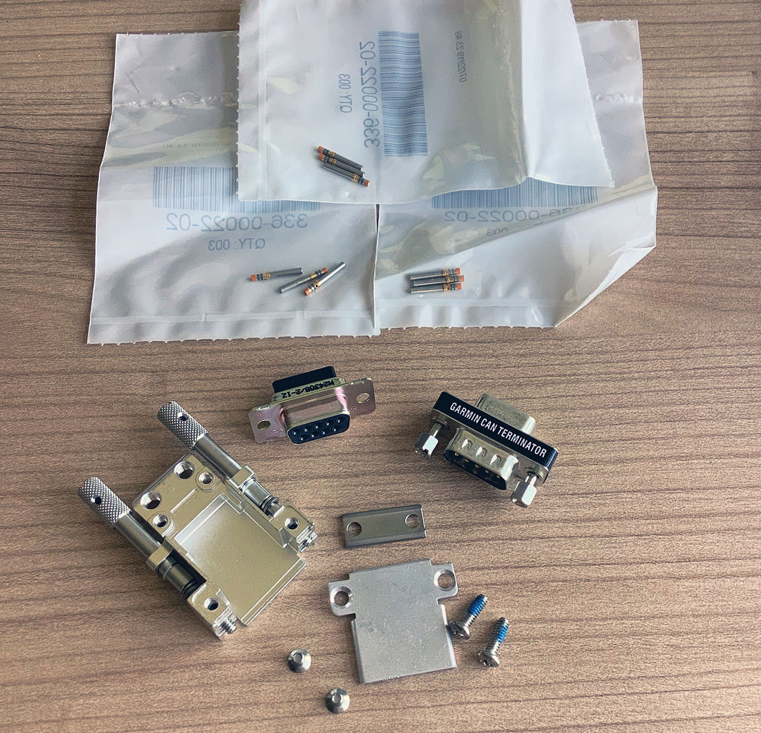

The basic contents of the connector kit includes a 9-pin DB socket, a metal backshell with strain relief, crimp-on machined pins, and a CANbus terminator.

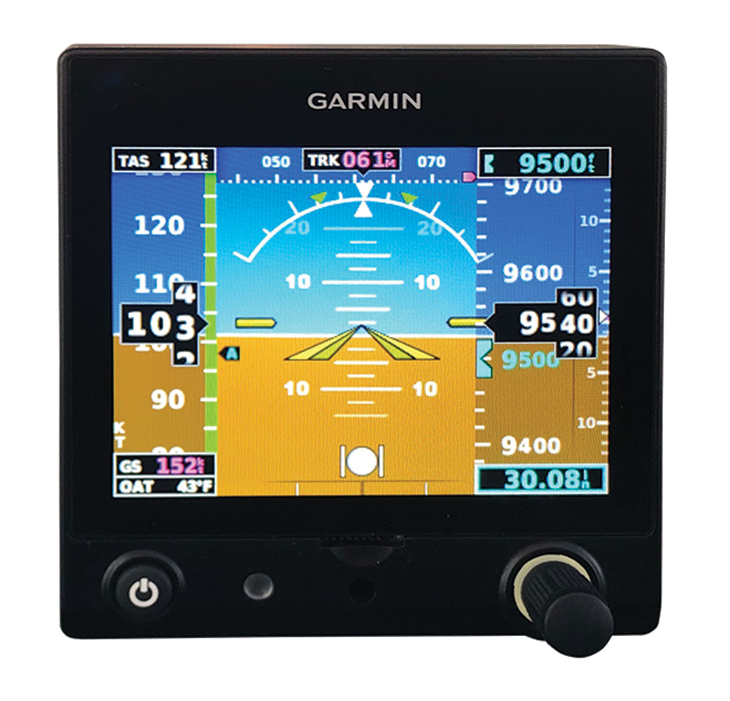

Once you’ve completed a straightforward systems check and calibration, the G5 is ready to fly. And it does so splendidly, constantly reinforcing the idea that old-school gyro and analog pitot-static instruments are wiggly, jiggly, and prone to failure. The visual layout is a miniaturized version of Garmin’s established EFIS paradigms, and includes programmable markers on the airspeed tape for things like Vx, Vy, and Va, as well as the color bands for the other limitations. You can choose from different flight director cue styles, as well as either sky- or ground-pointer AI layouts.
Two bugs are available, one for heading (or track) and one for altitude, easily accessible through the single front panel knob. Press once to get to the menu. Rotate to the item you want, press the button again, then make the change you desire. It’s easy once you stop trying to touch the screen. The default setting on the knob is baro; just turn it without pushing to change the altimeter setting.
Overall, the presentation is very good and remarkably clear for what is really a small instrument. (Somehow the photos always make it look bigger in the catalog.) My one legibility complaint is that the vertical-speed tape on the far right edge is fairly small. You will get used to it, but it’ll take some time behind the instrument before a glance will do it.
In addition to the full EFIS display, the G5 can act like an HSI, and that’s how you’d likely configure a pair of them in the same panel. The second one can share all the data from the external modules and be configured to come up as the HSI on startup. It’s there, by the way, that Garmin elected to place the winds-aloft data not on the PFD page, which is probably smart considering how much data is already there.
Still, Garmin has packed some great features into the display. For example, the G5 shows both a slip/skid ball and a rate of turn at the bottom of the display. There are small tick marks to show a standard-rate turn, but the device will also show green triangle-shaped pointers in the bank-angle display that move based on airspeed. That way, you can nail exactly the right bank angle that results in a standard-rate turn for that speed. It’s nice stuff for the little guy.
