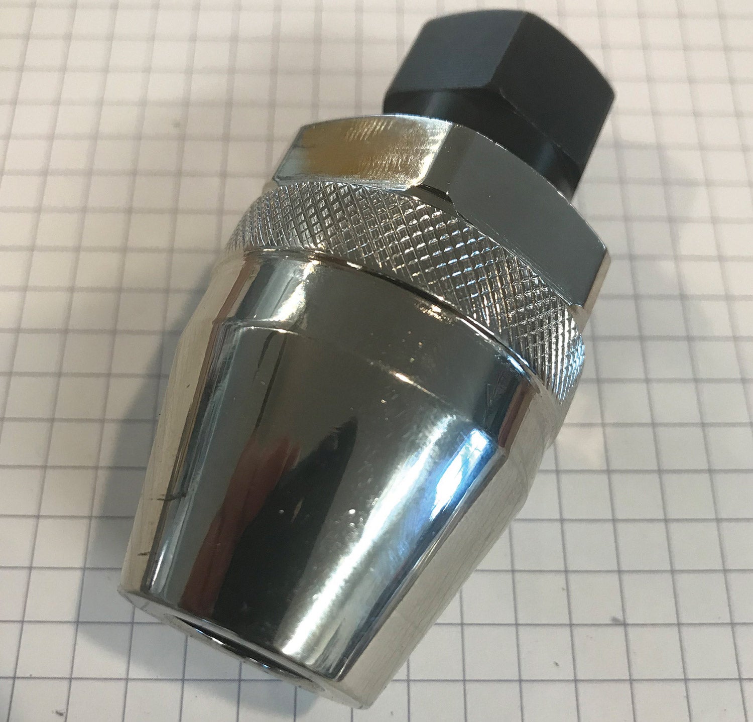

A dedicated stud-pulling tool might sit in the back of the box for years. But when you need it, you really need it.
Take, for example, a dilemma I had a few years ago while upgrading to electronic ignition. This required removing the magnetos entirely and replacing them with electronic mags, neither of which needed an impulse coupler. This meant that the impulse coupler adapter could come off the left side mag hole and, because of this, the studs were now almost an inch too long. So the studs had to be replaced. Getting those studs out with the engine on the airplane was not an easy task—after all, they’d been on there for 1600 hours of heat and cold. Even double-nutting them was not working. You could see the dang things trying to twist and, frankly, there were engine-mount tubes in the way of the wrenches so that you just couldn’t get a good angle on them.
What I needed was a really good, high-quality stud puller. Snap-On made one but it cost over a hundred bucks! Wow—that’s a lot for a tool that you’re only going to use once in a while and it was a struggle to come to grips with the need. Then I got to thinking what it would cost if I messed up the accessory case by breaking off a stud. Not only would it cost money in machining, it would take a huge amount of time to pull the engine, find the necessary engine stand to do the work, etc., etc. A hundred bucks for a tool didn’t seem so bad when stacked up against hundreds of dollars of potential additional costs if I screwed the thing up.
The clincher came when I found that a friend had the tool in a city a couple of hundred miles away—I hopped in an airplane, flew up there, bought him lunch, borrowed the tool and did the job right. It took just a minute or two to get the stud off and I returned the tool when the airplane was flying again a few days later. Yeah, I probably spent as much in avgas as I would have if I’d bought the tool outright—and, eventually, I did buy the right tool so that I could be the one loaning it out next time. But the lesson of using the right tool for the job was learned.
