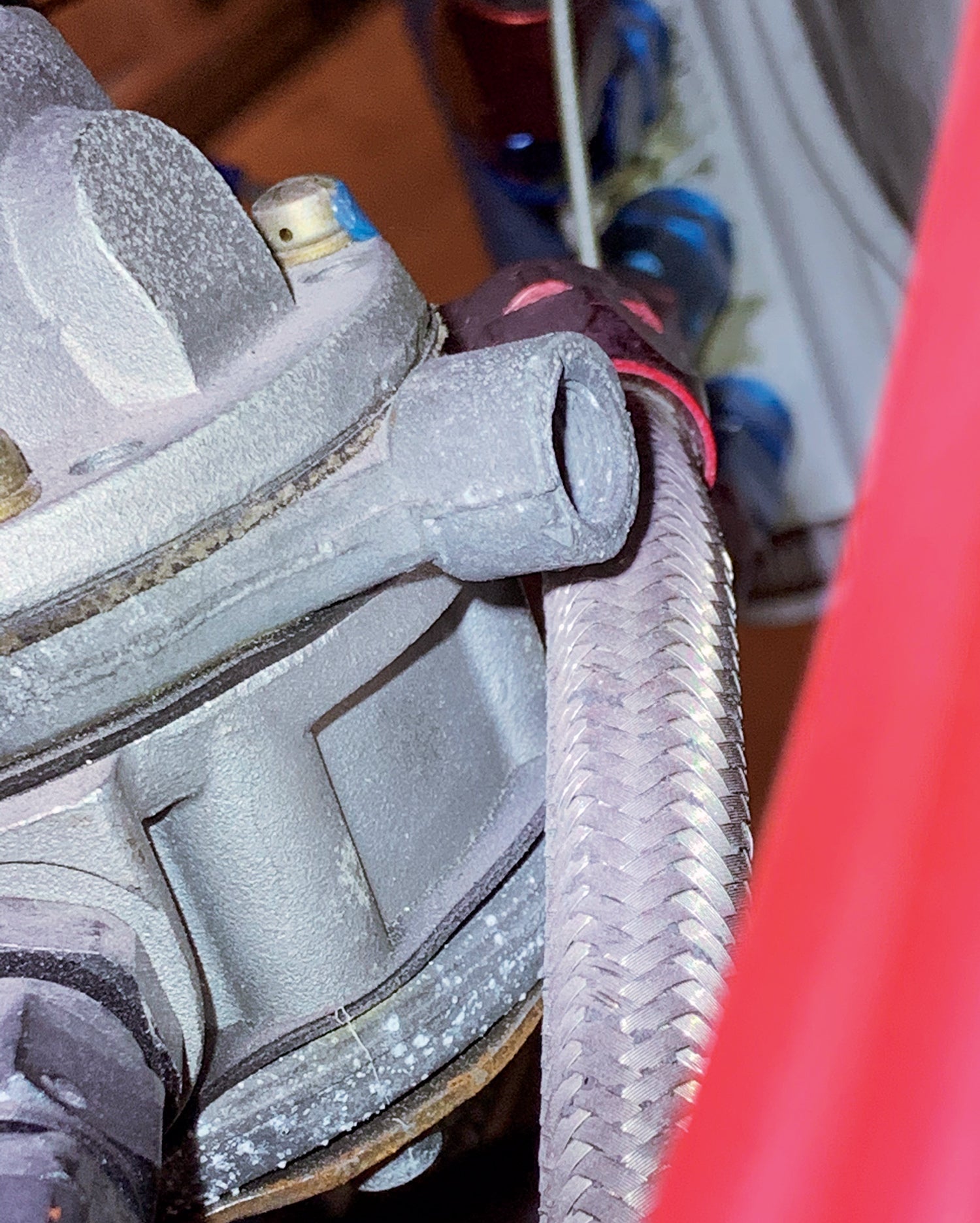

missing overflow tube 1The overflow connection at the engine-driven fuel pump needs to be connected to a tube that exits the cowling.
Without that, as seen here, the pump could potentially drip or leak fuel on top of a hot exhaust pipe, causing a fire.
