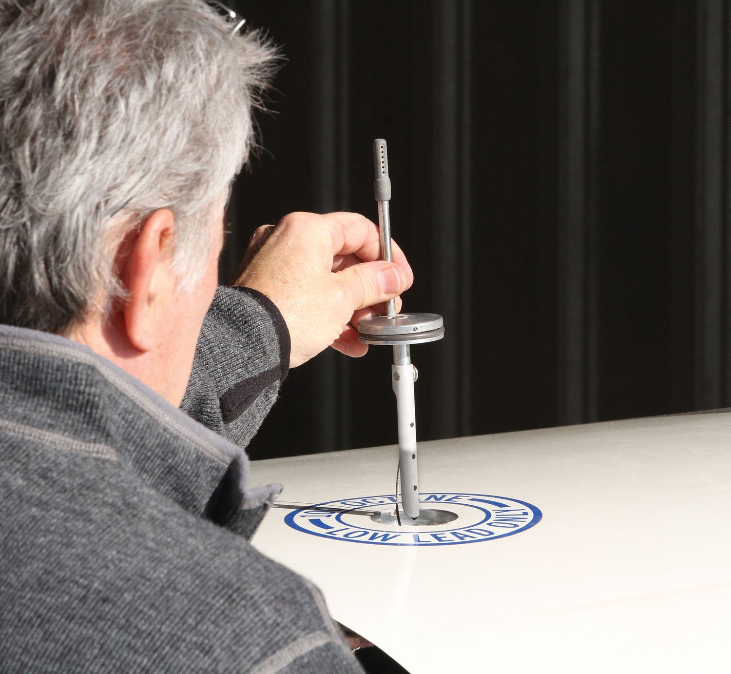

Using the shopmade freehand dipstick (left). The notches on the side are for checking the Funkist. The four notches engraved on the lower face (right) correspond to the level in the wing tanks on the Jabiru. The dark segment shows the tank to be just over 1/4 full. The humongous handle is so you never have to go fishing for it inside the tank.

The first step was to measure the diameter of the stem, the screw for the grounding lead and the depth of the tank (left). The OD of the stem was, coincidently, a perfect match for the ID of a piece of ½-inch-diameter 0.049-wall 6061 aluminum “hobby” tubing sold in one-foot sections at my local hardware store. The dipstick design I settled on looks like a long fingernail (right). The three small holes represent ¼, ½ and ¾ levels. The length is deliberately shy of the bottom of the tank by an eighth of an inch. I wanted to avoid any possible chance of the dipstick burnishing a hole in the tank and causing a fuel leak.

Fast forward to 2021 and I am doing a preflight on my Jabiru. I remove the fuel caps on each tank and use my shop-made dipstick to check the fuel level. I made the dipstick in 2011 for my first airplane, the Victor Stanley-built Funkist (a Teenie-Two variant). The Funkist fuel tank is between the engine and cockpit and is a relatively deep tank, so you need a dipstick to confirm the exact fuel level. When I made the dipstick, I sandblasted it with the idea that fuel clinging to a matte surface would be easier to read. It works great, even in bright sunlight. Later, when I got the Jabiru, I added a second set of graduation marks on it to correspond to the shallower profile of the Jabiru’s wing tanks. As I was putting the dipstick away, it flashed into my head: Why not add dipsticks to my fuel caps, like the Gobosh? Yes, the Jabiru tanks are shallow wing tanks and the fuel cap is completely different, but the caps have a stem/extension for attaching a wire grounding tether, which proved to be ready-made for attaching a dipstick. It’s so simple, I don’t know why I didn’t think of it before!

After attaching the dipstick to the fuel cap stem with the grounding tether screw, a final check was made to verify the gap between the dipstick and the bottom of the tank.
