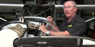

Rod designed the engine mount for the Continental O-200 with CAD on his laptop. It’s made from 4130 steel tube. The prop surprised me. Looking at the side of the prop, I opined, “The prop has a wider face to the air than the climb prop on my 150.”
“Jim Fix [of the Fix Prop Shop in Lincoln, Nebraska] made it,” said Rod. I told him I wanted to go 75 at 2400, and he just about hit it. Sad to say, Jim has since retired and sold his equipment.”

Instead of a traditional Ford Model A engine, Rod’s Pietenpol is powered by a Continental O-200 turning a fixed-pitch McCauley prop. Note the eyebrow scoops for cylinder cooling.
