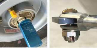

Then there are those tail attachment bolts. How many times have you put them in and taken them out, and how many times have you used the lock-nuts? Is the cad plating scratched off? How do the heads look? Aircraft hardware is designed to close tolerance because weight is important. There isn’t that much extra material, so if you have damaged a critical fastener in any way, it is probably trash. Is it good enough? Well…whats the worst that could happen?
