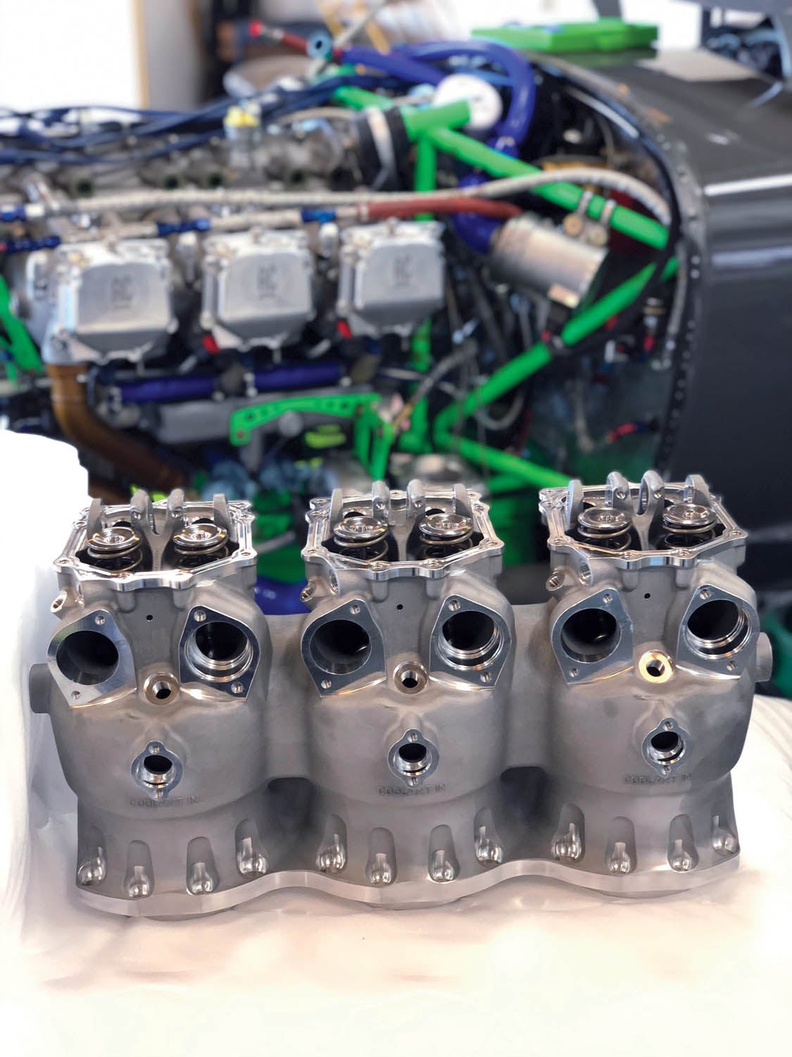

Longtime freelance engine designer Andy Higgs joined with businessman and Reno racer Karl Grove in 2021 to form AC-Aero. Their goal: Introduce new, non-certified engines with modern cylinder designs and increased displacements. Performance and efficiency were preeminent; affordability was well down the list, so the result was distinctly handsome but not inexpensive hardware.
Two very separate engine lines were developed. The first uses new AC-Aero water-cooled cylinders joined to Lycoming engine cases and a second, more radical, completely new HIGGS family of engines built around a unique combination of two- and four-stroke technologies, burning Jet A and organized into a wide variety of engine layouts. (These are discussed in the Circling the Airport section below.)
After COVID-driven delays getting cylinder sleeves in mid-2022, the AC-Aero liquid-cooled cylinders are in production with an approximate two- to three-month lead time before delivery. Multiple sets of these cylinders and complete engines built with these cylinders have been sold and Grove has raced his personal Lancair Legacy with such an engine at Reno. Well-funded early adopters willing to try something advanced and aware of the surprises and setbacks typical of new programs are a good fit for these cylinders/engines.
AC-Aero’s liquid-cooled cylinders are for four- and six-cylinder Lycoming architecture engines. They include the Legion stroker kits, which use a longer stroke crankshaft to gain engine displacement (409 inches for four-cylinders, 613 cubes for six-cylinders).
EBG2023 4
AC-Aero’s cylinders go far to turning a Lycoming into a far more modern, liquid-cooled engine. Benefits include increased engine rigidity, no shock cooling, tighter internal clearances, less oil contamination and a more modern, efficient combustion chamber.
The liquid-cooled cylinders are identified as Gladiator (four-cylinder) and  Centurion (six-cylinder). These are completely new cylinder bank designs, configured to run on standard Lycoming bottom ends. They turn a Lycoming into a liquid-cooled engine, in other words. Naturally, the AC-Aero cylinder design features a more modern combustion chamber along with a displacement increase. When the Legion stroker kit is combined with the liquid-cooled cylinders you end up with the Gladiator X440 four-cylinder and Centurion X660 six-cylinder engines. Yes, the numerals denote the resulting large displacement, which gives an idea of the power potential based on simple displacement alone.
Advantages to the new liquid-cooled cylinder banks are an advanced combustion chamber, tighter piston and piston ring tolerances for more power and less oil consumption, elimination of shock cooling, along with less weight compared to air cooling (yes, including the coolant, radiator and so on says Grove).
AC-Aero uses a service center approach for engine assembly and installation. The first of these, Aircraft Service and Parts (ASAP) in Bakersfield, California, assumed responsibility for all of AC-Aero USA LLC in the U.S. last year, allowing Karl Grove to concentrate on marketing while George and Jacob Sturges from ASAP take care of daily operations. Customers can fly in to ASAP for turnkey installations. The best advice is to communicate with AC-Aero or ASAP directly as an amazing number of combinations and possibilities are on offer, from starting with rebuildable Lycoming cores to all-new engines. Furthermore, Andy Higgs lives in Japan and uses Japanese foundries and machining so there can be a wait for the next batch of parts.

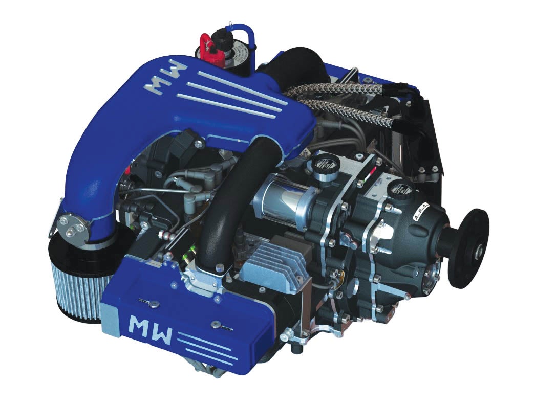

MWfly engines are organized under two general headings, the blue painted SKYline for cruising and the red painted REDline for performance. The physical differences between them are few and more typically found in the computer software for more rpm and power.
EBG2022 12
Upgraded in 2022 with a redesigned cylinder head for a meaningful increase in efficiency, the Spirit MWfly SKYline engines are still available in two states of tune. Blue denotes an efficient cruising tune; red means performance.
These engines are thoroughly modern, horizontally opposed, liquid-cooled, single overhead cam, electronically fuel-injected designs with dual ECUs as standard equipment. Engine rpm natively tends to the 4000 to 4500 rpm range and a PSRU gearbox is a common fitment.
In the last year MWfly redesigned the cylinder head (and valve covers) for reduced weight and increased efficiency. Labeled Spirit to differentiate them from their earlier selves, the new designs have re
alized a 10% increase in fuel efficiency. A Production Organization approval has also been obtained from EASA, the first step toward certification in Europe.
In the works this year is a possible turbo-normalization option, but more immediate is a hydraulic constant-speed propeller using Sensenich blades. It fits the 122, 135, 140 and 160 geared Spirit engines.
Of course, MWfly is hardly a household name with American airport bums, but the naming of Nic Dawson as their North American distributor last year has helped. He’s in Wentzville, Missouri, as MWfly U.S. LLC. Also, MWfly has been shipping engines since 2013 (about 300 to date), with approximately 100 examples flying in Europe, plus the company continues showing vitality.
Dawson reports firewall forward kits are available for most Zenith 650/750s plus a couple of Sonex models and the Just Aircraft Highlander. Typical with European engines, he prefers to keep general pricing information in euros until it’s time to provide a custom quote as the exchange rate fluctuates. A good illustration is that MWfly raised their prices approximately 10% recently, but the strong dollar has pretty much erased the increase to U.S. buyers.
He notes the MWfly engines typically end up running between $23,000 and $27,000, depending on the model, with accessories around $3500 for a total cost of $30,000 or a bit more. Also, the 135- and 160-hp direct-drive engines garner much attention but are high-rpm units for helicopter use only and can’t be used in fixed-wing applications.
