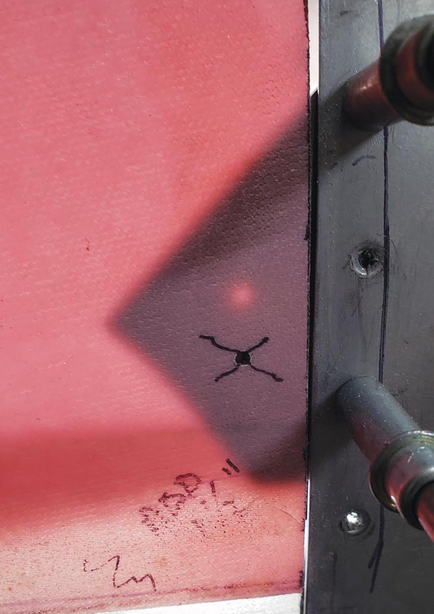

Light showing through the cowl, indicating the location of the hole in the temporary flange.
Inventory the Skybolt kit to become familiar with each of the parts. Make sure the top cowl is centered and place a sandbag or weight near the center to keep it from moving. Grab one of those Skybolt 1/8-inch Cleco drill bushings and a piece of black Gorilla tape. Poke a hole in the tape and center the bushing hole on the tape, then slip it into the top center flange on the inside facing out. I found a way to tape a flashlight so it shined through the hole. A work light will also fit the bill.
Go up top and carefully drill that spot of light #40. You want the bit to go into the bushing hole. Match drill #31, making sure to hit dead center on the bushing hole. Cleco. Congratulations! You got one done.

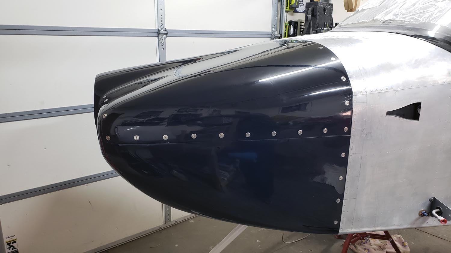

Cowls attached. Notice that the split trim line has been cut.

Let’s adjust the fit. Install the top cowl. The spring lock pins should still be installed in the receptacles. Tighten the Skybolt stud to the desired fit, then back off one full turn. Reach in and pull the pins in the receptacles. They should be pretty close, but don’t fret.
Rotate the Skybolts clockwise until the receptacles lock into position. They can be adjusted later if necessary by inserting a pick. Remove the top cowl and repeat with the bottom cowl. Reinstall the top cowl. Now it’s finally time to fine-tune the split line.
