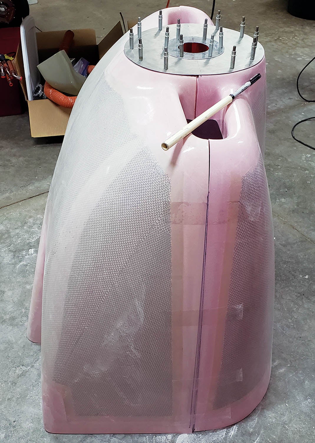

Step 3
rv 7 cowl pt2 03
The nose bowl disc is Clecoed to the top and bottom cowl nose bowl. The long object is a Sharpie inserted into a piece of PVC pipe. It comes in handy for marking the inside of the cowl.
This is important! Do not trim the side seams or the firewall edge of the cowl yet!
Set the cowl down on the floor, nose bowl up, with the nose bowl parts together. Get a six-pack of beer. Stare at the cowl. Drink. Stare. Drink. Eventually, the brain will click or you’ll pass out. Kidding, of course. Every cowl is different, so I can’t help make it perfect, but I can offer some sequencing advice.

Grab a Sharpie. We need a centerline fore and aft, from nose bowl to firewall, on both the top and bottom cowls. Unfortunately, the cowls are basically round and finding center is tricky. I found my wife’s sewing tape very useful for measuring the curved surfaces. Measure from a side edge to the opposite side edge. Make a tick mark at the halfway point. Repeat several times. Connect the tick marks. The resulting line should intersect most of the tick marks and will be adequate for our needs. It’s kind of like herding cats.

Place the cowl on the floor, nose bowl up. Assemble the top and bottom cowl halves so the cowl nose bowl fits together. The sides of the cowls will probably overlap. That’s OK. The upper and lower halves of the nose bowl should form a horizontal horizon line at the nose bowl. It may intersect the lateral center of the crankshaft, or it may be a little above or below. If above or below the crankshaft centerline, it won’t matter. It’s more important that the nose bowl matches the spinner. The horizon line won’t be noticeable. I’m not quite that OCD so I left mine alone.

Tape the cowl halves together along the sides. Lay the nose bowl disc on the cowl nose bowl. Center the disc to the nose bowl top and bottom centerlines. If the horizon line matches up, consider yourself lucky and go buy a lotto. Make sure the TDC mark on the nose bowl disc is at the top with the pre-drawn centerline. That way it can be removed and replaced right where it was drilled. Align the horizon line as best you can, but don’t get crazy. Ideally, you want the disc centered and aligned to the top and bottom centerlines. Match drill the holes in the nose bowl disc to the cowl nose bowl and Cleco.
