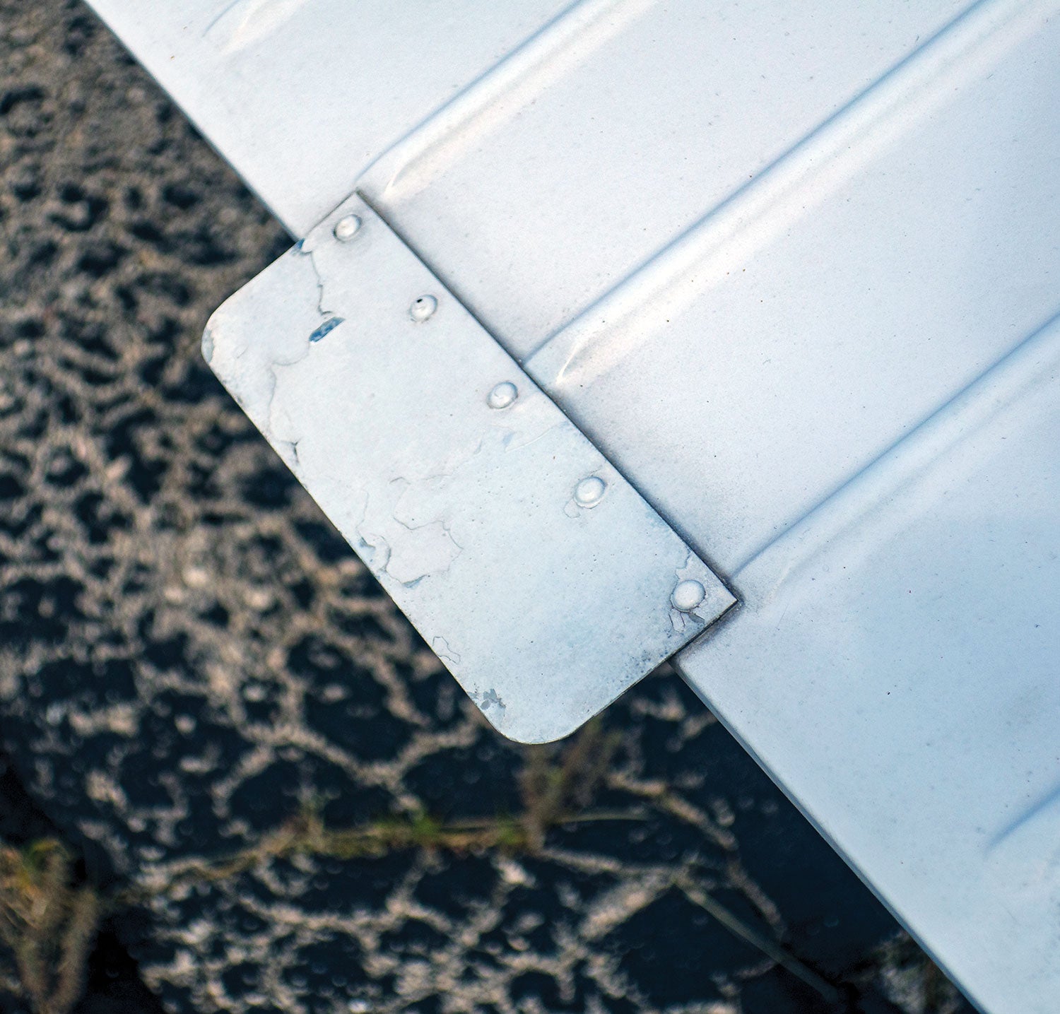

Trim tabs don’t have to look like afterthoughts (left), nor do they need to protrude beyond the control surface and draw attention to themselves (right).

Trim tabs come in many flavors. The metal-bashing crowd often defaults to a hand-bent piece of aluminum. Yes, it’s easy, but I find them crude. I put too much effort into Metal Illness to encumber it with ugly trim tabs so I formed mine on a brake and installed them flush with the trailing edge of the control surfaces—elegant and mostly invisible. Cast about in the communities for your particular building material (fiberglass, tube and fabric, wood and fabric, metal) to see how builders have executed their trim tabs. You’ll find a wide variety. Go with the ones that are lightweight and unobtrusive, even if they are a bit more work. Make yours look like it was planned and not a grudgingly applied bandage.
To trim Metal Illness, I began with yaw trim. Using 200-mph tape, I affixed a rudder trim tab I estimated to be oversized. My goal was to trim yaw to allow my feet to leave the rudder pedals (mostly) unattended during cross-countries. Flight after flight, I whittled away the trim tab until the nose remained pointed on a heading with the wings held level. After the tab’s size was established I riveted it to the rudder.
I established roll trim in much the same way. I wanted Metal Illness trimmed for solo cross-countries so I carried some weight in the passenger seat to simulate luggage, which also helped compensate for two-up flight. I whittled material off the oversized aileron trim tab until the wings remained level at cruise speed without noticeable effort. Neutrally stable aircraft, like many in the Van’s and Sonex families of designs, will never fly hands-off for long, but they shouldn’t need to be aggressively reigned in at all times, either.
Trim tabs are par for the course on light aircraft. If you see a homebuilt without rudder or aileron tabs, you may be looking at an airplane whose owner is flying it out of trim or that was built crooked and, by coincidence, was built just crooked enough to introduce the aerodynamic forces needed to make it fly straight. Luck or irony, that. Don’t think of trim tabs as a failure. Think of them as one of the last steps in completing your aircraft and a ticket to more effortless flight.
