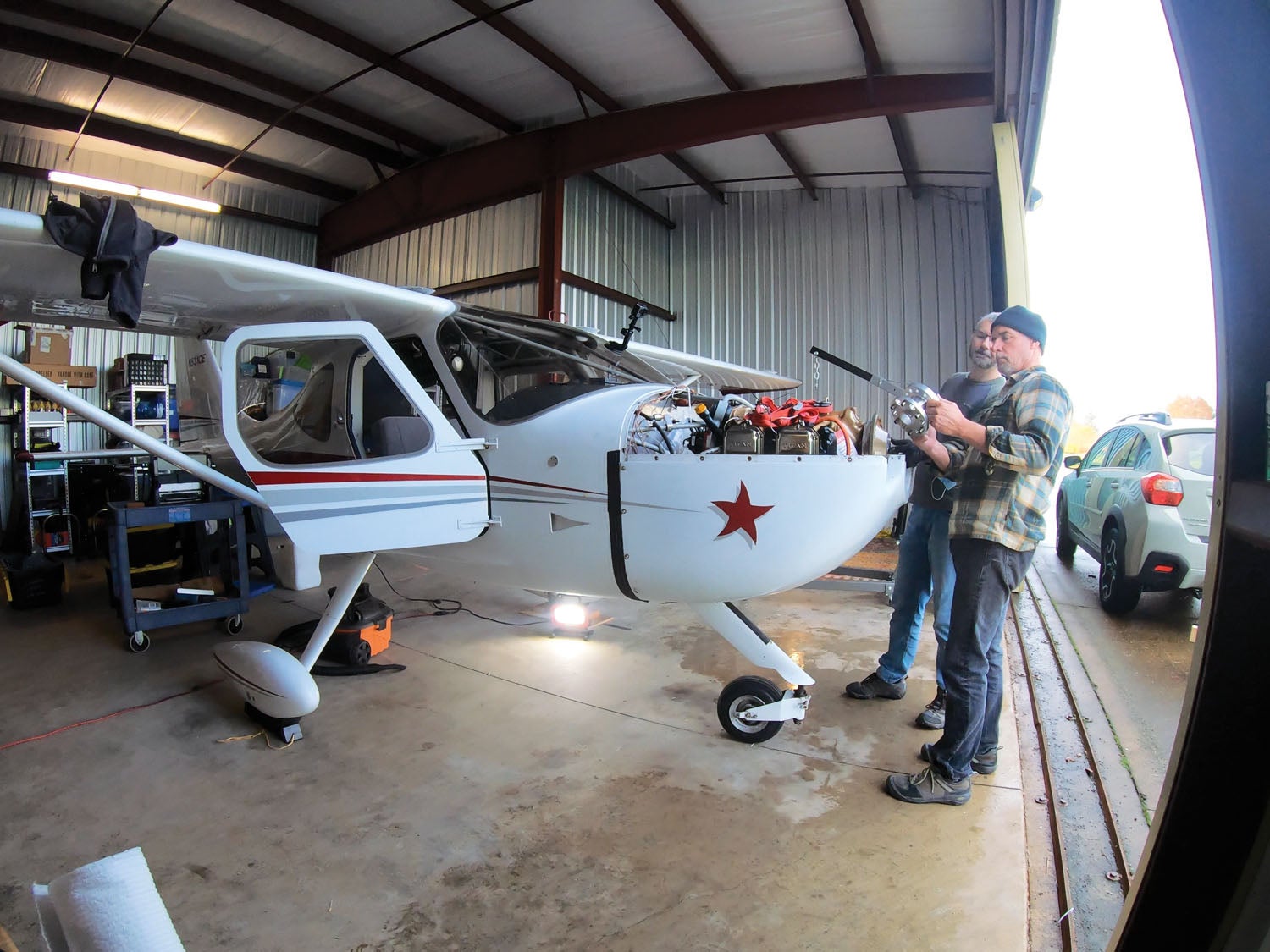

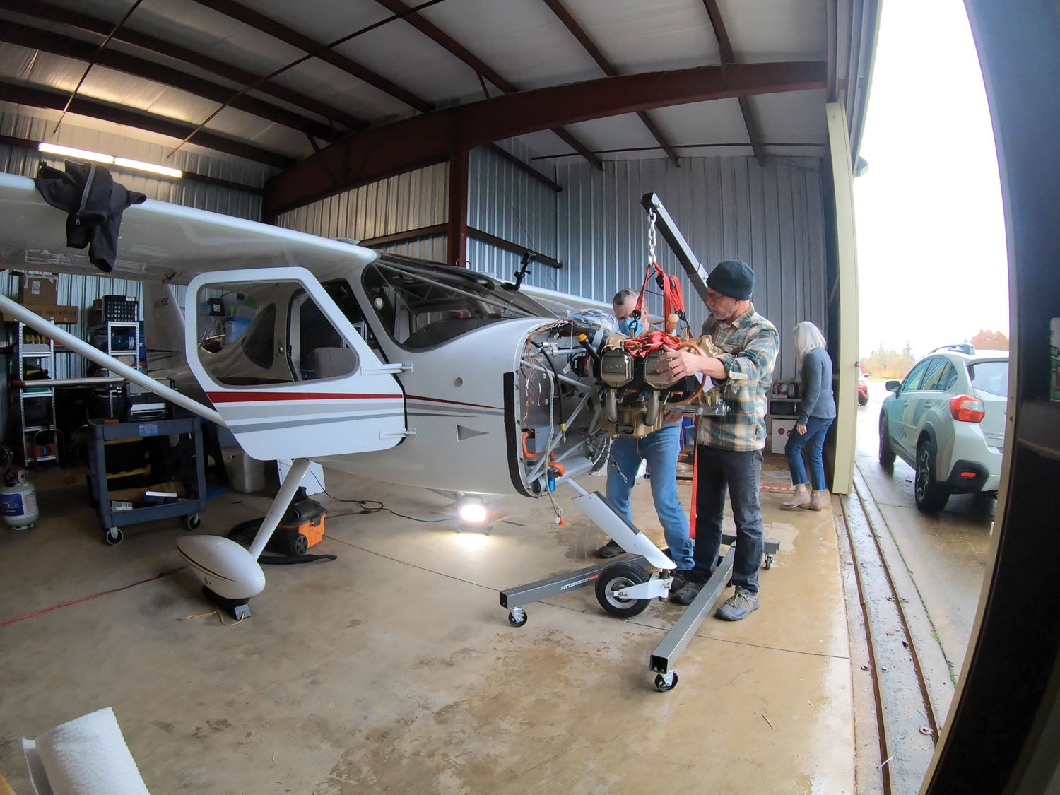

titan 340 install 11My next-door hangar neighbor, GlaStar builder and KITPLANES® web manager, Omar Filipovic, had already cast his steely gaze upon the Titan IO-340 hanging from my GlaStar’s nose. A few days before “the event,” I had mechanic friend Will Steenrod pop over to provide another set of eyes. His expertise involves cars and motorcycles—as a factory-trained wrench for multiple brands—but I know him to be meticulous and curious. He could be counted on to apply a critical eye to my work without preconceptions about how stuff is “usually” done in aviation.

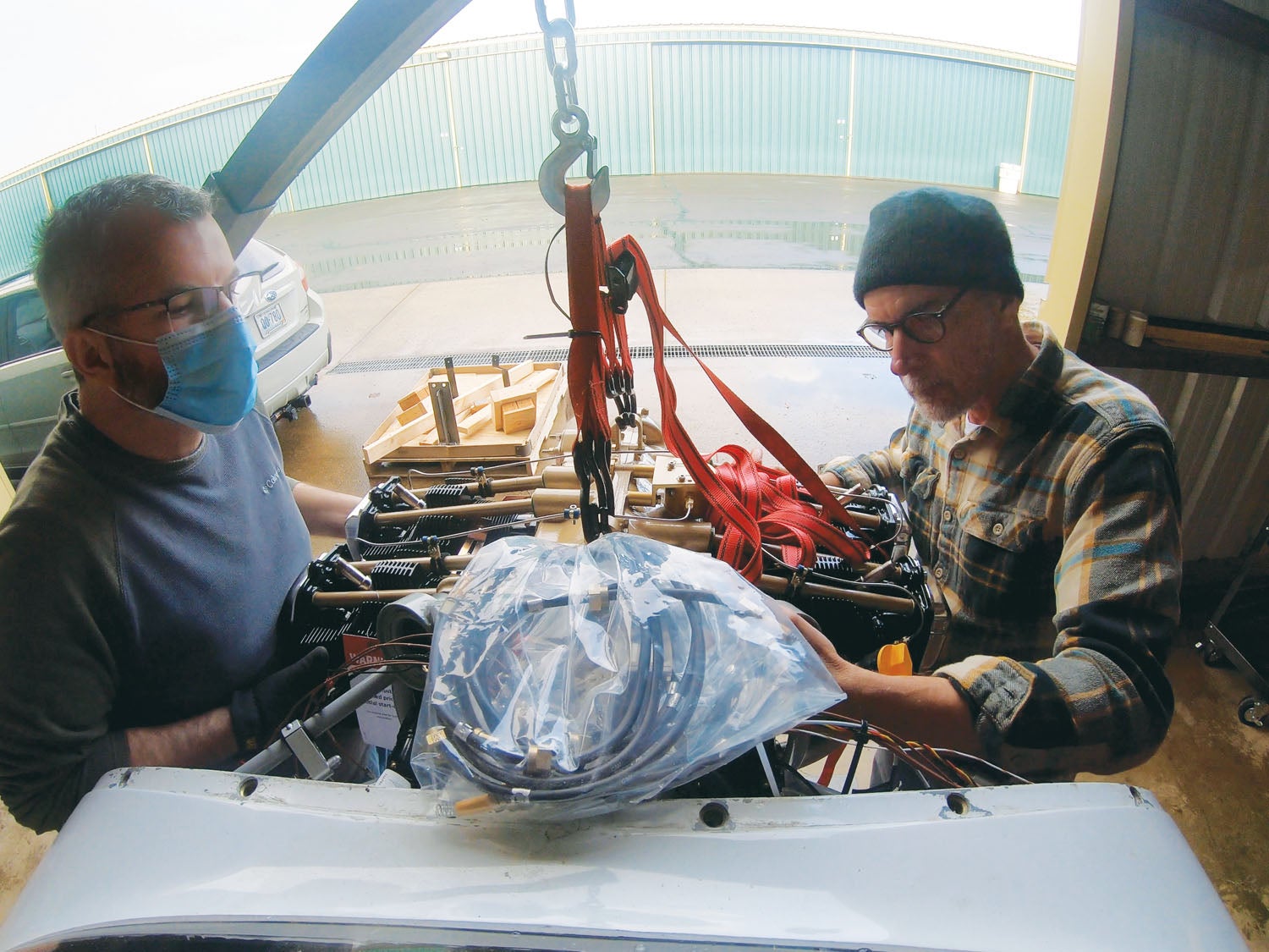

titan 340 install sequence 04

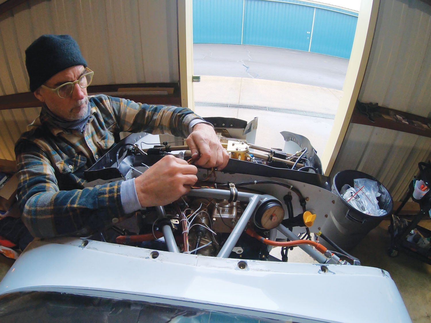

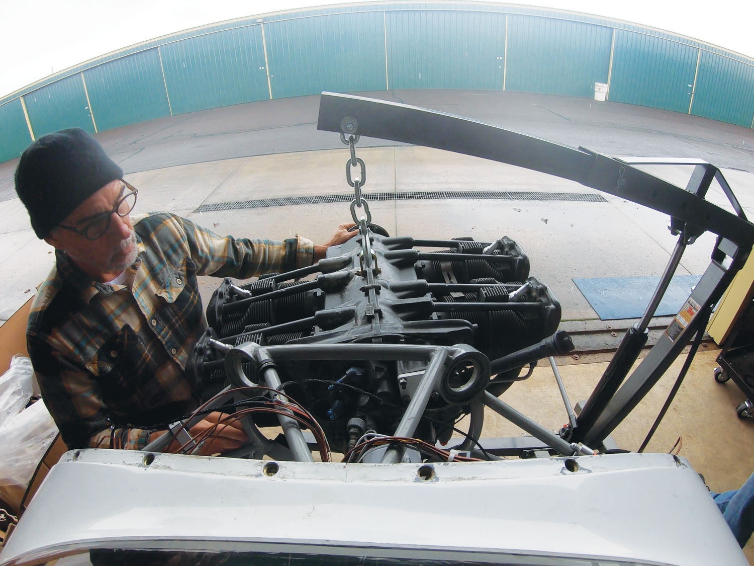

Why is this man holding a hammer? Omar Filipovic (right) helps your EIC fit the new engine mounts to the Titan IO-340. Sometimes strategic force is required.

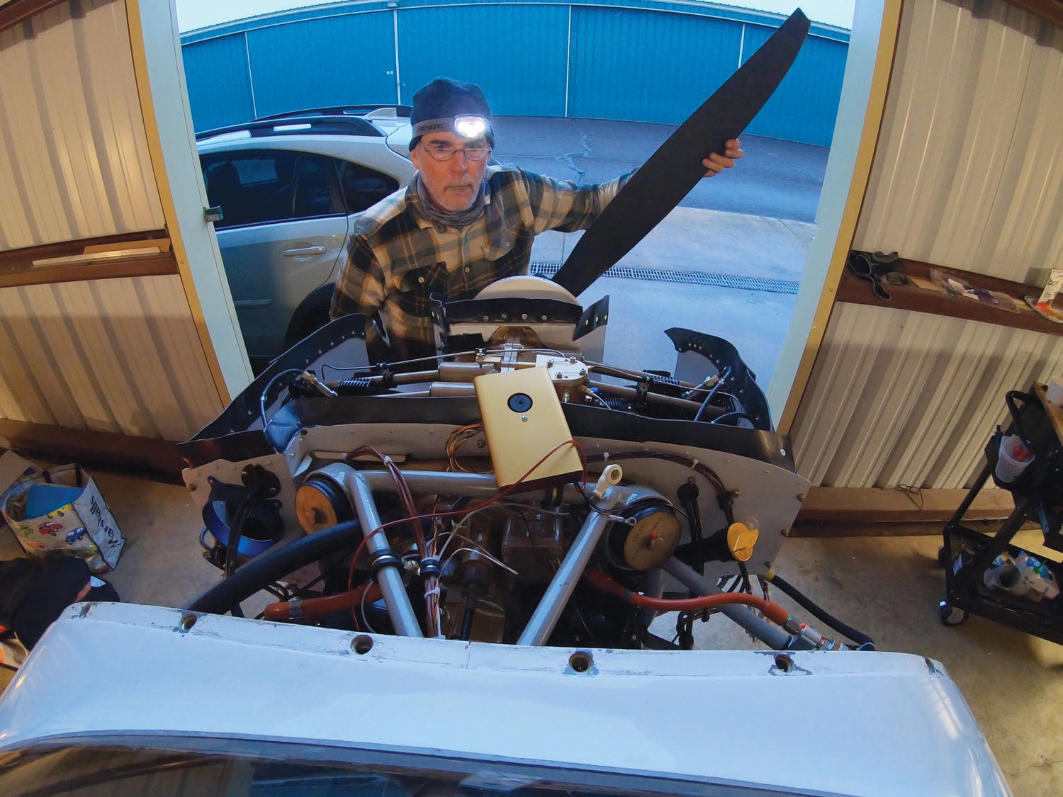

Omar gave me the side-eye, saying, “OK, let’s do it.” I’d reworked all the checklists for the airplane that I keep on ForeFlight a few days before, and so followed the new pre-start items carefully. Finally, master switch on, throttle full open, mixture rich, boost pump for 3-4 seconds to prime and then off. Close and then crack the throttle, and reach for the key. One more look outside to be sure Omar had the extinguisher handy. Thumbs up. I pressed the toe brakes just a little harder.
Twist the key. The lightweight Sensenich prop turned much more quickly than I’d expected, and after a few blades the engine caught and ran. No huffing or puffing, coughing or sputtering. The engine was running smoothly. I switched the avionics on as quickly as I could so the engine monitor would come alive and I could read the Titan’s vitals. The start-up screen cleared and there it was: oil pressure in high green, CHTs and EGTs all uniformly coming up. Fuel pressure steady at 32 psi. Oil temp starting to react. I looked outside again and saw Omar walking carefully around, kneeling to see the bottom end of the uncowled engine, then standing to find a new vantage point. After 30 or 40 seconds of familiar four-cylinder noise, no smoke and no flame—I began to breathe again.

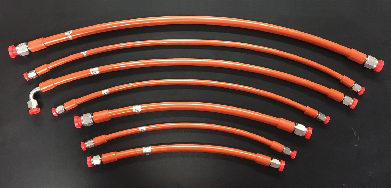

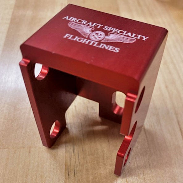

With the fixed and flexible baffling in place, I started systems integration. I decided to work somewhat system by system, starting by mounting the Airflow Systems 2006X, 13-row oil cooler to my firewall mount and mocking up the hose routing. By the time I had the fuel lines, heater ducting and both oil lines run in this small sliver of space on the lower third of the pilot’s side firewall, there wasn’t much room. However, it did all fit, and some judicious clocking of the 90° fittings on the oil cooler ensured clearance. I then connected the fuel system with a set of TS Flightlines hoses from the new boost pump on the firewall. The Titan comes with the hoses between the engine-driven pump and the servo, and the line from the Airflow Performance servo up to the flow divider, but I also added a fuel-pressure pickoff right at the exit of the mechanical fuel pump. Van’s Aircraft sells a proper 90° fuel-pump fitting that ends in a dash-6 AN nipple that also has a 1/8-inch NPT port for grabbing fuel pressure. A 45° fitting from there to a short line up to a really lovely Show Planes transducer clamp finished the job. I used a second Show Planes mount for the oil pressure sender on the other side.
titan 340 install 15
Show Planes’ billet sensor mount was used between the TS Flightlines hoses and the Dynon sensor for fuel and oil pressure (shown here).

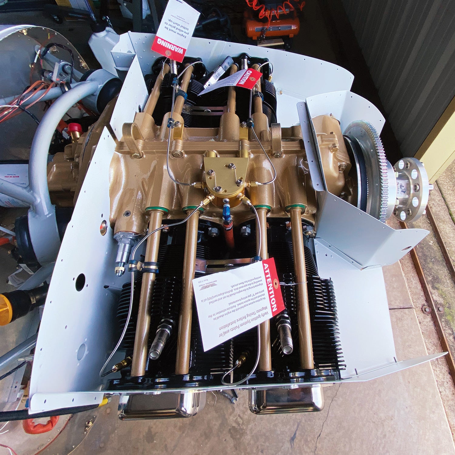

Continental Aerospace Technologies Titan Build Cylinder groups
Titan’s parallel-valve cylinder uses tapered fins on the barrel for weight savings—fine since they don’t see a lot of heat down there. But you do have to modify the baffles.
