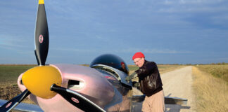

lycoming overhaul pt4 16
Make sure that you treat the first flight of a new engine with serious concentration—be prepared for emergencies and have a plan (left). Minimize taxi time to keep temperatures down before that first takeoff (right).
