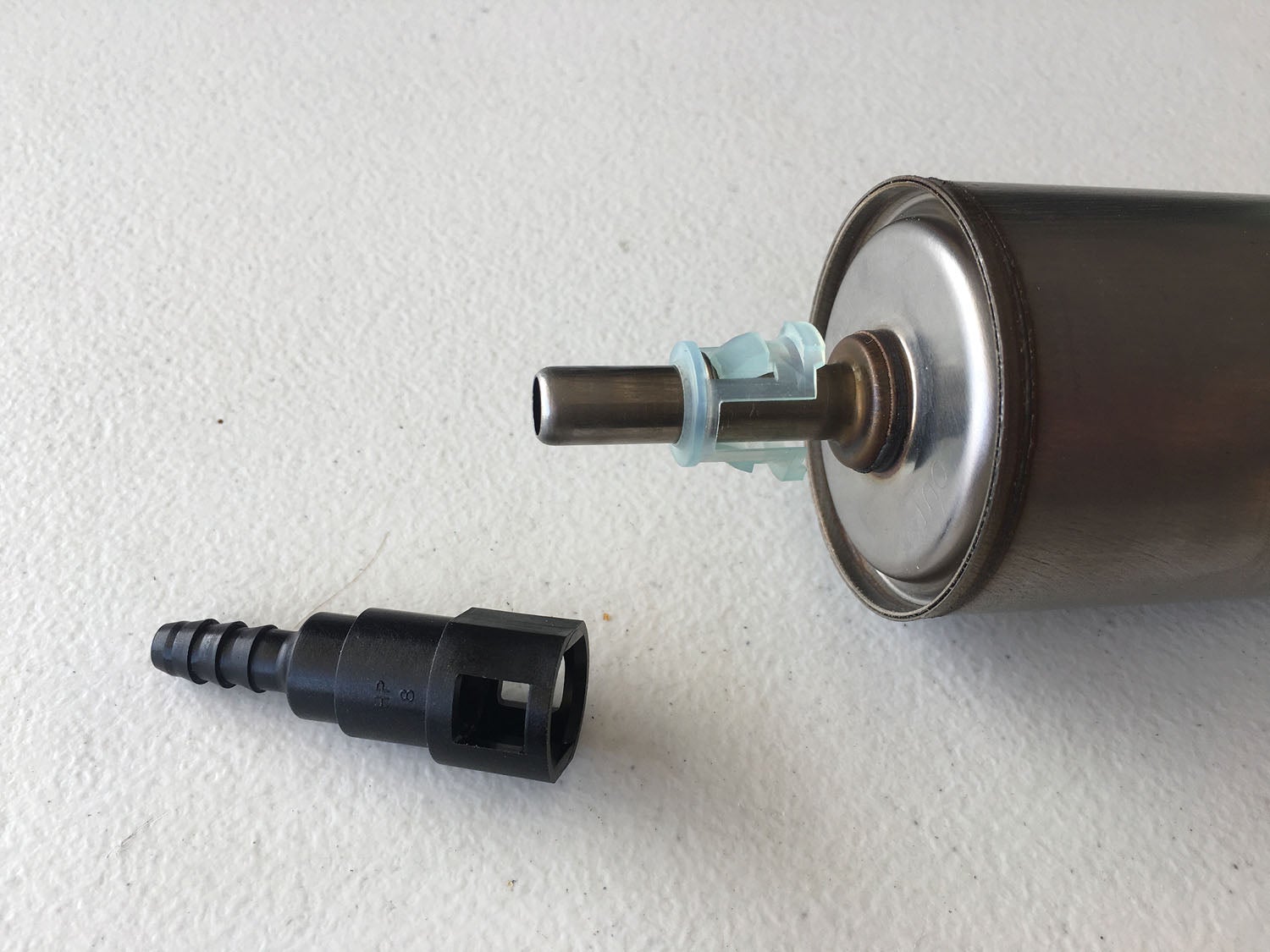

Fuel filter hose stems have a ridge located ¾ inch from the end. The translucent clip on the quick-connect fitting attaches to this ridge, and the barbed end of the fitting connects to the fuel hose.

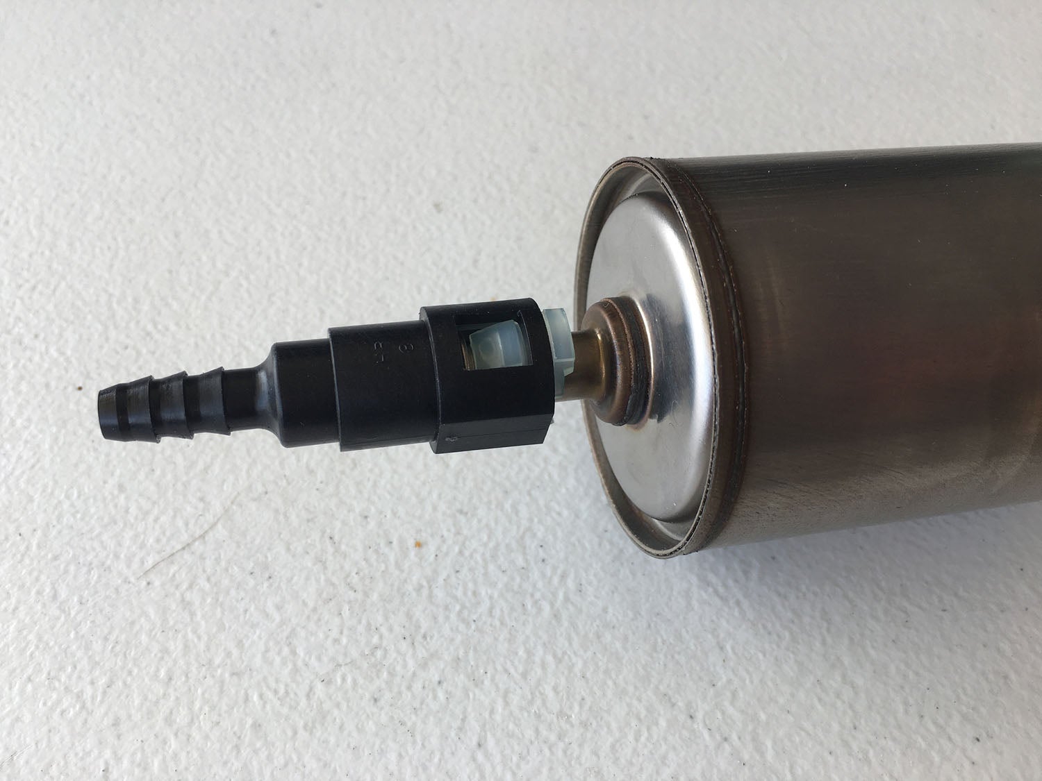

The quick-connect fitting locks into place with a “click” when pressed onto the stem of the fuel filter. To unlock the fitting, simply press the two tabs of the clip inward and pull the fitting off.

Three components make up the quick-connect fuel filter system: a quick-connect fuel filter, a quick-connect fitting and the associated clip.
Fuel filter hose stems have a ridge located 3/4 inch from the end. This is in contrast to the barbed stems we use with clamps. These filters can be purchased at local auto parts stores, online auto speed shops or Amazon.com.
Quick-connect fittings have a translucent clip on one end that mates with the ridge on the fuel filter’s hose stem. The fitting’s other end has a barbed stem that attaches to the fuel hose with a clamp of your choice.
The fitting locks into place on the fuel filter with a “click” when it is pressed onto the stem. To unlock the quick-connect fitting for removal, simply press the two tabs of the clip inward and pull the fitting off. Note that the translucent clip will remain on the filter stem after removing the fitting.
The quick-connect fitting can be reattached to the filter or removed later with little effort. When the filter is eventually due for changing, the clips on both ends can be easily removed with a screwdriver for reuse with the new filter.
