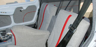

Having every part of the family contribute to Scrappy was one of Danny’s goals. Going for a classic Cub look, and with a passion for dark cherry wood, Danny turned to his wife, daughter and daughters-in-law, all interior decorators. "With so much wood inside, the girls told us it was gonna be dark," so the airplane was painted white, inside and out. Carrying the theme forward, Scrappy would soon wear a Culver Prop stained dark cherry. Danny’s Uncle Jim was making cherry stick grips, but he succumbed to a heart attack before finishing the set. Kenneth has kept the grips in memory of Jim.
Picky about matching colors, Danny said his dad couldn’t find vinyl that matched the airplane’s red trim, so he went with black vinyl and houndstooth fabric. The black vinyl panel aft of the baggage compartment not only displays Scrappy’s embroidered image and name, it hides a boo-boo with the paint, a run. Also located out of sight were baggage compartment pockets for a fuel tester, quart of oil, and Kenneth’s logbook.
