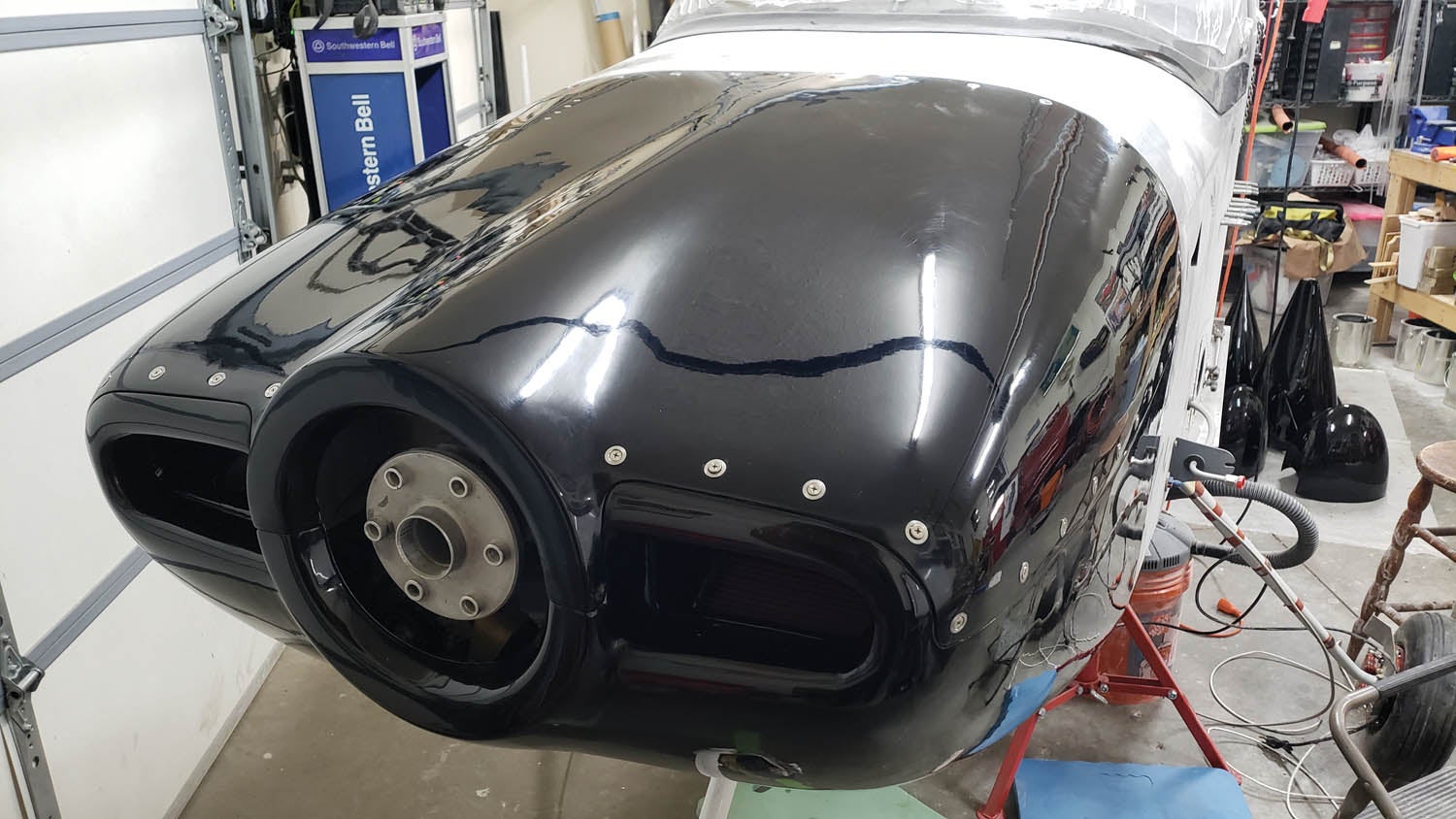

ez cowl jig pt1 07Time to start the Cowl? It’s one of the biggest milestones and ranks right up there with the canopy. Don’t fret. There are tips and tricks to make it a little less painful.
My mentor, Dave Paule, tipped me off to a neat jig designed by David Howe. David fabricates a bunch of cool RV gadgets, and his EZ-COWL jig is a very useful tool. It functions as an extension of the engine crankshaft, making it easy to set up the cowl perfectly aligned on the engine thrust line. It also holds the cowl in position to make trimming much easier. I highly recommend it!

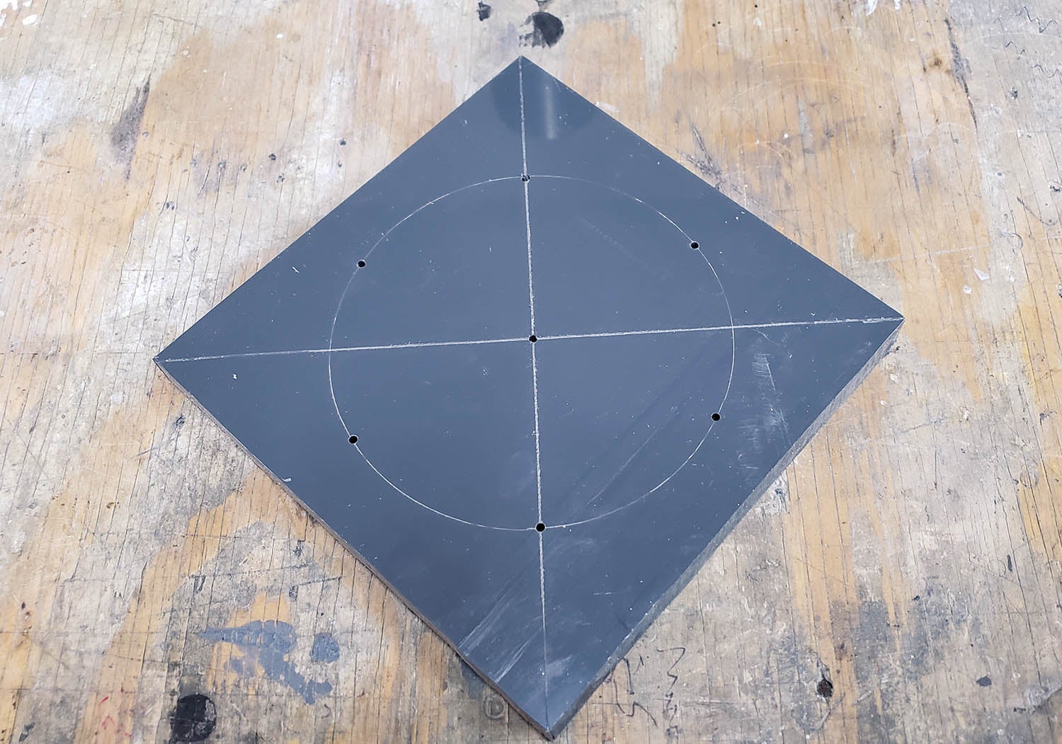

Cut a 6×6-inch piece from the big sheet of flat PVC. Mark a center point on the 6×6-inch piece. It’s square so just connect the corners. The intersection is the center.
Step 6
Use a compass to scribe a circle 23/8 inches from center. Use the template to set the compass. The scribed circle is where the crankshaft prop flange lug holes will be located. Check yours to be certain of the dimension and scribe accordingly.
Step 7
Scribe another circle aligned to the 6-inch edge. That will give you a nice round piece. The outer round shape is optional; the square shape works just fine.
Step 8
Two holes should already be located along one of the center lines. The other four can be located using the template. Lay the template on the flat piece of PVC and align the center of the drawing with the center of the part. Rotate the drawing until the line on the drawing and two predetermined holes are in alignment to the line on the part. Tape the drawing in place.
Step 9
Center punch the six hole locations through the template. Drill the center hole and six flange holes #40.

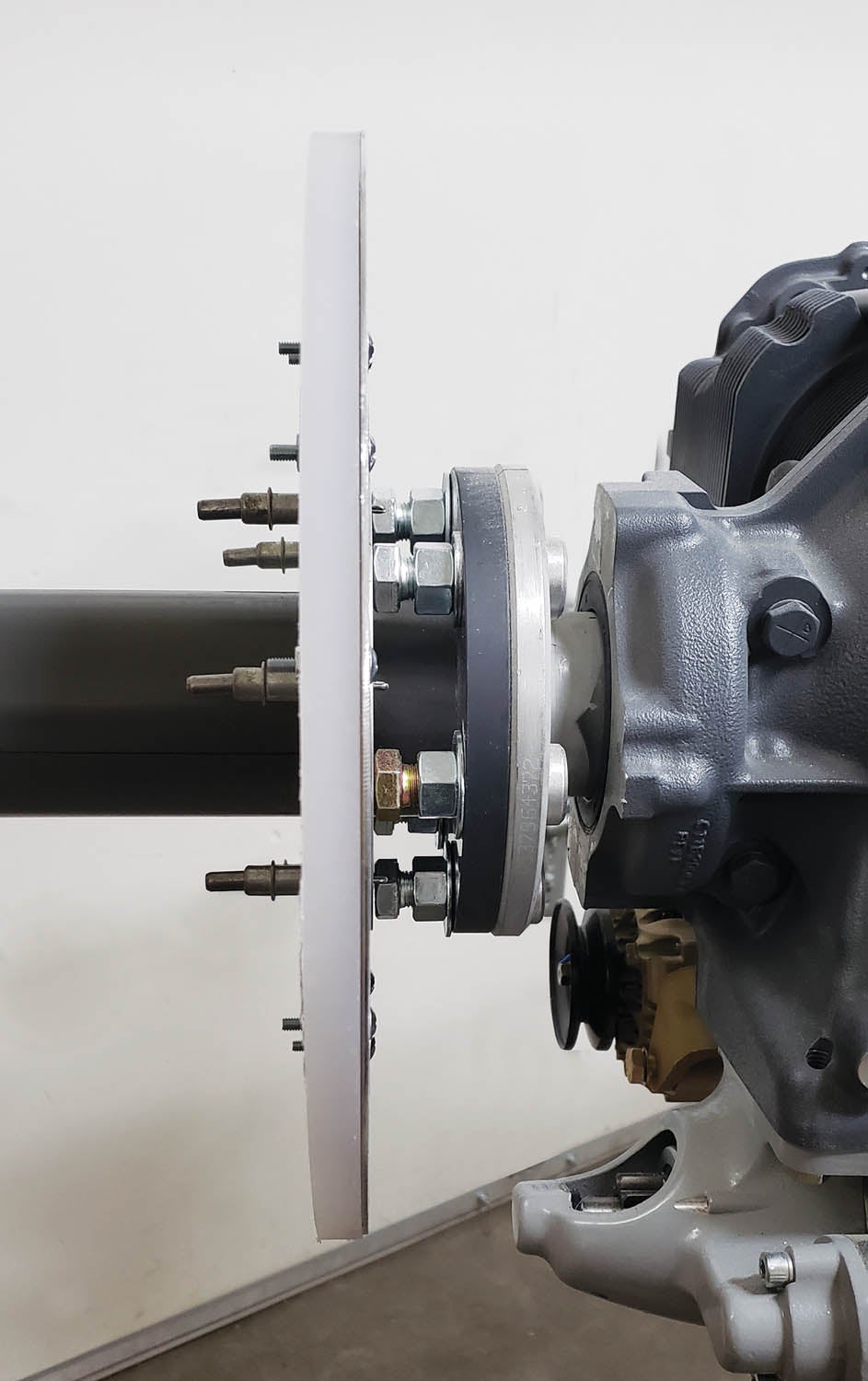

The nose bowl disc diameter is important! It needs to be the same diameter as the cowl nose bowl and spinner flange. If you’re building an RV-7/7A, it’s probably 13 inches.
The nose bowl disc functions as a plate to hold the nose bowl of the cowl halves together flush. It also allows the assembly to be positioned and locked to the center of the crankshaft.

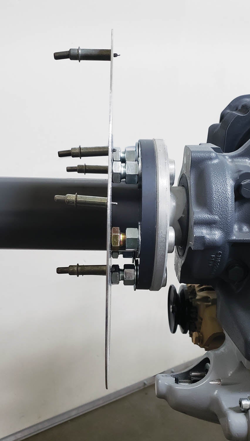

Step 17
Next, cut the nose bowl disc. Either 0.040- or 0.063-inch aluminum is thick enough so it doesn’t flex too much.
Cut the aluminum 14×14 inches wide. Scribe center lines from corner to corner and side to side exactly one-half the width in both directions. Scribe lines are OK because the nose bowl disc won’t be structural, and we don’t want the markings rubbing off.

Next up is mounting the jig. Check your prop drawing carefully. Look for the gap dimension between the spinner and cowl. The spinner-cowl gap will vary with the prop manufacturer and personal preference. Call the manufacturer and ask. Too narrow and the spinner may contact the cowl when the engine shakes.
Here’s the formula I used to calculate the dimension to set the jig bolts. The starting dimension (provided by the prop manufacturer) is from the back of the spinner to the face of the flywheel. The formula calculates the distance from the jig face to the bolt head. When the cowl is positioned over the jig, the nose bowl disc will touch the bolt heads, and the cowl nose bowl will be in the correct position to ensure a uniform spinner-to-cowl gap.
A (jig spacing) =
Prop spinner to flywheel gap (1.62 inch)
+ Flywheel thickness (0.250 inch)
– Jig thickness (0.490 inch)
– Spinner to cowl gap (0.375 inch)
(Note: There are other ways to locate this position, but this worked for me. David uses a different method in the instructions that come with his jig.)

Step 28
The flywheel is removed for convenience, so remember the thickness. (Mine is 0.250 inch thick). Do the math and figure out the distance from the forward side of the jig face to the aft side of the nose bowl disc. My distance, planning for a 3/8-inch spinner-to-cowl gap, worked out to 1.005 inch.
Whirl Wind Propellers recommended the 3/8-inch space to accommodate engine vibration. The space can be easily adjusted with filler, but it’s much more difficult to increase the gap, so consider this carefully.

Step 29
ez cowl jig pt1 02
Adjust the bolt heads so the nose bowl disc is the correct distance from the jig face.
Remember the bolts we needed to bolt the jig to the crankshaft? Here’s where the length of the bolts becomes important. Spin a nut and washer on each of the six bolts. Install the cowl jig with the bolts. Set the bolt heads so the surfaces of the bolt heads are exactly the correct distance from the jig face—1 inch was close enough for mine.
Step 30
Tighten the nuts to lock them in place. Double-check to be sure they’re tight. It takes some tweaking, but when you’re done the nose bowl disc will contact the bolt heads, setting the exact space for the cowl nose bowl.
Step 31
Slip the cowl nose bowl on the cowl jig. Align it so the Clecoes fall between bolts. The plate should be in contact with the bolt heads.
Step 32
Mark the top TDC, so it can go back to the same place. It’s now time to put the cowl together, which we’ll do in Part 2 of this article.
