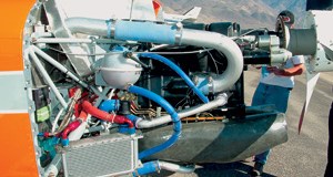

The belt-drive PSRU unit itself lists for $5600. Straightforward in concept, the BAP drive unit is a robust but nicely finished piece that uses a simple belt and cogged gears arrangement to provide a 1.43:1 reduction to its SAE 2 propeller flange (the same one found on a typical Lycoming). The bearings are sealed units, and the only recommended maintenance is the replacement of the one belt every 200 hours or two years, whichever comes first. Meyers says that its also a good idea to replace the small lower nose bearing at that same time. The cost of the belt is right around $200, and its a commonly available item, Meyers said. If the airplane is kept outside, replacing it every 200 hours or so is good.
Other than the economy of $1 per hour of operation, the belt drive offers smooth, quiet operation and a natural immunity to the power pulses of the engine-but this only goes so far. If the unit is subject to backfiring, it can shear or overstress the crank mounting bolts, Meyers said. Its a good idea to make sure you’ve got your timing right first.
experimotive orange
The heart and soul of the Belted Air Power PSRU is a wide rubber belt running between two toothed drums, both thoroughly supported by aluminum plates.
