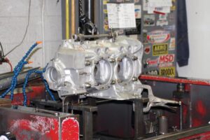

This line-boring machine is where the crank and cam bearing areas are ground back to round. Line boring is necessary if material is taken off the case mating surfaces.
Of course, when you remove material from the mating surfaces of the crankcase, the holes that cross that centerline are no longer exactly round! The answer is called line boring. Line boring takes a large machine and precise placement of the case so that a particularly large bit can clean up both the line of crankshaft journals and those for the camshaft back to their true dimension. Most people who have done a bit of wrenching on engines already know this, but many don’t think of the further implications.
