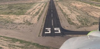

I flew slightly south of the airport and set up for a left downwind because my least obstructed view was out the left side of the canopy. After turning final, the runway depiction on my SkyView primary flight display really helped with flying blind. I put the flight path marker on the runway numbers and drove it in. Of course, the tricky part was the landing. Once over the runway, I descended very slowly and looked repeatedly over my left and right shoulders to make sure I was equidistant from the weeds. Touchdown was uneventful, and oil pressure remained in the green, so I exited the runway and shut down on the ramp.
