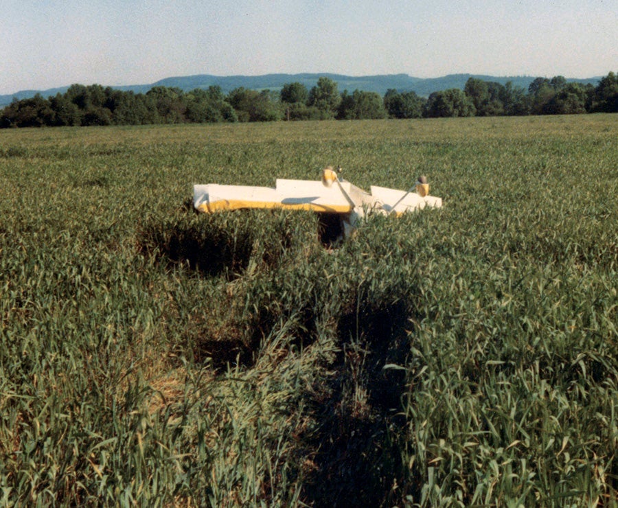

First, I need to back up a month or so and fill in many details that caused this incident and lead to its successful outcome. It all started with whammy #1, when my prototype RV-3 was damaged by “Lefty,” my only employee at the then fledgling Van’s Aircraft Company. It was the summer of 1976 and my one and only (prototype) RV-3 had suffered significant damage when the engine faltered during a touch-and-go landing on the 650-foot airstrip on my parents’ farm where it was based. It had impacted tall grain when it failed to become airborne at the end of the strip, coming to rest inverted about 150 feet farther on in a neighbor’s wheat field. Fortunately, Lefty’s injuries were minor, but this was the beginning of the fly-in and airshow season. I needed to get that plane back in the air ASAP. Fortunately, I was able to borrow my brother Jerry’s RV-3 to use in the interim and fly it in a couple of nearby airshows that I had scheduled. This was one of only a handful of RV-3s that were then completed and flying.

Why had the RV-3 suffered its upside-down indignity in the wheat field at the beginning of this tale of woe? My memory is a bit vague, and I no longer have the engine logs to reference for verification. I believe that the O-290-G engine in the RV-3 at the time was equipped with a Lake Throttle Body Injector, rather than a Marvel MA-3SPA carb that is normally used on the Lycoming O-290 engine. The Lake TBI was an inexpensive aftermarket product that I had installed as an affordable alternative to a conventional fuel injection system that would support inverted flight operation. The Lake Injector worked OK but, at least in my application, had a non-linear fuel/air mixture at different power settings. I had learned to automatically reset the mixture along with power changes. Being less experienced, Lefty apparently wasn’t able to react as quickly, thus causing a power disruption and the unsuccessful touch-and-go. He had only recently been checked out (single seat check-out?) in the RV-3, and in retrospect, was underqualified to fly from such a short airstrip. I shouldn’t have assumed that he would be able to master the unique airplane and airstrip that had become second nature to me.
