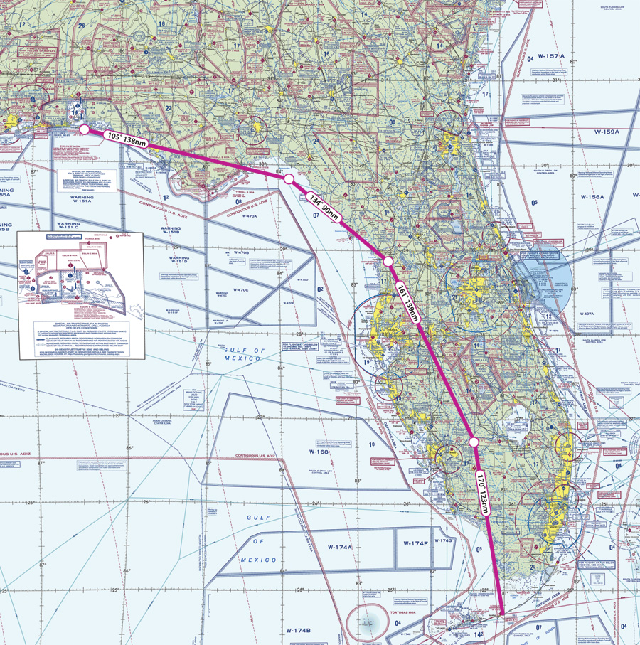

The incident flight was planned from Destin, Florida (DTS) to Key West roughly following the coastline. The late December morning weather was IFR at DTS, with areas of low ceilings and light rain/mist with a few isolated patches of moderate/heavy rain. As the morning wore on, I watched this narrow system slide across the airport and move east. I compared the radar imagery on the iPad with what I saw out the window and decided that it wasn’t that bad, and I should be able to pick my way through and remain VFR.
VFR flight from Destin, Florida, to Key West. Estimated time en route was 2.8 hours.

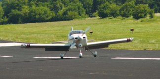

DTS was VFR around noon, so my wife and I boarded our Harmon Rocket II, confident in the knowledge I could turn around and return if needed. The Rocket is a strong performer, but this particular example is not equipped for IMC with only a single EFIS as an attitude reference. This lack of redundancy was not a concern as I intended to remain strictly visual, and I’m not instrument rated anyway. Per procedure, I contacted ATC, received a squawk code prior to departure, and established radar contact immediately after takeoff. ATC asked for my normal cruise altitude and I responded, “7500 after I pass under the weather.” ATC acknowledged and instructed me to remain VFR. I engaged the autopilot and focused on managing the aircraft, traffic, and weather. Initial cruise under occasional rain showers was accomplished just as expected—slightly challenging, but VFR.
The panel included useful VFR instrumentation—but no real backups for IMC flight.
