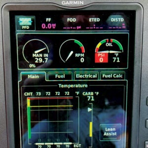

garmin engine monitor
Here’s an example of Garmin’s EIS displayed on an entry-level G3X Touch EFIS display. For aging eyes, the ability to spread out all of the data easily bests a small-screen standalone engine monitor.

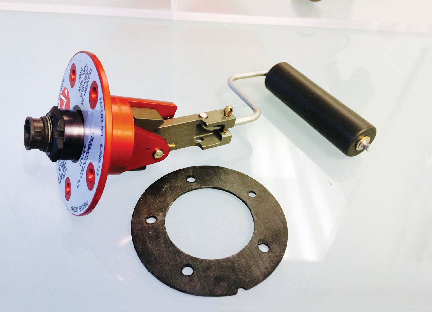

CIES digital senders
CIES digital fuel senders have proven accuracy over aging analog senders.
“You are talking about measuring millivolts from the senders. In the case of CIES frequency senders, a direct connection to the ground wire of the sender to P6 harness is made,” he advised.

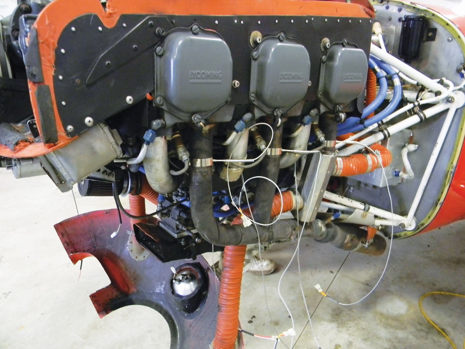

Engine probe install Lyc
When it comes to engine sensors and probes, follow the installation manual carefully, while routing wires away from areas where they could strain, chafe or burn. Always use fire sleeving on fuel connectors.
A better source, according to Team X, is the interconnect diagram, which is a visual wiring diagram that shows the sensor and all of its associated wiring, so there’s no guesswork. And get your specific engine right—Garmin has sensor wiring examples for Lycoming, Continental, Rotax and Jabiru engines, with a drawing for UL Power FADEC as well. On a side note, in the early gen G3X engine monitor product, Garmin used high-density contact pins—notoriously difficult for amateurs to work with—but they’ve since been changed to standard-density pins. Garmin said that when making the transition to the newer system (it uses a different EIS module—the GEA 24), installers shouldn’t have to re-pin the entire system end to end.

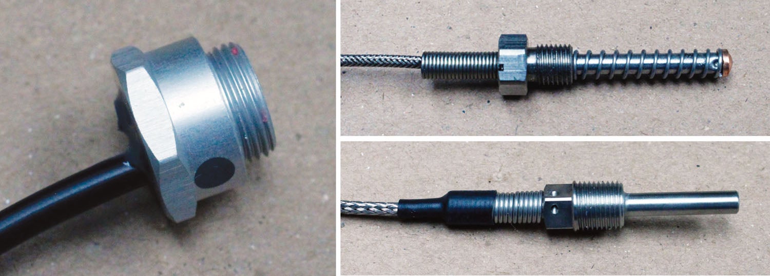

engine monitors probes
Clockwise from left: An rpm sensor, cylinder head temp sensor and a carburetor temperature probe—all used in JPI engine monitor installs. These are high-quality and highly accurate when installed properly.
As for individual probes and sensors, engine manufacturers will usually have guidance for physical installation of their required or recommended sensors. Thankfully, Garmin provides fairly detailed general guidance for installing sensors it sells in the G3X Touch installation manual. You’ll find it in Section 24, under the Engine/Airframe Sensor Installation subhead. There may be some flexibility to use third-party sensors. Many temperature probes (CHT, EGT and oil temp) are classified as a certain type of thermocouple, and even Garmin’s EIS will read any standard Type K or Type J probe for most applications. Also, the G3X works with several different brands of fuel flow indicators (Electronics International and FloScan, to name two). For new installations, Garmin’s kits will get you started for major items like EGT/CHT and pressure sensors, but you may have some probes that come with the engine or other probes that you source. They might work—but the manual is the final authority.

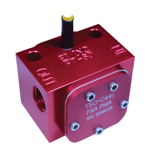

FT 60 transducer
Electronics International says the Red Cube FT-60 is more accurate and less susceptible to debris than other fuel flow transducers.
Electronics International says its Red Cube FT-60 fuel transducer has considerably less pressure drop than other units on the market, and a blocked rotor does not affect pressure drop. The overall accuracy and linearity of the Red Cube FT-60 is superior to most other flow transducers, too. The Red Cube FT-60’s design vacates bubbles and is not nearly as susceptible to debris as other units. Garmin says that EI’s transducers are used in some of its EIS applications.

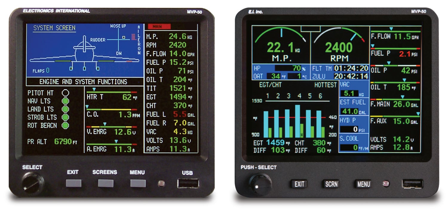

ei mvp engine monitors
The Electronics International MVP-50P is more of a systems monitor than engine monitor. We especially like its ability to monitor lighting, flaps, landing gear and pitch configuration, to name a few functions.
There are two specific models that are the most popular for Experimentals. One is the non-certified version of the big-screen MVP-50P.
As standalone monitors go, the MVP-50P is big—5.6 inches wide, 5.2 inches high and 2.4 inches deep—and mounts from behind the instrument panel, which means the TFT color screen sits flush. It isn’t a touchscreen. There are multiple components including MVP display, engine data converter (EDC-33P), the engine probes, transducers and modules, and the wiring and extension cables. The EDC is a smart box, converting raw probe and sensor inputs to serial data, which is then provided to the MVP-50P via two-wire RS-422.
This system is more than an engine and fuel monitor. Think of it as a systems monitor, with lots of data sprawled out on various pages. We especially like the System page and its ability to see the disposition of the landing gear (on retracs) and flaps configuration. As much as we like this system, we think it’s about time for an upgrade to touchscreen.

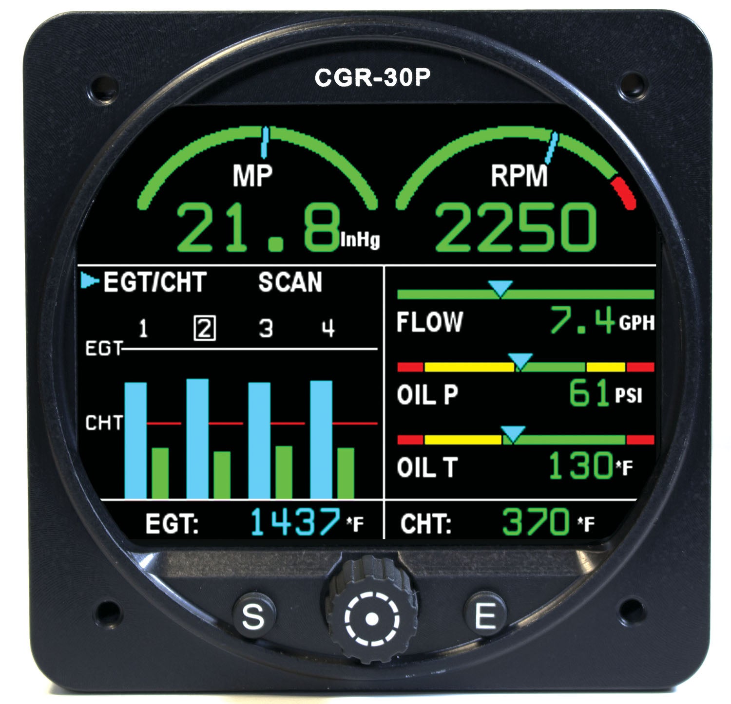

CGR30P home screen
We like the Electronics International CGR-30P for its high-quality display, configurable feature set and fair price point.
The EI CGR-30P is an easier install since it fits in a 3-1/8-inch instrument cutout. The system comes standard to display rpm, EGT/CHT bar graph, fuel remaining, tach time, local time, fuel used, GPS/fuel flow data, external caution and warning, and data recording. You can also choose five additional parameters from the list of manifold pressure, oil pressure, oil temperature, fuel flow, fuel pressure, fuel level (left and right tank), aux fuel level, TIT, carbon monoxide detector (a $495 option), vacuum and volts. The CGR also has a fuel totalizer and can monitor fuel quantity. It’s smart enough to know which fuel tank you are drawing from and can estimate how much fuel is remaining in each. A nifty on-screen graphic depicts the total fuel remaining in all tanks.

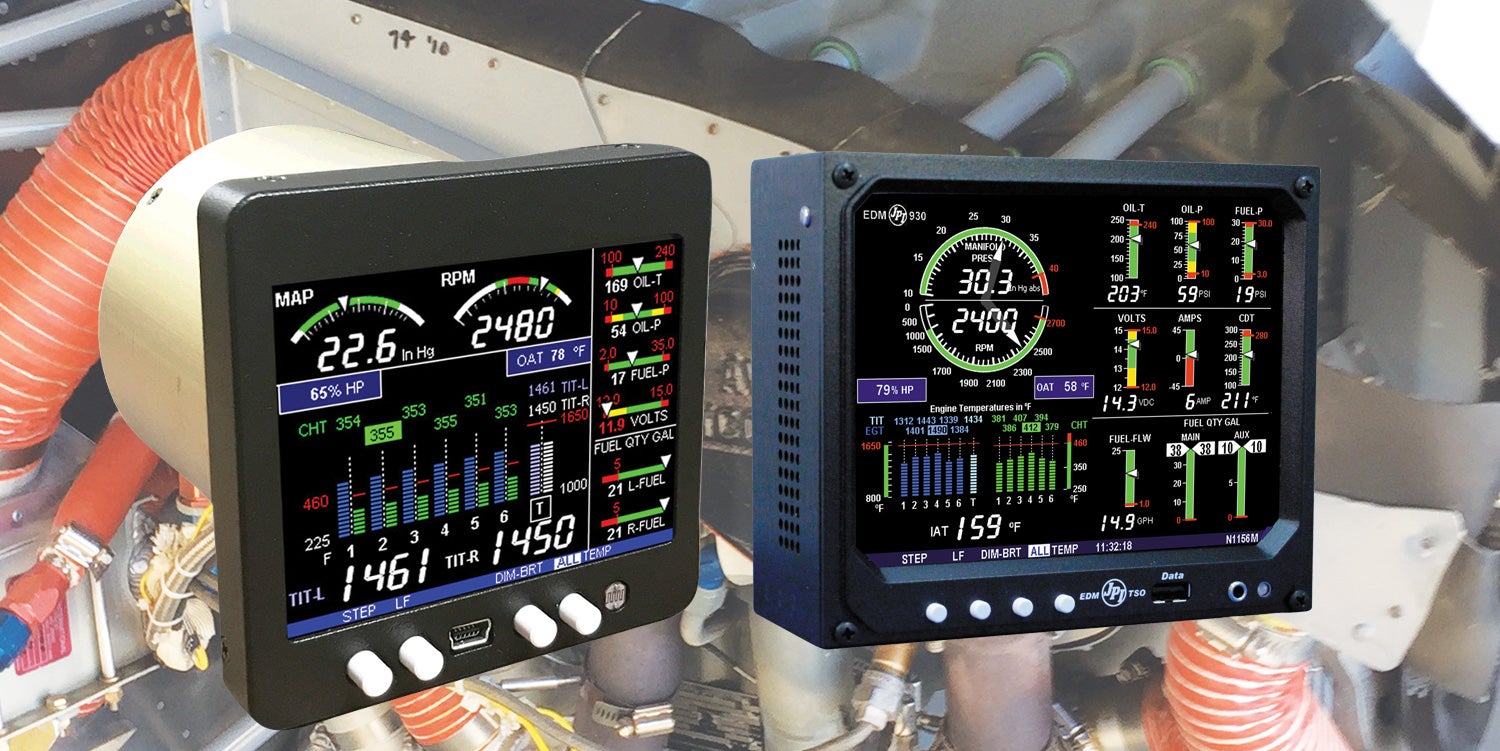

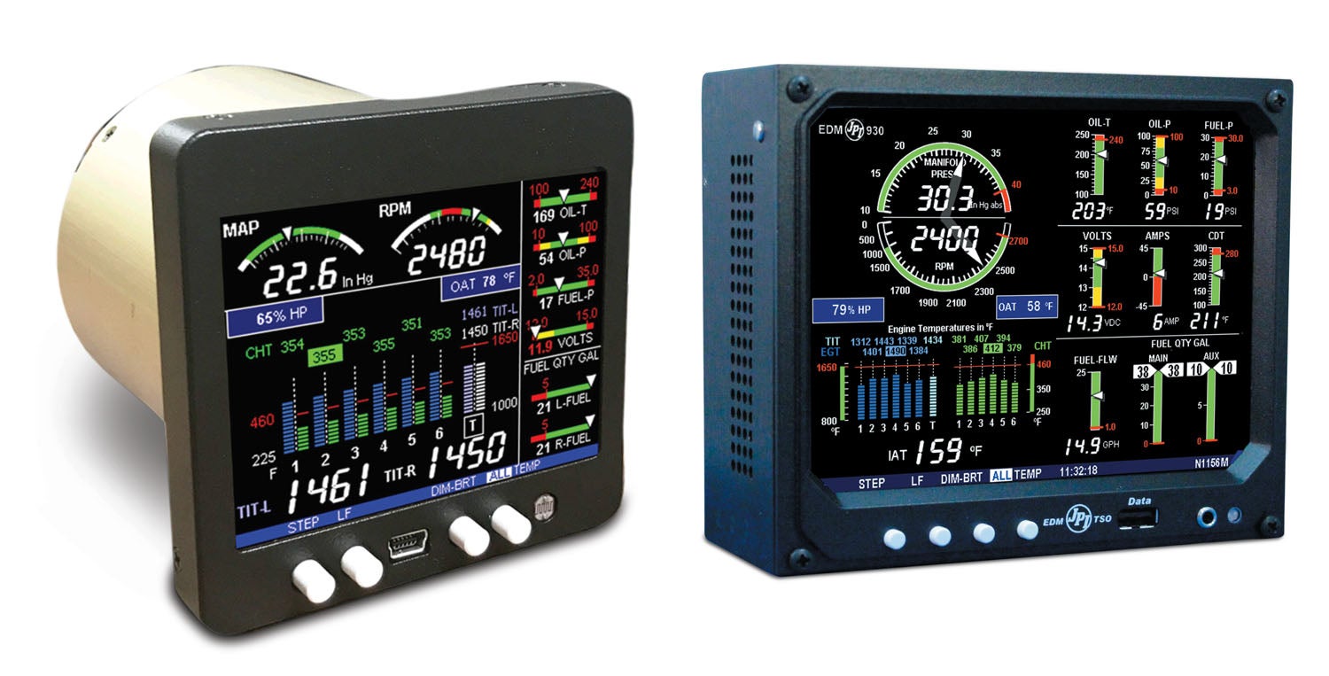

jpi edm engine monitors
JPI’s EDM-350 (left) and EDM-930 are both full-featured monitors that trickle down from the company’s
flagship monitors. They have proven reliability and the sensors can be ordered to fit a wide variety of engines.
JP Instruments
In a recent interview, JP Instruments said the Experimental-focused EDM-350 represents only 5% to 10% of JPI sales and seems focused on the certified market. Still, at a time when other companies are backordered because of the chip shortage and JPI itself has some parts backorders, it’s shipping product on time.
The EDM-350 is a no-nonsense color monitor that fits a standard 3-1/8-inch instrument cutout and has a 3.5-inch square bezel. You can orient the display for a landscape or portrait view, and a simple bar graph and numeric readout for EGT and CHT is in the main area of the screen. When optioned, rpm and manifold pressure are at the top.
The 350 trickles down from the TSO-certified EDM-730 system. You can order it basic or in what JPI calls a full-featured model with a P5 connector that handles fuel quantity, fuel pressure and amps options. The base-model EDM-350 has EGT/CHT only and is priced at $1200 for four-cylinder engines and $1450 for six-cylinder installations. Simply add plug-and-play options, including rpm, manifold pressure and oil pressure ($299 for each), plus other options like the FloScan fuel flow transducer ($595 for carbureted and $490 for fuel-injected engines). There’s also a $95 remote warning annunciator.
Worth mentioning is the built-in diagnostic mode, which helps find sensor issues when the system boots. Any newly installed options are found and logged in at this time. If a probe problem is found, diagnostic indications will be presented on the display. The EDM compresses and records all displayed parameters once every 6 seconds in long-term data memory. (You can change this rate to be 2 to 500 seconds.) This data is retrievable by inserting a USB drive into the jack on the front of the instrument.
JPI still sells the EDM-930 Experimental—an all-in-one big-screen monitor with a price that tops $7000 with popular options. That’s tough to compete with an EFIS install, in our view. Still, it has a brilliant display with data that’s logically presented and customizable. The chassis fits in a 3-1/8-inch instrument cutout (it can also be flush mounted), but its large display bezel means it will occupy a lot of panel real estate that may be better served by an EFIS.

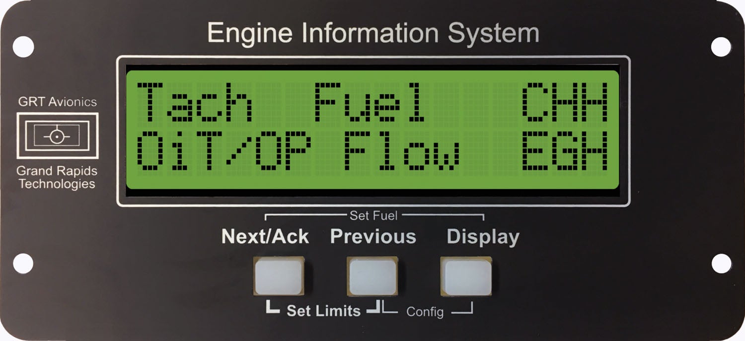

Grand Rapids EIS
EIS Page 1 labels
The Grand Rapids EIS is a good stepping stone because it can stand alone or interface with the company’s EFIS units.
First, the Grand Rapids EIS. Think utilitarian. This system has been around since the 1990s and it shows, with its 32-character LCD display. Still, we like that it can remain in a Grand Rapids EFIS install as a secondary display. The EIS line includes the model 2000, 4000, 6000 and 9000 EIS (nomenclature corresponding to the number of cylinders), and each has five pages of scrollable data on a rectangular control head, which measures 5.9 inches wide, 2.8 inches tall and roughly 3.0 inches deep with electrical connector. The system has both engine data storage and download capability. The EIS can work well, even as a standalone fuel computer, when connecting a fuel flow transducer. The basic M4000 package for a four-cylinder Lycoming is $1295 and includes wiring harnesses, bayonet-style CHT probes and adapters, EGT probes, oil pressure sensor and oil temp sensor. For $1881 you get fuel flow and fuel pressure sensors, plus manifold pressure, while a remote EIS for EFIS connection is $1774.

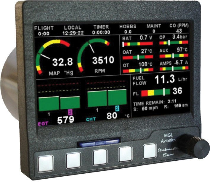

MGL Xtreme EMS
MGL XTreme EMS standalone
MGL’s Xtreme EMS has a logical feature set and decent display.
MGL’s Xtreme EMS is made to fit a 3-1/8-inch instrument cutout and has a 4.3-inch high-res color TFT LCD display. Installation is straightforward with a single D15 input connector on the rear chassis, and the system has provisions for a GPS input (for fuel endurance calculations).
The control set is focused around a rotary control knob and five bezel buttons, and the left- and right-most soft keys are used to cycle through the EMS pages. There’s a dedicated menu for adjusting the display backlighting on the fly, and it’s controlled with the rotary knob. Pretty simple.
