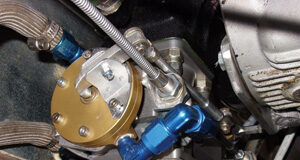

Are the fuel and oil hoses clean or new? Don’t assume that the hoses you bought for the installation are sterile clean. Make sure by inspecting and flushing. Is the oil cooler spinster-Aunt-Betsy spotless? Grit as fine as a grain of sand can cause serious problems, so flush components until they’re sparkling. Field-flushing oil coolers isn’t as effective as sending them to an overhaul facility to be flushed.
