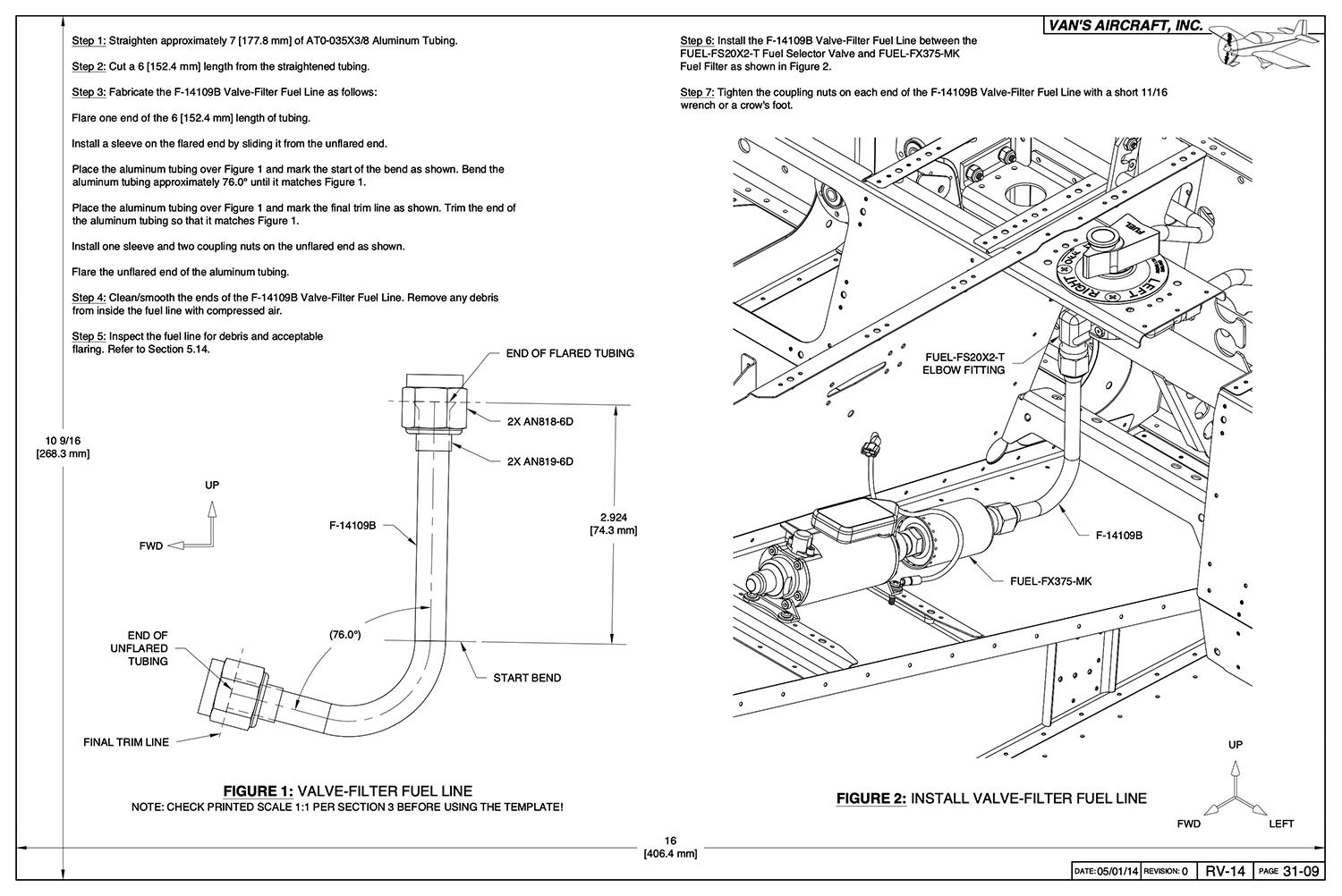

For this month’s cover story on the updated Van’s RV-14A, I not only got to spend a couple of days flying and photographing the new ship but, thanks to Greg Hughes, Van’s marketing manager, gained access to the latest set of builder manuals for the 14. Whenever possible, we try to get our hands on the latest manuals for airplanes new to us, or designs we haven’t been in front of for some time. It’s one thing to touch and fly the completed hardware but something else again to have a closer look at how this project appears to builders from the start.
vans rv 14 plans
Just an example of the plans/drawings for the Van’s RV-14. Every system and every piece is documented, with part numbers, dimensions and myriad other directions to make sure the builder doesn’t get lost.
There is, as you can imagine, still great disparity in the quality and content of build manuals, but there’s also been a significant shift in the nature of these manuals for newer aircraft. I can relate. The manual set for my Pulsar, back in the mid-1990s, consisted of three spiral-bound booklets, maybe 60 pages each. There was another addendum that was being written as I worked pertaining to the Rotax 912 installation, and another for the then-new composite wings. (A lot of the old manual described how to get the previous wood wing skins ready for forming into the ribs, including a description of how to use your bathroom shower…) I learned a lot by doing and by talking to the guys at the factory. It seemed like I called them every week.
Wiring? Avionics? Interior? Nope, none of that was covered. With the early Pulsar XP, there was a lot the builder had to figure out individually. Looking over the current plans and direction for the RV-14A, I was taken aback by a couple of things. First, the completeness and detail are impressive. A clear step up from the already good RV-10 plans I’ve pawed through and, arguably, better than the updated manuals I used with the Sportsman in the mid-2000s.
The second thing that impressed me was the amount of physical work the factory’s done. Where there are still many raw pieces of fabrication to be done in modern kits—hewing a part from raw stock, for example—it’s clear the RV-14 comes with so many parts already stamped to near-final shape and punched. Sure, you have to separate conjoined parts that had been CNC-cut at the factory, and you get the joy of dimpling or countersinking lots of holes, but the RV-14 comes pre-punched at final size, eliminating the need for assembly, through-drilling to final size, disassembly for deburring and all the remaining steps.
What’s more, the RV-14 can use a factory-spec wiring harness for “drop-in” installation. We tried that with my Sportsman and got most of the way there, but not as far as the RV-14 goes. We all complain when airplane kits get more expensive, but after looking into the -14 to some depth, I have to conclude that the cost of your time saved (and potential problems avoided) is pennies on the dollar.
