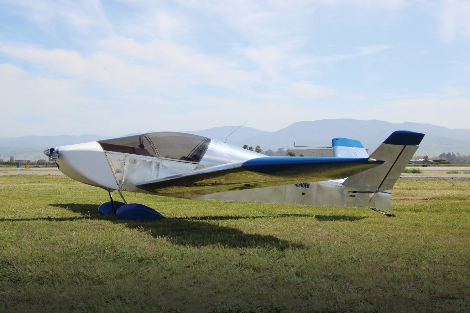

Well folks, the time is here. Let’s have a look at the electric Xenos, a motorglider than can carry two full-size adults and stay aloft for over an hour—more if you can find great lift!
There have been quite a few electric-powered ultralights that have flown, and credit goes to their designers and builders. However, in the E/A-B category, electric planes have occasionally been announced, flown a couple of times and then gone silent. Problems with excess weight, insufficient batteries or limited endurance have gotten them all. But the eXenos is different—mostly because it is a motorglider that requires a lot less power to just go have fun.
In my experience with gliders, there are two kinds: those that are designed for competition and efficiency and can be flown long distances for hours at a time, and those that are lower performance and can tire you out after an hour or two of hunting for thermals. The Xenos airframe will never be mistaken for a high-performance sailplane, so it belongs to that second group. And in fact, if you’re not going out to fly sailplanes every weekend, but just enjoy hunting a thermal now and again, you probably belong to that second group as well.
If I look at my quite limited glider logbook, most flights have been fairly short. Even those in motorgliders have been limited in duration, mostly because we were just going up to have some fun. So a flight duration between one and two hours is quite reasonable. After that, I figure I am ready to get back on the ground for a rest and review of what I am doing right and what I am doing wrong. When I reach the point that I want to fly longer in a glider, I am going to be looking at stepping up to one of those high-performance ships—with or without a motor.
So lets take a look at what makes the eXenos so special and how it is to fly!

The Xenos (gas or electric) sits wide on the ramp. Make sure you know where your wingtips are as you taxi.

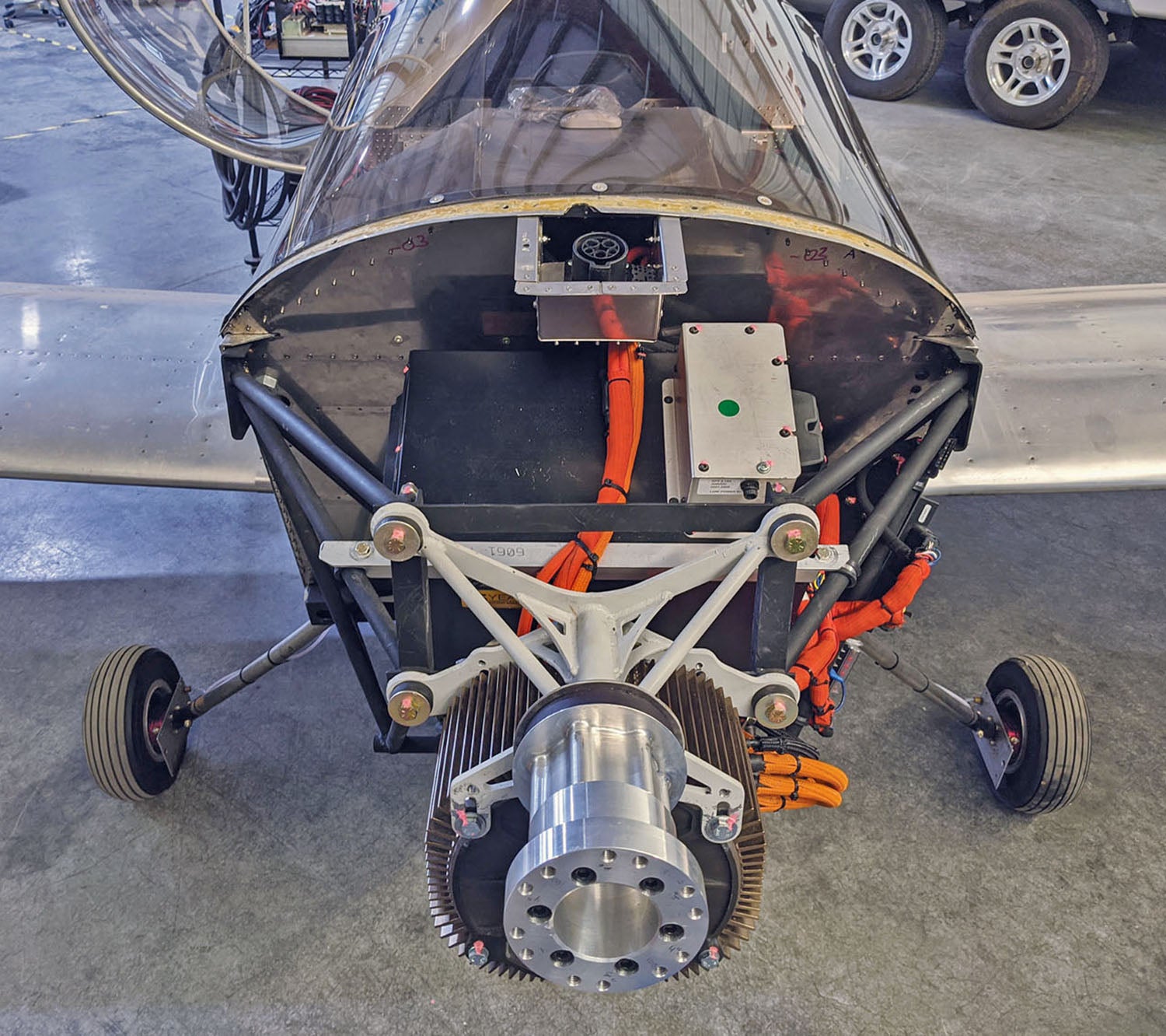

The basic power package is mounted to a custom engine mount that Gabriel designed and had built. It incorporates the firewall end of the mount supplied by Sonex to retain the landing gear leg sockets and then consists of welded tubing to support the battery and motor. It could be argued that since the battery is the significantly weighty part of the power package, it is really a battery mount that also holds the relatively tiny motor and reduction drive in place. The reduction drive is a simple spindle with a pulley to mate with the cogged belt coming from the motor pulley, as well as a prop hub to which you can bolt the prop. Gabriel is using a Prince prop that came with the Xenos airframe from the original builder. There is nothing custom about it for the electric power in this configuration.
sonex e
The re-drive unit consists of the white powder-coated structure, the hub, belt, pulleys and motor mount. The finned motor comes straight out of the motorcycle.
The entire power package weighs in at about 250 pounds, according to Gabriel, and replaces the standard motor and fuel system. With the battery hanging forward of the firewall and the fuel tank removed, the weight and balance comes out very close to a standard Xenos—a major consideration for anyone building with an alternative powerplant. The battery accounts for about 180 pounds of that weight, with the rest being in the monitor, controller and wiring. There are some pretty large wires to conduct that much power around, but they are short. The batteries are 102-volt lithium-ion, the same as used in the motorcycles. And despite the odd rumors we have all heard, there are no reputable reports of Zero motorcycles going up in flames.

The complete firewall-forward package for the eXenos including the reduction drive motor, battery and controller.

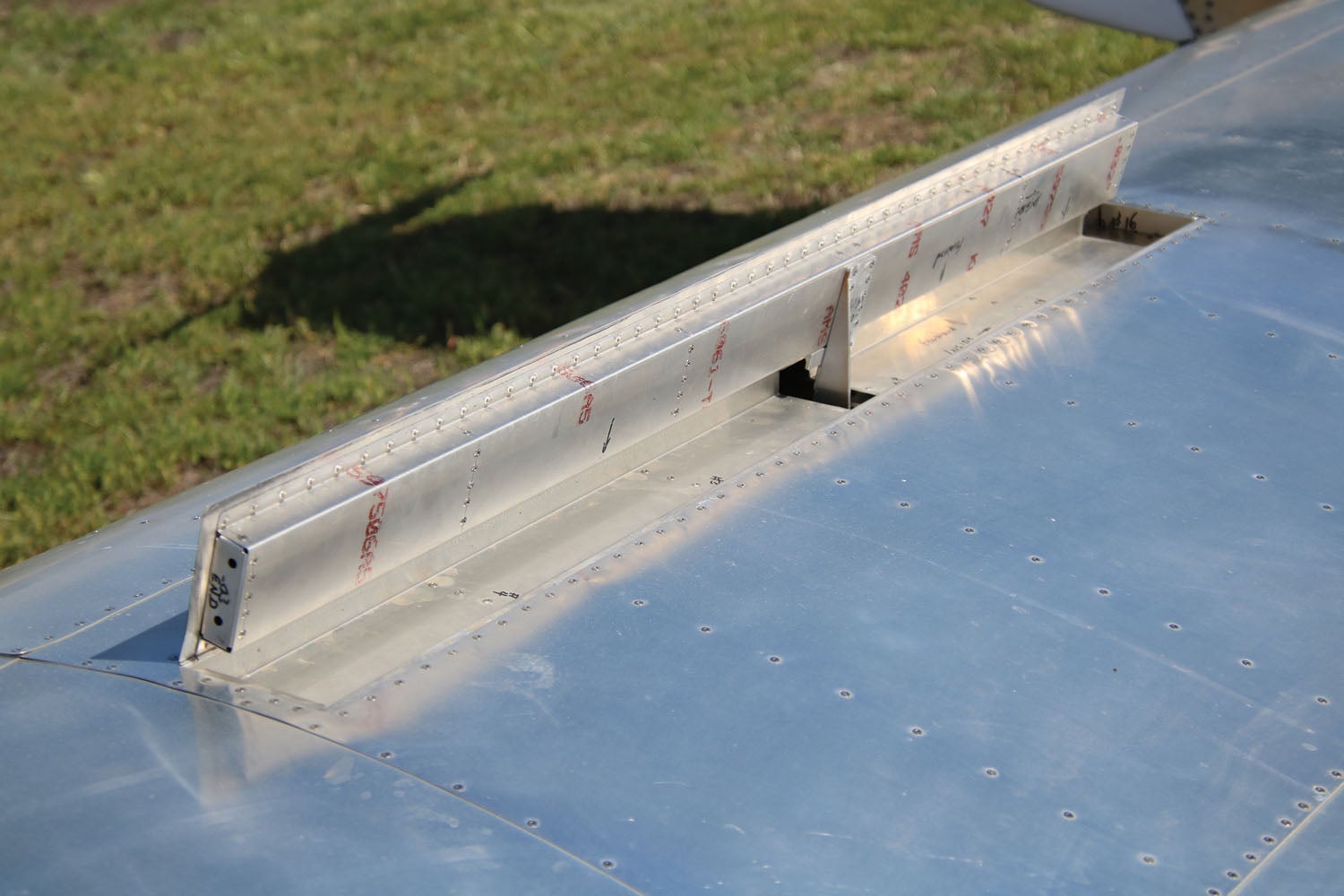

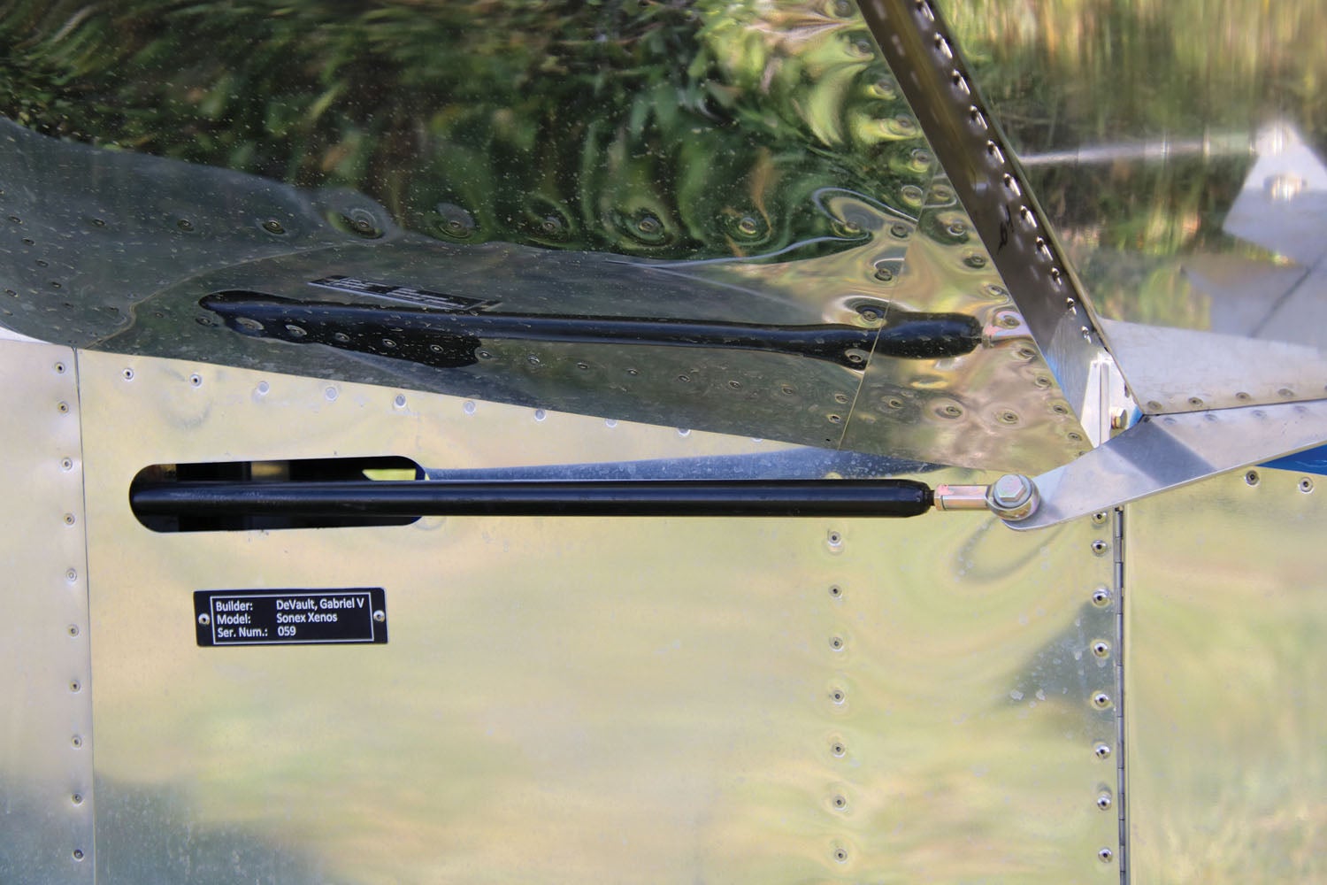

Spoilers help with precise glide path control and getting those long wings to stop lifting for landing.
In addition to the throttle handle on the left side of the cockpit, there’s a spoiler handle—familiar to glider pilots, maybe a little more mysterious to power-only pilots. Spoilers are not speed brakes; they simple spoil lift and don’t add much drag. There are no flaps on the airplane, but if you find yourself high and need to come down, pop the spoilers and you’ll generate lots of sink without causing a loss of speed.

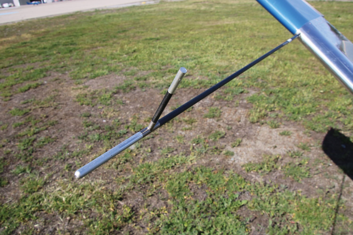

The Total Energy Probe allows very accurate sensing of lift or sink. It gets removed after every flight because it is delicate and easy to bump into.
