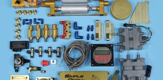

injector
Running a little rough? Sure, it could be a clogged injector— but don’t forget to think of other potential causes because the first answer is almost always wrong. (Photo: Paul Dye)
So what was the problem? My thoughts immediately turned to that which I have the least experience with: the fuel injection. Hmm…500+ hours without any maintenance; I bet I have some crud in an injector! Sure, that must be it. Finally, a chance to play with injectors! I opened up the maintenance book, got out the tools, and spent an enjoyable couple of hours removing and cleaning the precise little injectors. It gave me an excuse to buy a sonic cleaner—how can you beat that! With everything reassembled and the airplane buttoned back up, I took it back into the air to find…exactly the same behavior. Rats, that wasn’t it.
