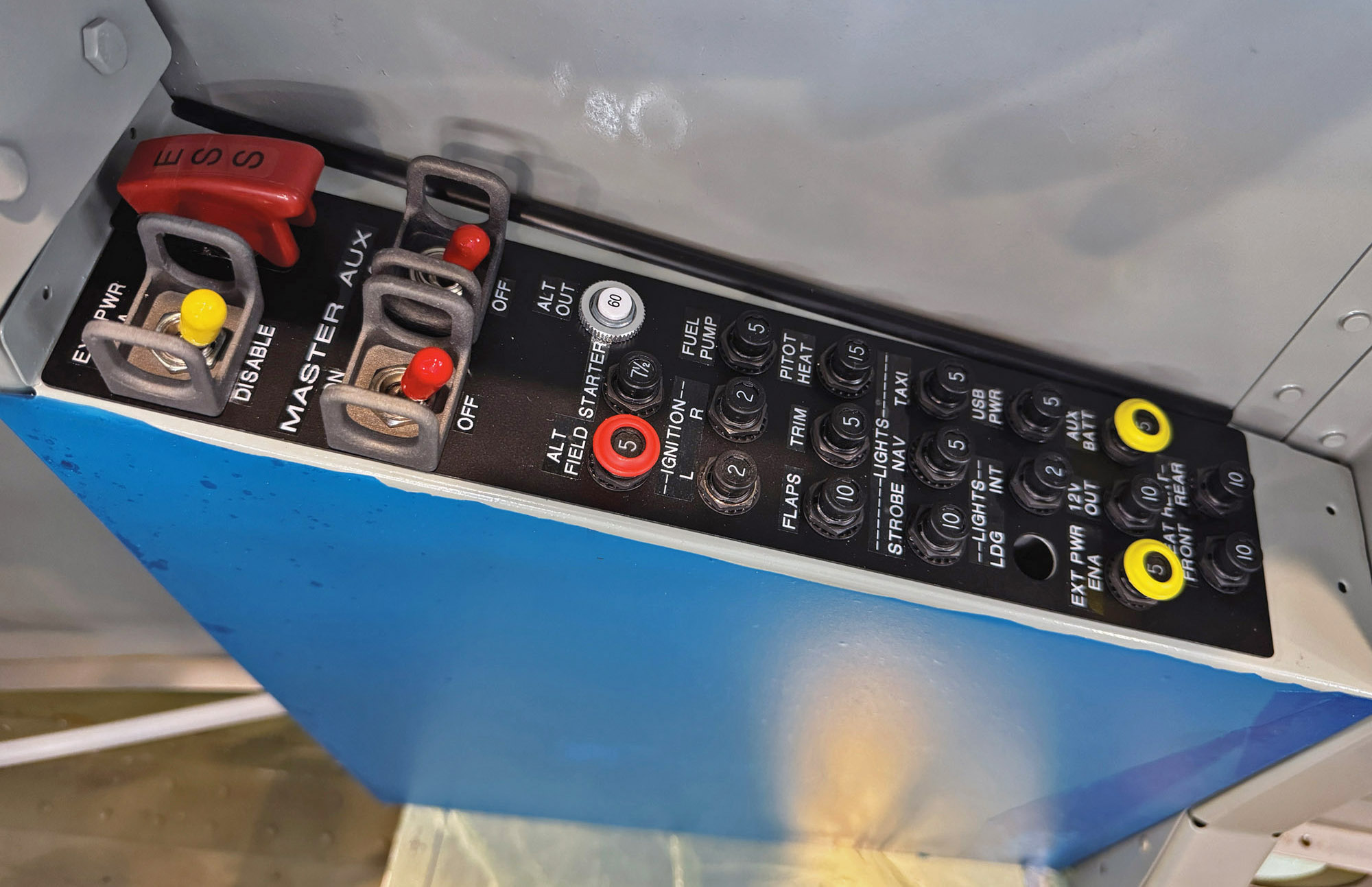

This is the first iteration of the “power panel” that has electrical controls and circuit breakers on the top. Nothing on the side—yet.

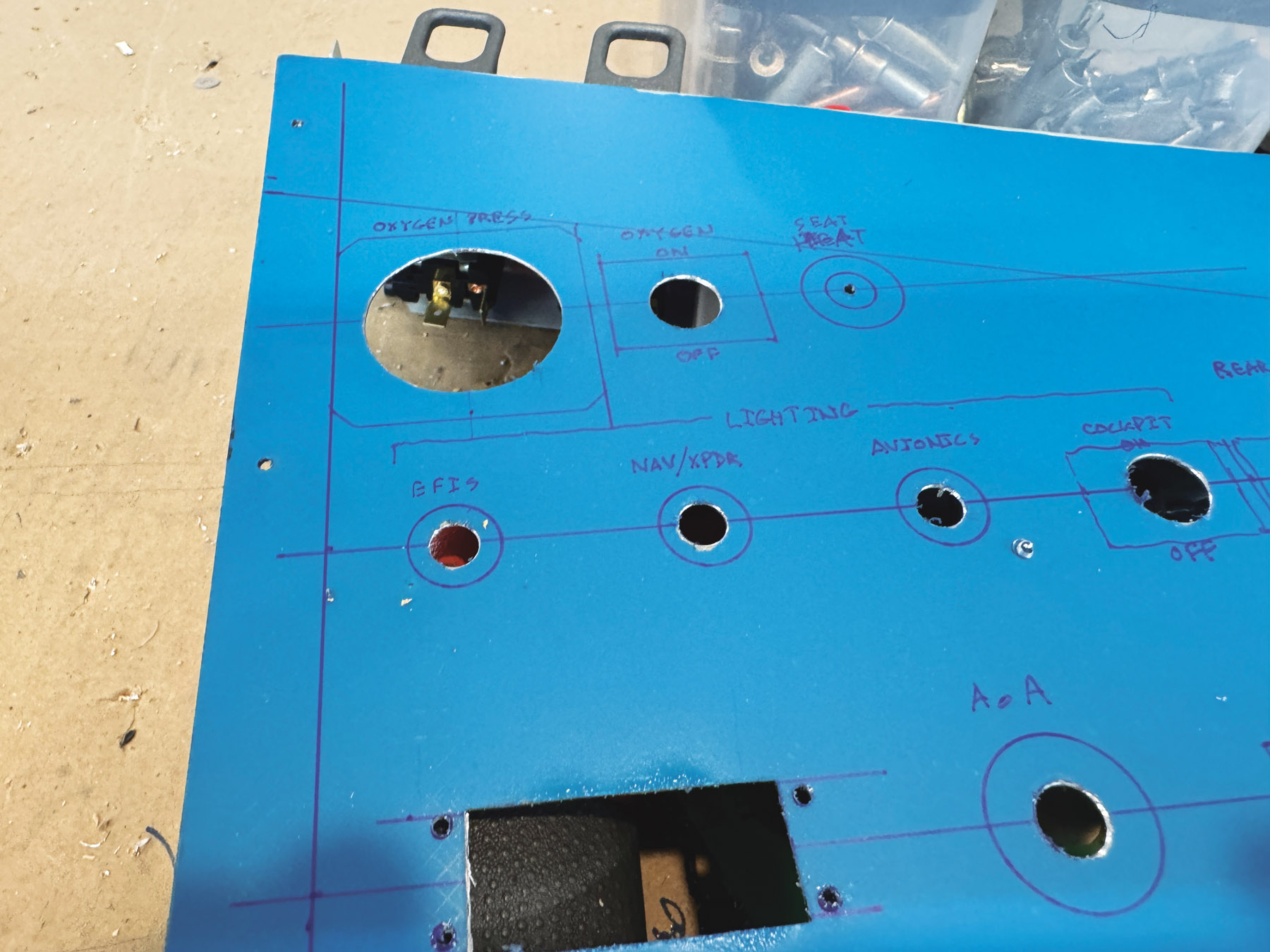

Evolution brings change! Mocking up the new layout that has additions for control of the oxygen system, lighting, ELT and a few other things.

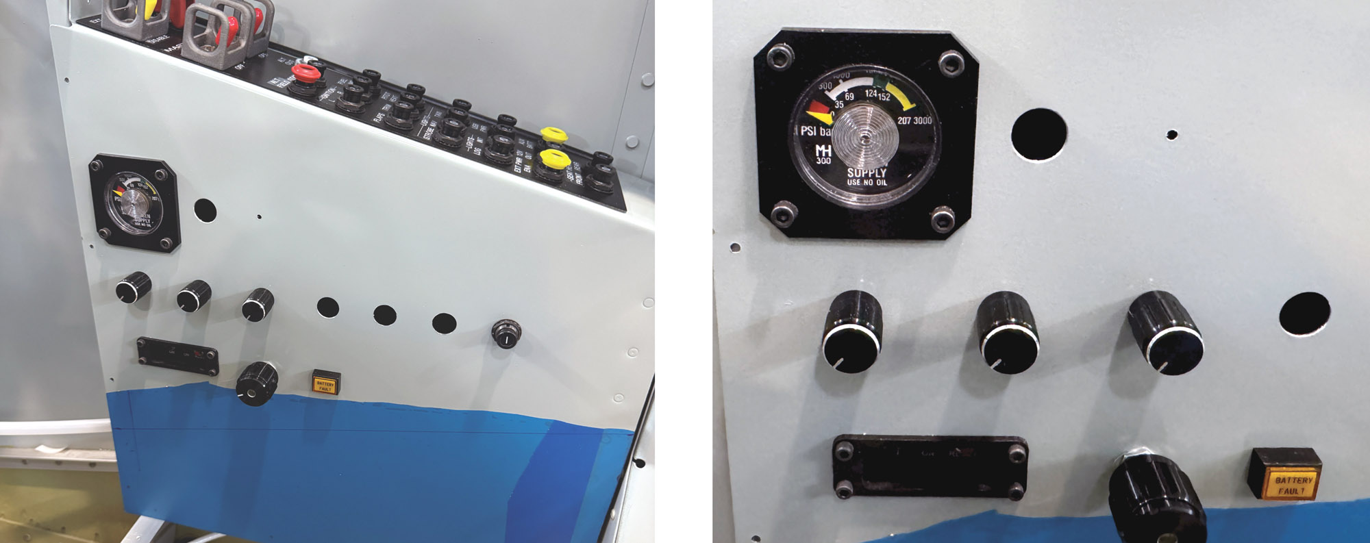

Once populated it’s clear to see there is more blank space under the added rows for future additions. Labeling is next (left). The tiny hole is for a “yet to be defined” seat heater switch. Because you just never know what you’ll think of next (right).
This is why I personally don’t have panels cut, powder coated and silk-screened for my projects. I know that as the project evolves, there will be things I need to add. If you have a perfectly finished panel from one of my many friends in the panel-building business, it is hard to modify them as you go.
If you don’t want to disturb the effect of a perfectly finished panel (very much like your luxury car), you are stuck with your original ideas. But if you cut your own, paint your own and label it yourself—you always have the tools and skills to make changes that don’t look like changes!

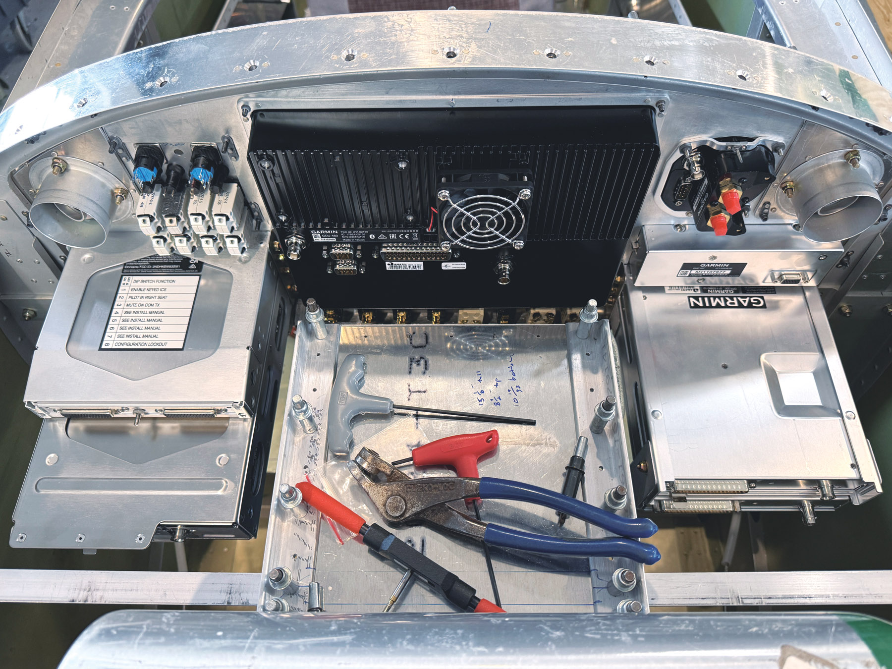

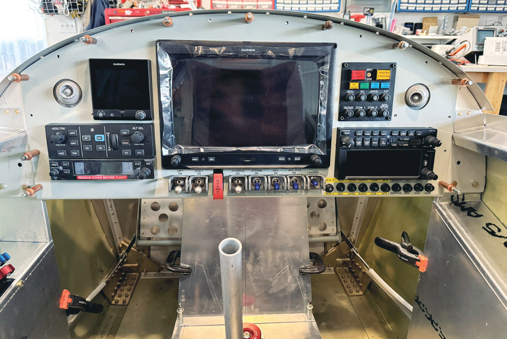

I’ll talk more about the avionics choices in the sidebar “The Avionics Suite,” but for now, let’s just say that the panel complement was fixed early on and I am very happy with the choices. The layout came naturally—I like symmetry and the boxes lent themselves to that. Originally, I had planned to have no switches on the panel—all of them would be relegated to the side panels as we did on our RV-3. I also wanted only two power wires—main and aux buses—running into the panel. That meant that all the circuit protection for the panel-mounted boxes would have to be on the panel. So that introduced some breakers.
Since I wanted to build an annunciator panel to visually balance the Garmin G5 backup EFIS, I had a natural place to add the breakers for the panel-mounted avionics—and I thought everything was simple. But it wasn’t! I also wanted some critical equipment to be powered by both buses, and that meant more breakers. OK—a row of breakers under the right-side avionics boxes would do.
But then my plans to put the magneto switches over on the left-side panel with the engine levers was sunk in a real-estate fight. Sure, I had room for the fuel pump switch there, but not much more. Time to rethink. How about some switches under the EFIS that get used all the time? Mags, start, avionics master and some lights? I could leave the electrical power management over on the right-side panel as originally planned. As such, the cockpit flow was going to be very nice.
I hadn’t even cut any metal yet and things were evolving!
The switches ended up under the EFIS and any breakers related to the panel or critical functions found homes there as well. With this design, I cut metal, painted and labeled. And all was right, good and happy—I liked the layout and the flow was excellent.

But along came change. The built-in oxygen system has the bottle ahead of the panel, up against the firewall, and I had the valve/regulator on the port side. But when I got the rig in hand, it was longer than I expected and the bottle had to shift right. That real estate was taken by the GEA 24 (the Garmin engine monitor box). But if I flipped the bottle, there was room for the GEA on the port side (because of the difference between the avionics stacks on each side) and all the components were happy once again.
Now the O2 gauge and controls needed to be on the right instead of the left (to facilitate short high-pressure O2 plumbing—always a good thing!). So, bingo—the electrical panel needed space for those. And since I had decided to add a GAD 27 to control flaps, trim and lighting, I now needed a place for panel dimmers. Oh and there is that pesky ELT control panel, a knob for the FlyONSPEED AoA that I was going to add for further testing and then there was the seat heat switch and a switch to disable the trim and flap switches in the back seat when I have non-pilot passengers.

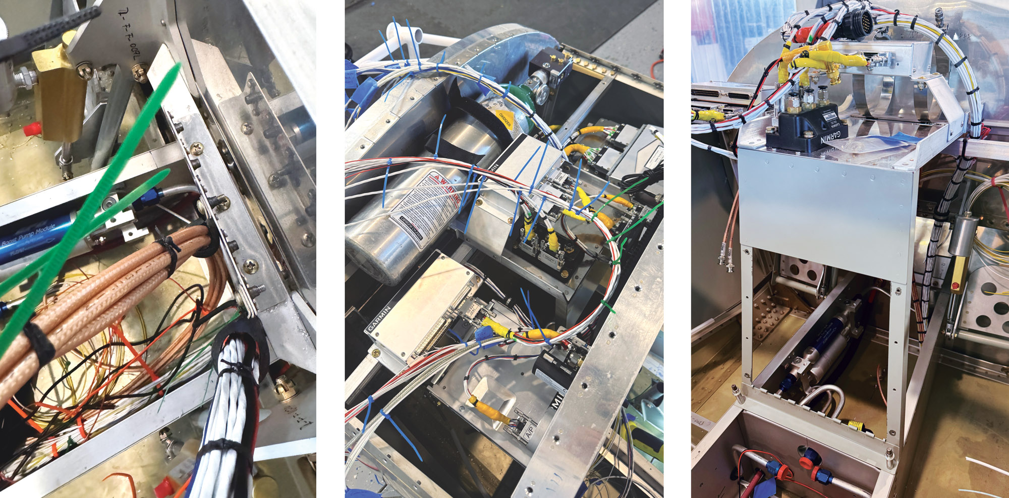

Wire bundles leaving the panel have to be restrained to the firewall (left), here with Adel clamps tied to a “nut plate strip” for easy changes later. The oxygen bottle (center) was originally pointed the other way but the design changed due to space considerations. The fuselage harness—with the panel removed—undergoing lacing (right). Don’t forget to leave extra wires for future expansion.

Now of course, at some point, you are going to lock things down—but if you wire and lay things out early in order to work when the fuselage is wide open, you are inevitably going to make some changes along the way. But be smart about them and plan to leave some blank panel space somewhere (probably not on your “work of art” panel, but on sides, center console or overhead (if you have one). And more importantly, when you run wire bundles, include some “spare” conductors for future use. This way, when you add that powered CO detector, you have a power wire already run for it—you didn’t just know that was what it was for! Likewise, include some shielded twisted pairs—you’ll eventually add some avionics box that needs them.
We “scar” spacecraft with extra wires all the time because it beats breaking into wiring bundles later. It’s smart to have space for expansion of a CAN bus or maybe putting some extra aux wires into your audio panel so that you don’t have to break into the connector when adding some new bauble that makes sound when you expand your electronics later. It might be painful to add things like this now when you really want to be done with wiring. But believe me, adding wires into a finished airplane later is far, far worse.
