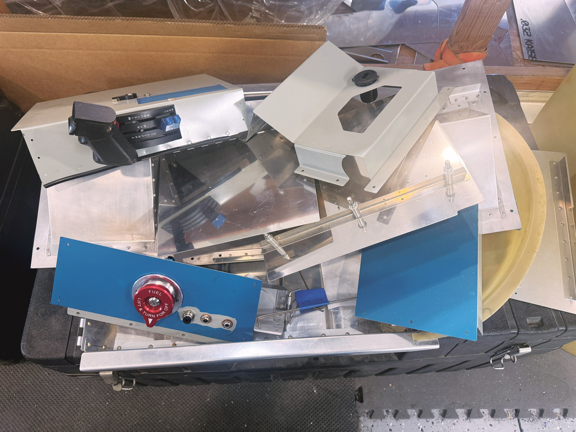

Once the floor panels were built, they all came out for painting the interior of the fuselage. Parts in, parts out.

All of these interior components were built and fitted and then removed for painting.

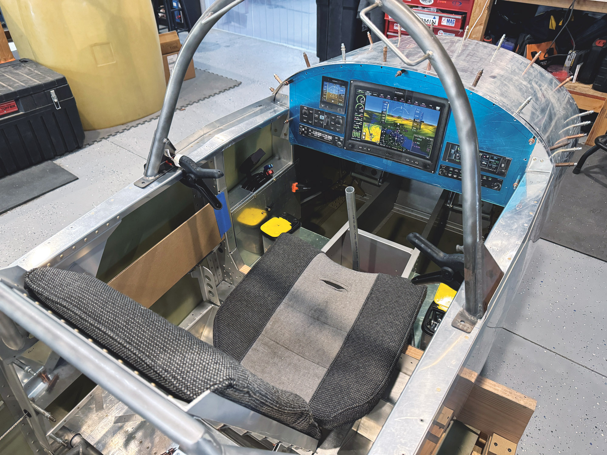

Seat cushions from the author’s RV-8 served as a stand-in while fitting the interior.
So the cockpit took shape. Eventually I had a reasonable design—which all had to come out to start running wires. I’m not exactly known for simple, Cub-like electrical systems and avionics, so I have endless wires to add. Trust me on this: It’s a lot easier to wire when the “canoe” is more open and sitting on the floor (or on a rotisserie).
The thing is, to run many of the wires, the floor has to come out. And that means I can’t sit in it until the floor goes back in. The floor is several pieces, and since the structural component that holds the rear of the control column in place sits on top of the floor, the sticks have to be unbolted when the floor comes out. So instead of a cockpit that you can sit in and make airplane noises, you go back to having essentially the same quickbuild fuselage that came off the truck. Months of work disappears onto storage shelves.

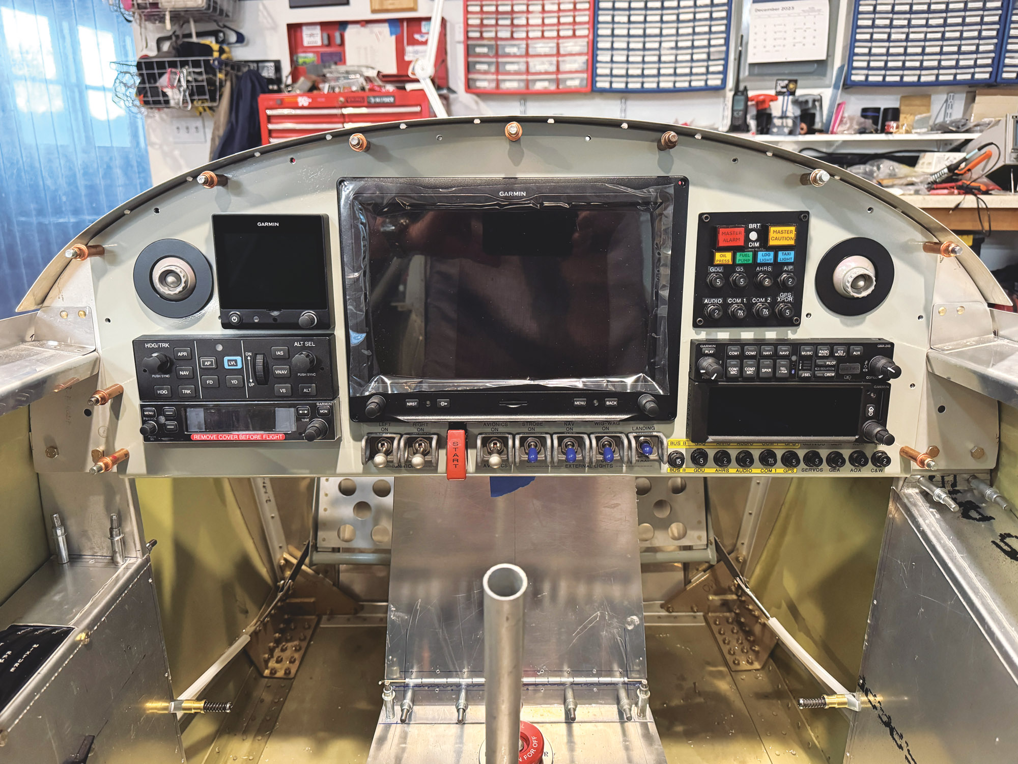

The instrument panel and center console are structurally complete and now they will be removed and taken to the workbench for wiring.
I honestly find myself stalking around the project for an entire work session (or two or three) looking for little things to do instead of taking all that stuff out. It’s just hard to go backward. But eventually I come to grips with it and pull out the Cleco pliers and ⅜-inch wrenches and start pulling the floors. All the time I keep thinking “I just want something to be finished.”
