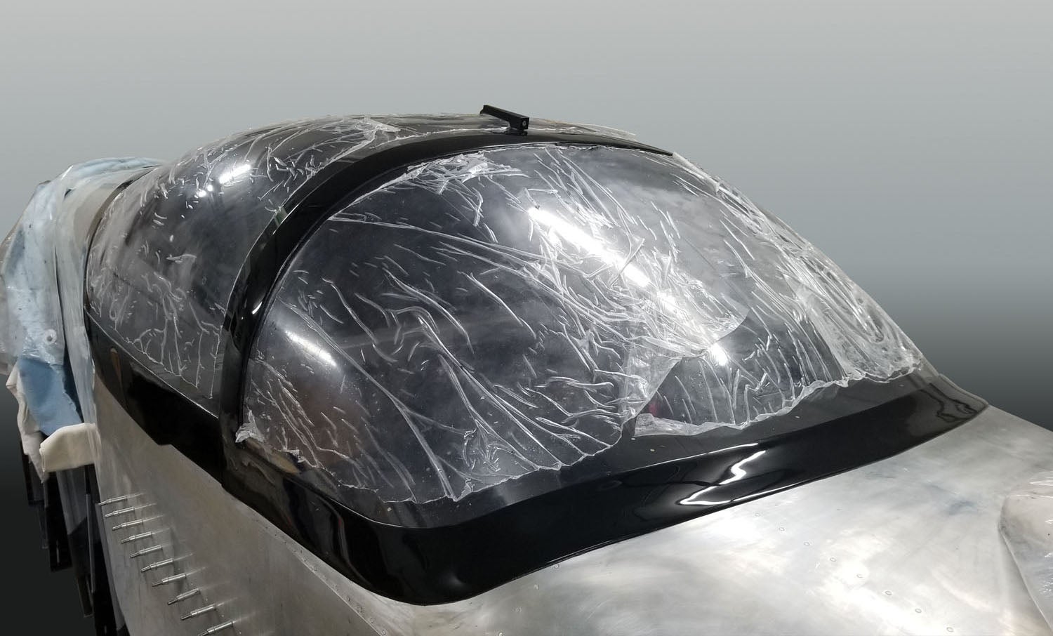

easy slider pt3 03
The canopy skirt and windshield fairing painted with Kirker Ultra-Glo Ultimate Jet Black. They look pretty good, but there’s still a lot of work to do before they’re completely finished.
