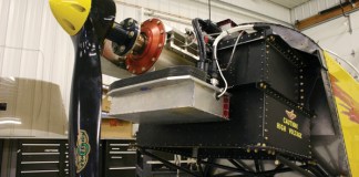

A few different options were considered for the propulsion system. The team looked at everything from large drone motors to electrically powered paraglider motors to the Zero electric motorcycle system. The team ultimately decided on the same MGM Compro REX 30 motor/controller combination that Brian had intended to use but never made it to testing.
According to Mariko, who acted as spokesperson for the group, “After some research we decided to go with this propulsion system as similar MGM Compro systems were successfully installed on other aircraft with proven results. We expect that the motor will deliver a maximum of 20 kW for short durations (takeoff and climb-out) and 10 to 12 kW for continuous operation, which should be able to sustain level flight. Our major concern at the moment is that we are able to sustain this continuous output without the motor overheating as it only relies on air cooling provided by the passing slipstream.”
Brian had tested several motors, including a Plettenberg originally intended for large model aircraft. That was sufficient to enable sustained flight, but not self-launching.
Most surprisingly, the team not only installed the MGM Compro REX 30 motor and controller, but designed, programmed and tested the flight instruments, motor, controller and battery instrumentation. This takes the ‘Iolani project beyond many other efforts.
“Our display panel is a thin aluminum piece similar to the EMG-6’s,” Mariko explained. “The big difference between our designs is that the E-Hawk has no windshield, meaning that the panel is not constrained to a semicircular shape. We water-jetted [a sign of how well equipped their shop is] our panel from scratch at school, and we used a somewhat organic shape to neatly fit in all of our instruments. Another difference is the instruments themselves; we use flat TFTs [thin film transistors] to display information to the pilot whereas the EMG-6 prototype uses deeper, cylindrical instruments.”
The students attached their electronics cover and panel to the fuselage, “But the shroud and cover piece are screwed on using embedded nuts that rest inside the front cover,” said Mariko. “As for the electronics, we did some research into existing designs for electric aircraft displays and listed parameters that we would have available from the motor controller/external instruments before coming up with digital layouts that would be used on the main electrical systems display (ESD) and side displays (altimeter and airspeed indicator).”
