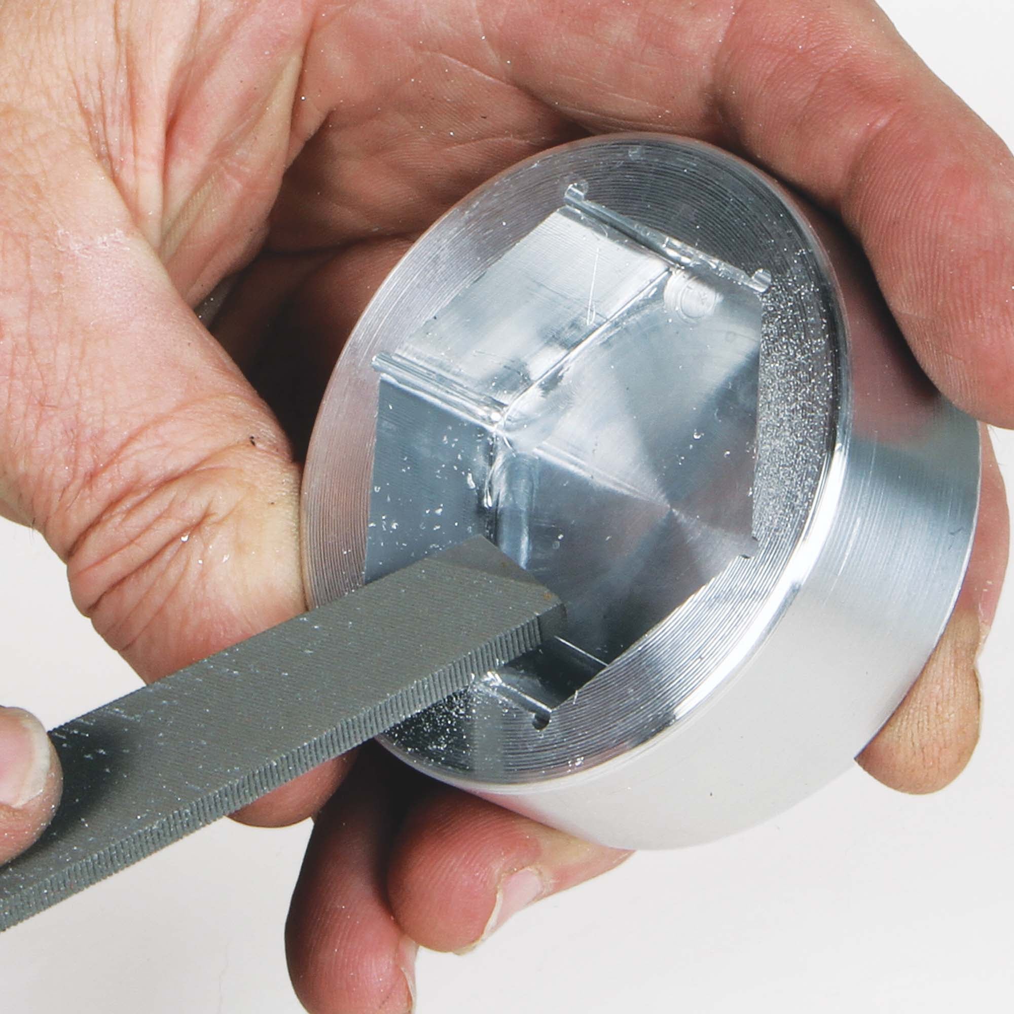

drive socket 01
The final operation was to remove the burrs and round over the edges of the socket flats with a hand file.
With suitable material in hand, how to make the socket cavity more or less popped into my head. By milling a ¾-inch hex protrusion on the drive end, I could use that for indexing the hex socket. Super simple, super easy. One minor problem: My blank wasn’t long enough to make a suitable length stem to use the 5C indexer to mill the designed hex. A couple of quick measurements confirmed that I didn’t need to make a protruding stem! The inside circle of the socket hex (1⅞, same as the distance across the flats) was big enough to fit over the nose of the indexer (refer to the photos). I designed a suitable clamping stem to be made during the preliminary socket cavity excavation (see drawing). The stem would be turned away after milling the hex.
